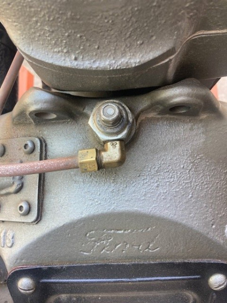

You should be able to fit the 26/27 trans in your 3 dip pan & use the 23 hogs head, you just can't use the wide band as it will not be centered
on the drum & you can't use the 26/27 hogs head because the ears collide with the back of the block. Scott is correct everything is turning

Are you sure about that? I have an early (generator) not 26/27 block with a 26/27 hoggshead and early transmission here. The ears on the hoggshead clear the block. The brake band is not centered on the drum as expected. Also the 4 dip pans have a bulge to accommodate the larger drum/band. It may clear in a 3 dip without the band over the entire drum, not sure what the clearance would be.Craig Leach wrote: ↑Wed Aug 06, 2025 8:25 pmHi John,
on the drum & you can't use the 26/27 hogs head because the ears collide with the back of the block.....

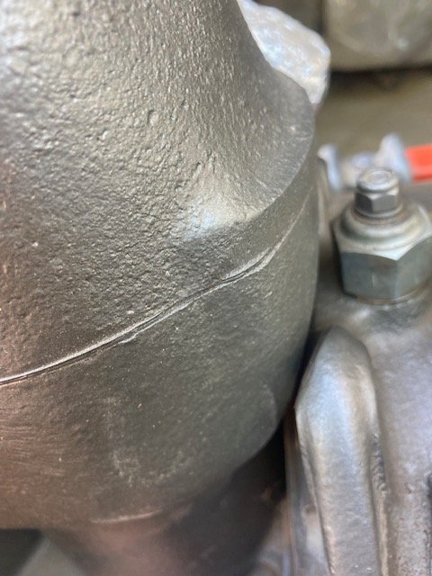

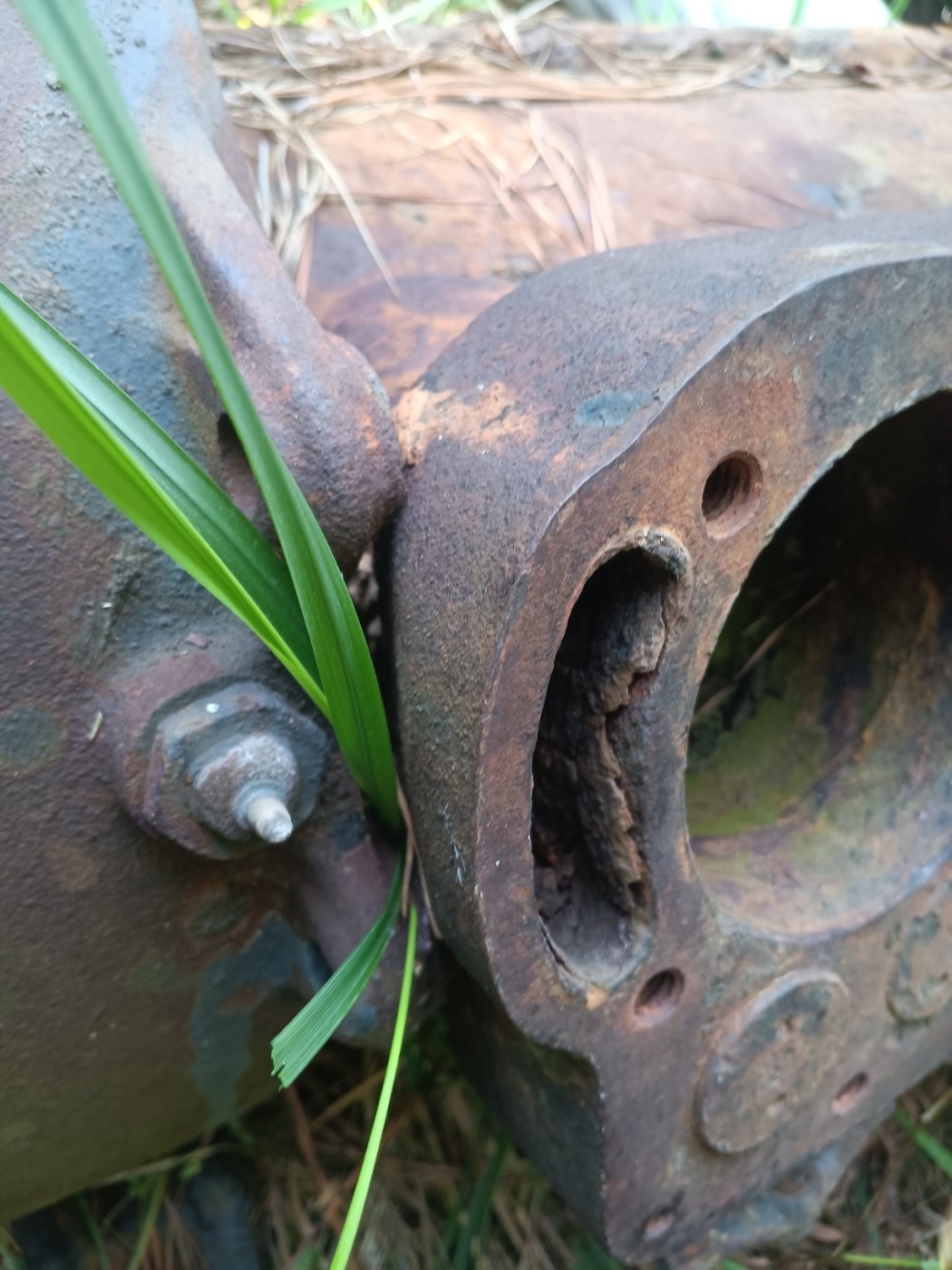

My experience has been that the bulge in the back of the earlier block collides with the ears on the 26/27 hogshead. I just barrowed a 27 block
to mock up a speedster ( the engine going in it will have a 26/27 hogshead on a early block with the ears cut down) so I want the pedals to fit.
My recollection is the wide brake will fit in a 3 dip pan but the wide band will not & it might be good to cut 3/16 off the end of the wide drum
to do it. Gregg, All previous branches of the diagnostic tree would be good info in the first post.

Early blocks are square on the back of block. Later blocks have a sloping rear. Easier to remove HH. No sure of change date.

The lug ears on the 26-7 hogshead in Craig's post have been modified to allow it to fit. Normally the block side of the ears is flat against a flat land on the 26-7 block.
