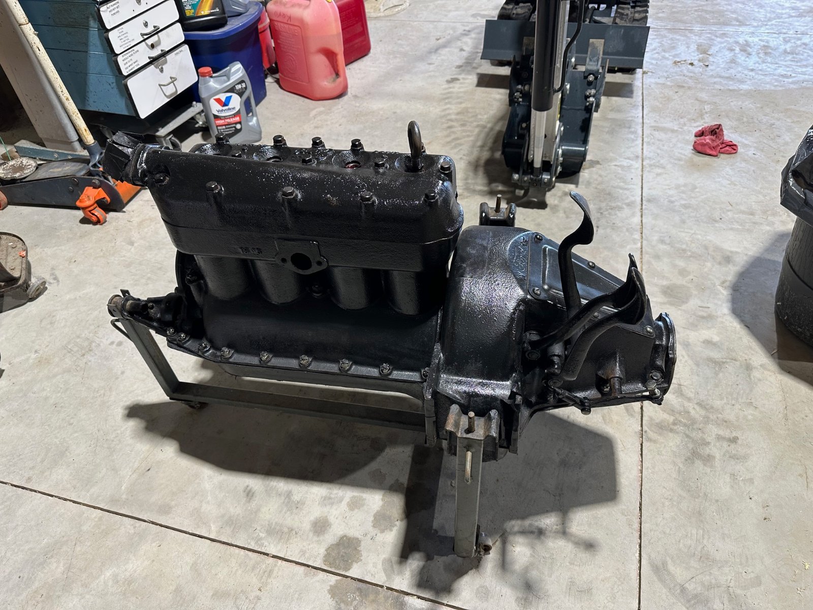

Hi Folks
I recently purchased a rebuilt 24 engine (July 24 according to the SN) and want to install it in my 1926 Roadster. What issues will I run into if any? I see the pedals are different and I’m not sure if the hog’s head are interchangeable. I have read that some of them are not and just want to see if this combination is or if it will even fit into the car correctly. If there are any complications or things that will need changed, I would appreciate the heads up before tearing into it.
Thank you
Thank you

Quick answer is lots of issues if you only have a 24 complete block with 24 transmission, and no hogshead.
Your 26 would have the wide transmission brake drum, that uses the late 26-27 hogshead with the wide space pedals. And your floor boards are made for those wide pedals. Your 26 has the water outlet fan bracket, unique to 26-27. Your 26 will have the 4 dip pan.
Using a 26-27 hogshead on early block and transmission will affect the brake band operation.
The pre-26 have a 2 1/2" center to center pedal spacing for the narrow brake drum.
3" center to center on 26-27 wide drum hogshead to operate the wide brake band.

If your 26 has an original motor and transmission and just needs to be replaced for some reason, my suggestion would be to use just the rebuilt 24 short block using the 26 transmission, oil pan, and head with water outlet (or at least the outlet). That way, it is a drop in replacement and there's no trouble spots. My grandfather did this on his 27 coupe, back in the day, except he went a step further; he used only a 22 bare block from a salvage yard and used the 27 crank, rods, pistons, oil pan, and transmission. He did use the 22 head and front timing cover, mounting the fan down lower than the original 27 fans, but it worked. I have since corrected all these modifications.

Howdy Gerald,… If I read your request for advice correctly, I understood you purchased a ‘24 engine, crankcase, tranny and tranny cover…since you didn’t reveal it as simply a ‘short block’. That right? If so, install it and change out the floorboards to fit the earlier pedals.

My apologies I should have been clear with my question. I have a 24 engine and transmission that was rebuilt by Ron's Machine Shop. I was unclear if I could just swap the hogs head but sounds like that's not an option. So I will do the engine transmission swap and change the floor boards. I attached a photo of the engine.

Floor boards will have to be custom made.
Consider changing/swapping the brake & low pedals.
Low pedal is a little bit of work to remove & re-rivet the cam. HH has to come off. Brake is nothing.
Then you still have what still looks like a 26-7 in the cockpit using original floor boards & mat.
Interesting, you have an early needle nose pan. Why??
You will have to use the smaller crank pulley. That will change designed fan speed & require a special size belt..

If I change the pedals will I still need to make new floor boards? I would like it to look correct if possible. Maybe I can find a used set of pedals so I only have to take one hogs head apart. I would like to get the original engine rebuilt at some point.
How difficult will this be to get a belt that will fit? What diameter should the crank pulley be? I am not sure I can measure the one still in the car but can measure the one in the stand.
I appreciate the information. I guess I should have done a little more research before buying this engine. The 26 still runs just lower on one cylinder but fires right up and drives okay but you can feel the low cylinder going up hill.
The guy I bought the engine off of had this engine built for his grandfathers model T that he has so maybe the pan was to fit that car I don't recall what year it was.Interesting, you have an early needle nose pan. Why??

You can always swap out the crankcases - a few hours & gaskets !

Perhaps the engine in your car now only needs a valve job. Much easier than changing the engine and transmission.

If you change the pedals, your current floorboards/mat will not need modification.
You can use a string to determine belt length. Take the dimension to an auto parts store & get the closest length serpentine belt.
They come in different widths. get the widest possible. (about 1") thats an 8L width belt?
They may not have your length belt in an 8L. My 27 runs a 4L (1/2") Run the belt backwards (groves out)
You can also go to a bearing house & get a continuous flat belt to any length & width.
If you have the capability, I would change to the correct pan. (checked for straight) Why waste an early pan on a late T?
A 4 dip pan will make tightening the last rod easier down the road.
If I were doing this, I would retain the wide brake drum, modify the ears on a late HH to fit the early block or stay with a correct late block ideally. The correct "improved" power train is superior to the earlier versions. 4 Dip & HH bolted to the block.
It all goes back to your earlier decision to run this earlier engine. Not the best decision.

The 1926 and '27 engine/transmission featured a much improved brake, and a more rigid connection between the engine and transmission as well as added braces from the engine block to the rear engine mounts, plus the wider pedals and easier transmission band service. The improved, more rigid block and hogshead design make for better and more stable 4th main bearing alignment. I suppose that your late coil box will bolt on to the earlier block and head. Being limited to the smaller, early crank pulley will cause your late style fan to run slower than it was designed to.

Man I thought it would be easier than all this. I guess a few options would be to stick it in and make it work while getting the 26 engine rebuilt or find a 24 to stick it in (always need another car) or build a speedster and stick the engine in that and drive the speedster while the 26 is down. I have wanted a speedster for awhile. Might be cheaper just to buy a car already restored and be happy.

I think I will pull the head and have another look at that valves, Drop the pan and have a look at the crank and check the clearance. It does not smoke but does leak oil. I want to check the rear differential to make sure the washers have been changed, Retirement is on the horizon and the garage will be insulated and heated before winter. This will make a great winter project. Will keep an eye open for a Model T to install the rebuilt engine in.
Charlie B in N.J.
- Posts: 786
- First Name: CHARLIE
- Last Name: BRANCA
- Location: Brick N.J.
- Board Member Since: 2010
Re: Engine swap 24 engine 26 roadster
Well B it looks like you're finally on the right track. Too bad about the $ outlay and the fact that you didn't check here first. I've been here a number of times howling about how informative a wet/dry compression test can be but man it's a tough sell.
- Posts: 8641
Most Model Ts leak more or less oil. One sure way to get one to leak excessively is to put too much oil in the engine. There are a number of inexpensive things that can be done to minimize oil leakage. Often, just snugging up oil pan and valve cover bolts will reduce oil leakage. Most Model Ts can benefit from a "general tightening", which consists of going over the entire car, including body and fender bolts, and tightening any loose bolts, screws, etc. (Only tighten radiator mounting studs as directed in the manual!) Everything that moves on a Model T needs some oil from time to time. If your car has rust on the springs, they need attention.
