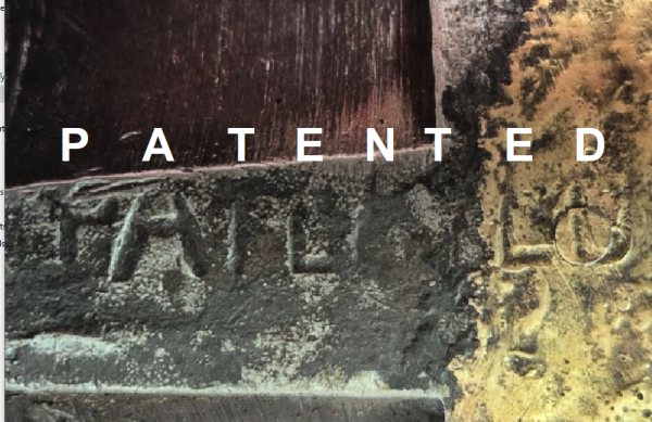

Post by Daisy Mae » Sat Aug 09, 2025 11:43 am
I don't recognize nor can fully make out the stamping on the torque tube flange..... anyone?

Post by JTT3 » Sat Aug 09, 2025 11:48 am
Patented? Maybe?

Post by TXGOAT2 » Sat Aug 09, 2025 12:22 pm
I'll second "PATENTED"...

Post by ModelTWoods » Sat Aug 09, 2025 12:36 pm
Whatever it is; the tube has been brazed, either to seal a leak or join two pieces from different tubes.

Post by TRDxB2 » Sat Aug 09, 2025 1:14 pm
I'll tertiary it "PATENTED"

Post by speedytinc » Sat Aug 09, 2025 2:18 pm
Since there dont appear to be rivets, which would have been brazed also, must been brazed only. I wouldnt assume it was repaired.
I have seen these early DS tubes cracked @ this joint.

Post by Original Smith » Sat Aug 09, 2025 2:32 pm
Looks very authentic to me.

Post by Daisy Mae » Sat Aug 09, 2025 5:59 pm
It's an early 2 piece tube
Interesting as to why it would have been stamped Patented.
Thanks...it's obvious now.... Doh!

Post by A Whiteman » Mon Aug 11, 2025 3:49 pm
The stamping goes over the brazing. My 'guess' here is someone with humour did the fix and said 'I will patent that repair :lol: )!
