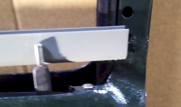

I'm installing the glass windows in a 26-7 Coupe.
Question 1: First three photos...the lower glass channel is physically too long to fit. My original shows glass protruding past the channel. How long should it be?

From what I can tell from the remnant of the glass in the channel, the glass extends 5/8" passed the end where the glass interacts with the fuzzies. So, both sides combine to 5/4". Original glass is cut to 25-1/2" wide at the base. However our laminate is cut to 25-1/4" to fit the reproduction fuzzies. It follows that the channel should be cut to 24" even. 24" does indeed fit between the front and rear fuzzies without contact.
