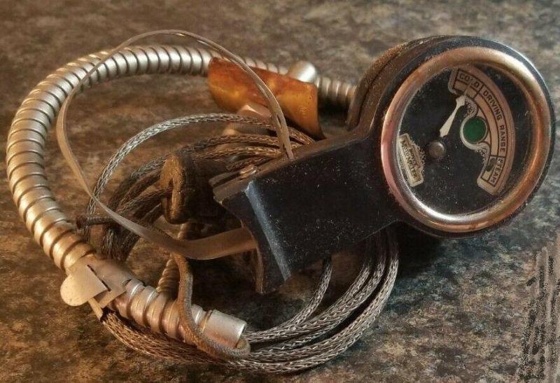

A picture of your MotoMeter would help understand your issue. The expectation is that it is a radiator cap mount as opposed to a dash mounted.
The dash mount is a Model S also called a "Red Ball". I don't see the radiator cap mount use gas but the dash/steering mount would
Might be cheaper to buy a repro APCO if dash mount

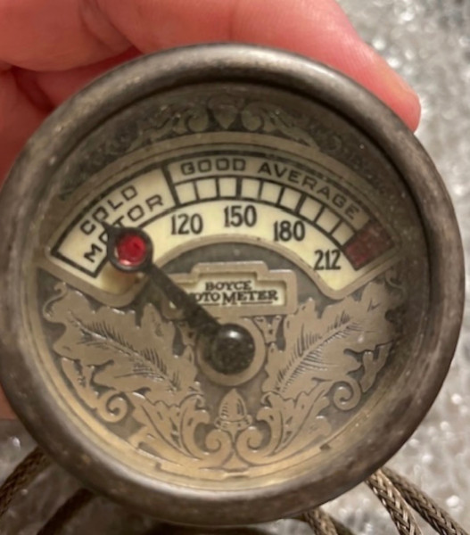

Sorry fellas, it is an original Boyce MotoMeter brand water temp gauge that goes on the dashboard or steering column. It has a tube that runs from the sensor to the gauge. Here is a picture.
Williamson’s is not in California, so I don’t think that is the issue.
That is one of the nicest looking Boyce MotoMeter remote temperature gauges I’ve seen, especially the embossed oak leaf scroll motifs. No wonder you would like to get it repaired. Best of luck in finding a repair source.

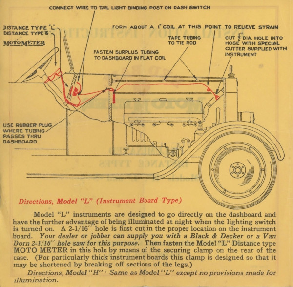

Did find instructions for that meter.
