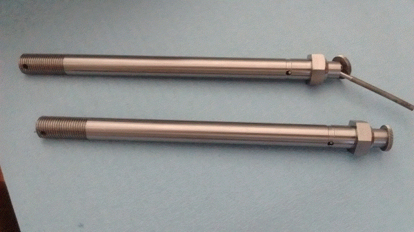

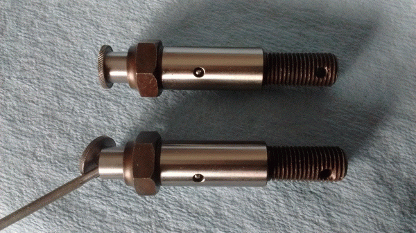

The only "cup oiler" on a '16 would be on the spindle & tie rod bolts & they would be "manhole" which are not available that I know of - perhaps Restoration Supply might have something similar in 1/8" pipe. The shackles are all 1/8" p. "twist" oilers.

and they've been made before - just not cheap like folks want so badly, so they didn't sell well
Tie Rod Bolts - Manhole Cover.gif (164.04 KiB) Viewed 1005 times
manhole cover kingpins.gif (122.08 KiB) Viewed 1005 times
