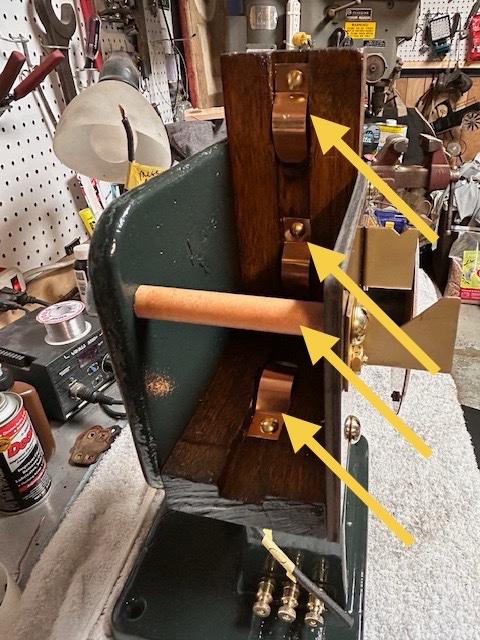

Good afternoon ,
I was just finishing up the last of the wiring and then ,, woops .
Appears the contact had been previously epoxied .
That would explain the stakon connector .
Il order a new magneto tower but I’m unsure of how to determine if the contactor is the correct height .
If not long enough then no voltage ,, but if too long I don’t want to damage the coil .
Can anyone provide some guidance on fit up ?
Thanks , Vince
Thanks , Vince

Third Test Run: Did not make it up the hill on my quarter mile "test track'. Tried several times forward. As, the engine ran longer mis-fires were creeping in. By the time I decided to try the hill in reverse, I could not go forward or reverse on a slight slope. Backed down into an open field. Walked home and got on a waiting list to go in for replacement wiring. Then, made a call to a T expert who advised several steps. First, clean the coil box contacts and then switch the coils around to see if it's a bad coil. Drove back and did that. It was a bad coil. The switch gave me enough power to almost get over the hill. Without the top-of-the-hill push by my farmer neighbor, I would have not made it back to my garage. Going to replace bad coil.
Electrical: Since there is already a thick board under the battery that increases its height over the metal battery frame, I'm going to move the nearby metal retaining clip away from the positive terminal to the other end of the battery.
As advised by "Dr. Scott", I will continue to work on getting a properly running engine on battery before advancing on magneto issue.

Forth Test Run: After replacing the bad coil, my T was firing on all four cylinders for the first time in my brief ownership. Ran the gravel test track and conquered the dreaded hill with no problem and wife cheering in the back seat.
Since that was achieved, I went directly into the...
Fifth Test Run: From my driveway, a 2.2 mile run to the local general store. I live with hills where the roads were designed for horse traffic. Most long hills have a flat built into them to rest the draft horses. So after achieving the first part of the hill, I was able to shift into High gear for the first time EVER. (I took a T driving class in Hershey, Pa where all five models were driven in Low gear only.) WOW, High gear is amazing! The increase in speed and the lower rpms quieted the ride down. And, I was driving on a paved road. Almost no noise! Finally experienced Model T speed. Two hairy moments: 1) driving into the empty general store parking lot, I forgot to level shift out of High gear. So when I wanted to slow down and wrongly took my foot off the Low gear pedal, YIKES! I recovered before driving into a fence. 2) I went over an intersection bump that began a death wobble/shimmy. Stopped the car, pulled on the wheels for any noticeable play...none, had wife view rolling from behind and forward...no noticeable wobble/shimmy, and continued home with no issues. Called knowledgeable T friend who explained the why and recovery from wobble/shimmy.
So...back to the Magneto. I've purchased #1156 bulbs and socket to test output. That will not happen a week. Stay tuned and thanks for the help.
