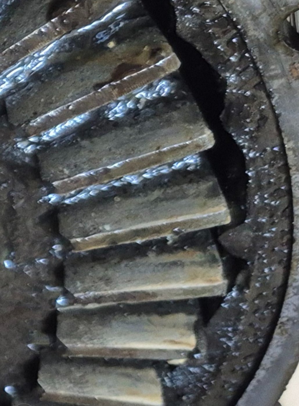

Bore scope thru the grease fill plug. Look @ the gear teeth.

John Karvaly---> I will do a careful look-see through the fill hole at the ring gear teeth and if they look good I intend to keep running it as is. If it matters, the overhaul in 2017 was done by Larry Blair at Tin Shed using new parts from Chaffins.

The appearance of the gear teeth may not indicate a problem. I would not depend on that alone.

Don't assume a good visual = no problem. My ring & pinion 'looked' fine....while ALL my internals were toast.

What you described & a moved bearing collar I have seen before. The point of looking @ the gear teeth is to confirm skipping.
