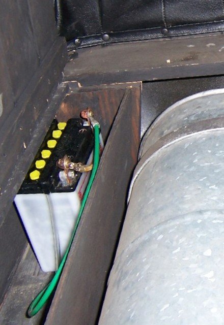

Post by KWTownsend » Tue Sep 02, 2025 3:04 pm
I have a 12v motorcycle battery tucked into the V shaped tool compartment next to the gas tank on my 1915.
Keith

Post by Craig E. Luton » Wed Sep 03, 2025 9:44 pm
Keith; That is exactly what I was looking for. I don't know why I didn't think of using the tool box for the battery. That way I have an unobstructed route for the battery wire to the coil box and ground. Thank you Craig
