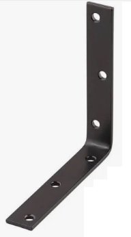

On a 1916 Runabout the issue as described probably is the door hinge pillar has started to drop.
Years of flexing while driving and the constant pulling of the windshield by the top takes it toll eventually.
The joints between the wood pillar hinge post and wood body sill has probably started to loosen up.
Shimming the body bracket will have limited results due to the other brackets along the frame.
It might work some, it might not.
Pushing up on the windshield restores proper alignment of the hinge post and allows the door to fit in the opening.
To prove this is the issue or not, push on the windshield and see where and what moves.
Re-wooding the car is the best solution to this problem but there is a repair that can be done and work quite well.
If the hinge post is moving around here is how to repair it:
Remove the interior panel in front of the door carefully so it can be reused.
Get some metal corner brace(s) from the hardware store (or make one) that can connect the hinge pillar to the rail.
Move / brace / support the pillar until it is in the proper position.
Install the brace(s) in the area behind the upholstery panel to reinforce the joint.
Remove the support(s) and test the door.
If it works good then reinstall the interior panel.
Then go enjoy the car

Thanks I will try that, I shimmed the frame bracket and it improved a bit.
