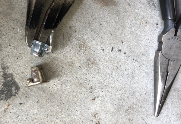

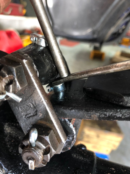

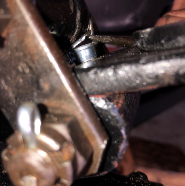

Lifting frame does help in placing new oil cups.
A trick I use when older springs have the space real tight......I trim the end of the oil cup so it sits a bit lower in the leaf hole.
Place the oil cups so that the doors face toward the center of the chassis.
Then drive in the shorty oiler with help of a flat blade screwdriver and punch to press in place.
Gives enough space to lift with oil can spout and oil away.
