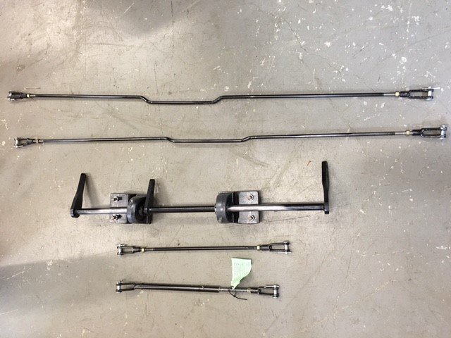

I've tried to convey this in the past, but to no avail. Here is another view showing that the rod version also has an equalizer to ensure both sides pull evenly.

Re: AC Brake Linkage
Post by speedytinc » Wed Oct 08, 2025 1:57 pm
Interesting.
I notice the rod clevises mount to a small plate that acts as an equalizer.
The secondary pull rod has a spring to remove the slack from the system.
