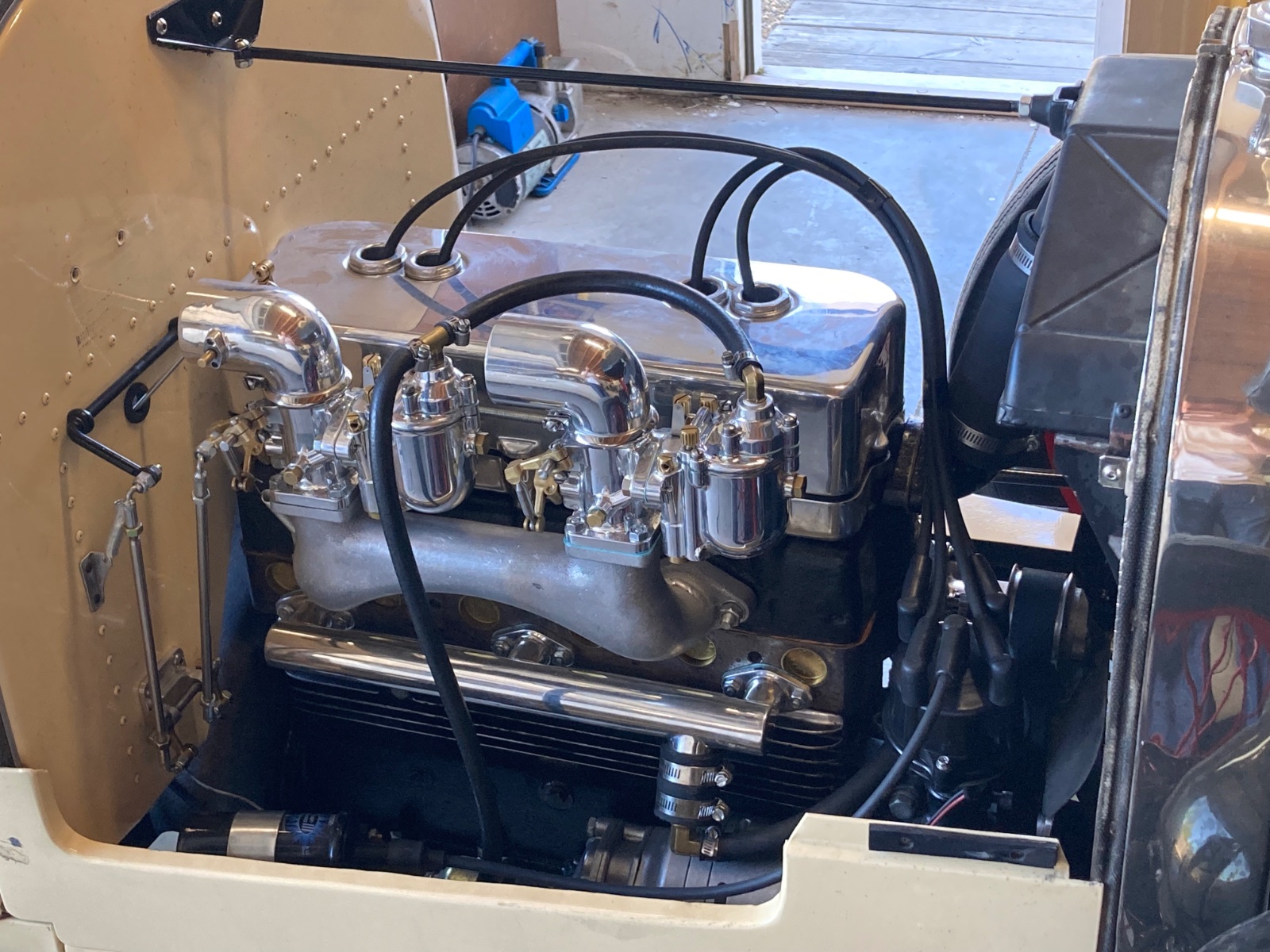

Hi all — I’m running a 1927 Model T engine with a Roof-8 OHV conversion and an added water pump. After about 10 minutes of running, I get water and steam overspilling from the radiator. What’s odd is that the radiator itself isn’t overheating — the bottom tank stays at normal temperature.
I’ve been advised to add a vent on or around the Roof head to relieve trapped pressure/heat, and before I start modifying, I’d love to hear from anyone who has actually done this.
