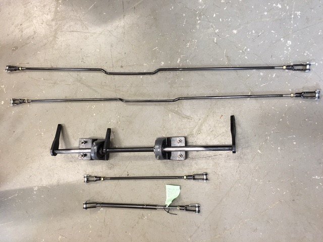

Anyone have the Rich Baughman AC Brake linkage setup that would be willing to share the dimensions for the rods from the brake pedal to the bellcrank and the rods from the bellcrank to the brakes? Also, if you have the instructions that came with the linkage set?

I will measure mine tomorrow morning for you.

I've tried to convey this in the past, but to no avail. Here is another view showing that the rod version also has an equalizer to ensure both sides pull evenly.
- Posts: 5297
Re: AC Brake Linkage
Interesting.
I notice the rod clevises mount to a small plate that acts as an equalizer.
The secondary pull rod has a spring to remove the slack from the system.
