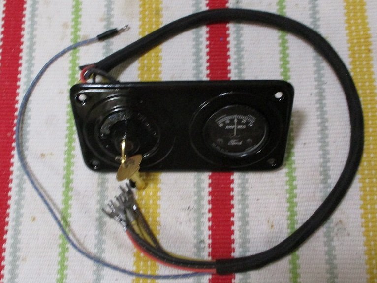

I still have three of the new 1926-27 ignition switches.
I did this one earlier last week and installed it on Saturday.
I put the wire set on to the Terminal Block to save installation time.

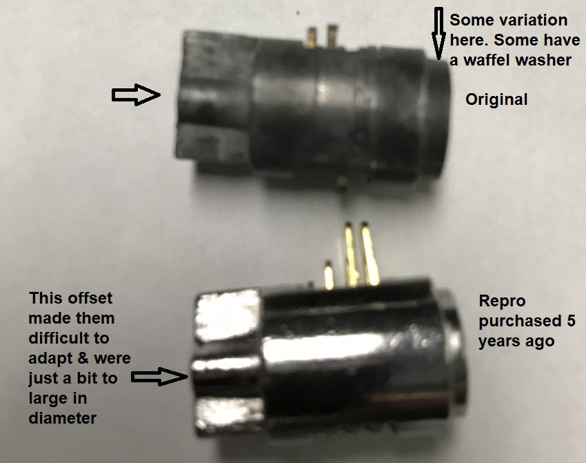

It seems as though the major problem in "servicing" is the key cylinder - originals being potmetal, they swell & crack. The repro cylinders are hit & miss as far as operating correctly in a given switch as there were several manufacturers. Lang's carries a good replacement back piece for both pin & tab type which besides the cylinder can be easily replaced eliminating most of the issues.

That cylinder is a few thousands larger and will only replace a new switch that also uses those cylinders.
There were a huge number of those cylinders made about 30 years ago or so and they are all worthless to use with a rebuilt original switch.

I have one that is split in half will add picture later
This is the difference between original and a repro I have

I guess you sometimes have to do with what’s available. The repo key cylinders can be made to fit an original ignition switch housing. It takes a little time and patience. Being a part time locksmith among other things I learned from watching and helping the school locksmith working on lock fitment. Using small files to dress down the repo cylinders in the right places and trial and error to get the cylinder to fit will work. In the locksmith world T cylinders have wafers in stead of pins. Wafers are flat whereas pins are round. They do the same thing in a cylinder.
And no the repo cylinders aren’t the greatest but it’s better than nothing at all.
If the cylinders were made of brass or a good grade of hardened aluminum to original specs they would be much better than what the repos are made of. As always it’s about the cost to build them and if the builder would make enough to do it to make it worthwhile.

The only repop I have had experience with did not physically fit. In tyring to make good I found that the potmetal housing was way softer than the original more like lead than die-cast.
