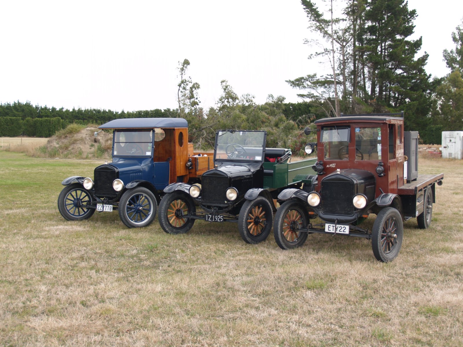

Here are the options:
C Cab (well maybe a 'square C :-) ) No Cab (Roadster) and Closed Cab (Colonial), :
