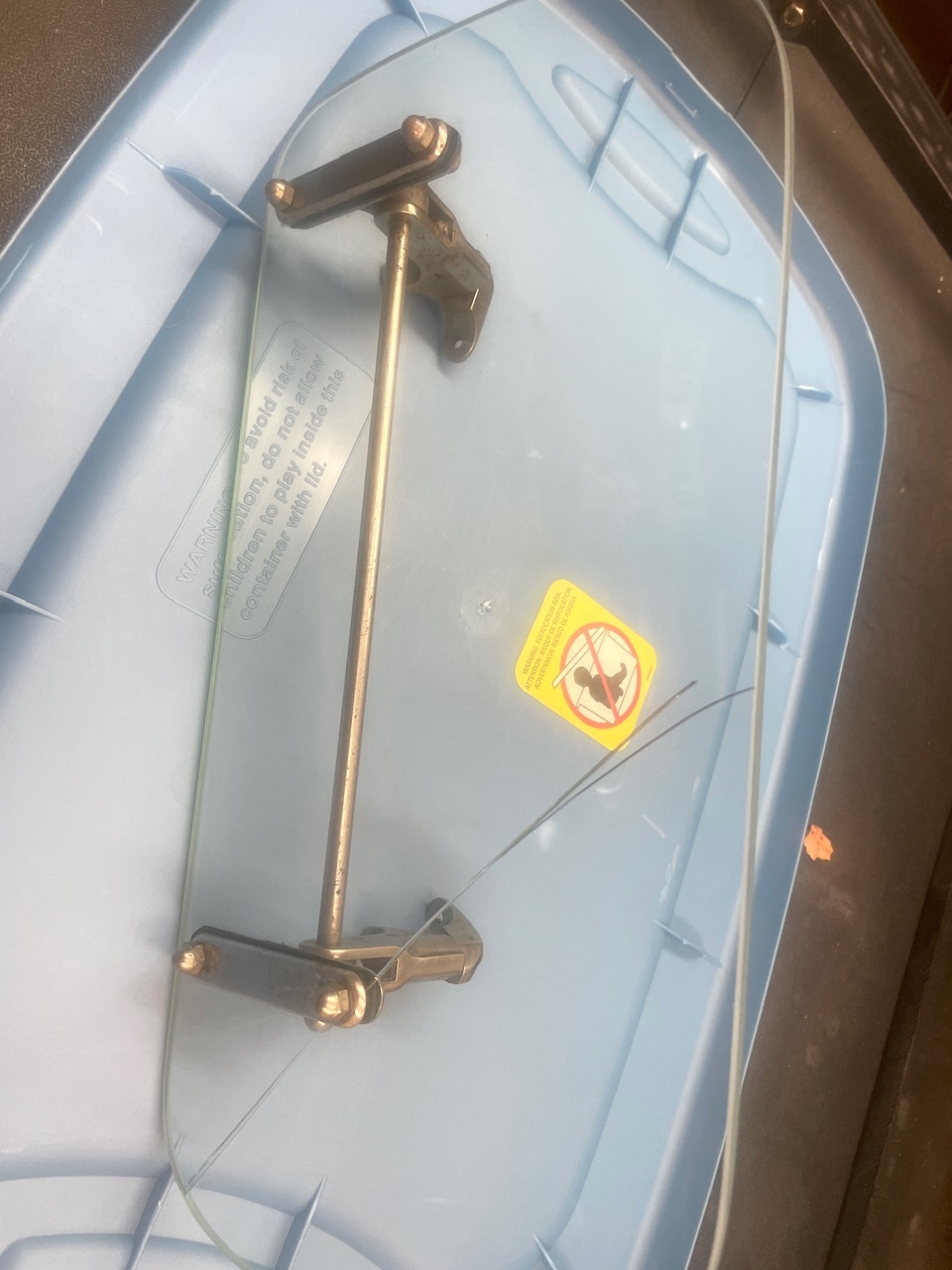

As others commented, take your windshield and go to a good glass shop for installing that lamp.
Had local Lee&Cates make laminated safety glass windwings and drilled holes for the mounts.
This year I hit one and accidentally cracked the glass across a hole (weak link)
But they made a new one and drilled holes for the mounts.

Couple of things to consider here, obviously whether you can drill a hole depends on the glass type. As Allan points out tempered glass can not be drilled, laminated can. The spotlights in their day were being added to plate glass as the other types were not usually available then. If the glass is laminated the hole can be drilled, if tempered order a new piece with a hole to be added before tempering or go for laminated.
Tempered glass would be the prefered type for some old wood bodied cars than can twist a lot and the windscreen frame may mean laminated glass will just crack as Dan shows in his photo, as side windows in vehicles still use tempered glass Dan should have been able have it used for his windwings, having seen police try to break side windows on cars you can see how good it is . A friend had a depot hack, large windscreen in a wooden frame, could not stop it cracking with laminated glass. Changed to tempered glass problem solved, another brass framed windscreen vehicle, suffered the same problem until tempered glass was installed.
