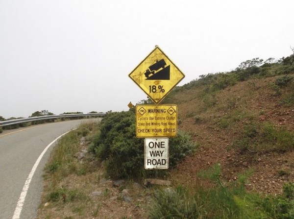

Hello fellow Model T-ers,
As many of you know, I am hosting the Golden Gate and Alexander Valley Tours June 3rd thru June 10th.
I would like to include a one mile loop segment out over the Golden Gate and Pacific Ocean but am uncertain as to whether or not an 18% grade is too steep for a Model T to descend down. This thin stretch of asphalt road has been recently repaved and is in perfect condition. Only parts of it have an 18% grade. However, it is only one car wide (a one-way single lane) with zero shoulder on either side. Our tour would be the only traffic here on this Monday afternoon. You can view this beautifully spectacular, yet ominous, stretch on Youtube. Here's the link. https://www.youtube.com/watch?v=SjRCHcmmfos
What do you guys think? Should I include it on my 'day one' Marin Headlands tour or avoid it altogether and choose a flatter way?
I would appreciate your advice.
By the way; We still have 2 spots available on these tours.

Re: Is this 18% grade too steep for a Model T to descend down?
Post by John kuehn » Fri Jul 05, 2019 9:23 pm
Going down the hill is one thing if your the only one on the road. It’s a whole different story when there is other people on the road with bikes or anything else. I’m for one having fun in old cars but not at the risk of getting killed in one.
Dennis_Brown
Posts: 261
Joined: Wed Jan 09, 2019 10:14 pm
Last Name: Brown
* REQUIRED* Type and Year of Model Ts owned: 1926 Roadster pickup
Location: Spring Hill Fl
Post by Dennis_Brown » Fri Jul 05, 2019 9:36 pm
I would not go down it. You may Have an all restored t with lots of new repo parts but you also have parts that are 100 years old and any one of them could let go at any time especially under a strain and that could put you over the guard rail or barreling down the hill like a rocket. I have never been on a tour but I believe they are meant to enjoy , not to stress you out about an overly steep downgrade with curves or put you in danger.
babychadwick
Posts: 732
First Name: Chad
Last Name: Azevedo
Location: Henderson, TN
Post by babychadwick » Fri Jul 05, 2019 10:00 pm
We had a pretty decent downgrade on this years endurance run. I believe it was about 2300 foot drop in 3 miles single lane dirt with no guard rail. To my knowledge all the speedsters went down just fine. I drove as I often have, engine off ruckstel low alternating between bands/rock to bring to a near stop and then coast again allowing the engine to do most of the braking.
Rich Bingham
Posts: 1942
First Name: Rich
Last Name: Bingham
Location: Blackfoot, Idaho
Post by Rich Bingham » Sat Jul 06, 2019 10:23 am
That run represents an average 14% grade if I did the math right. Good on ya, Chad !! :D
(Maybe harder to descend "up" ?? :lol: )
"Get a horse !"
Posts: 3818
Location: Lomita, California
Post by Original Smith » Sat Jul 06, 2019 11:09 am
I've never been able to figure out where people get Ruckstell low from! You are either in Ruckstell or you are not! When I was going down that hill, I had my car in standard Ford low, and that was all that was needed.
NorthSouth
Posts: 614
Last Name: California
Location: West Coast
Post by NorthSouth » Sat Jul 06, 2019 11:12 am
Correction: Larry Smith was not "reckless" that day way up in the clouds. Rather, he opting for that ominous 18 degree plunge was a testament to his life long driving experience and to the refined and capable condition of his T.
