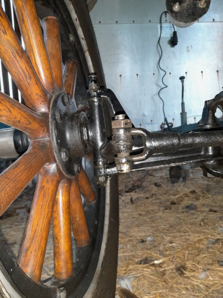

Hello from the UK,
I am new to Model Ts and am 6 weeks into owning a 1924 Tourer. Although should I say Touring, since it was imported from the US? It was 're-built' 20 odd years ago (no real history...) to 12V alternator, starter, indicators etc to make it an every day car rather than a show car. Perfect for me.
Anyway, I am working around it and whilst it is not original in lots of ways, I'd like important bits to 'be right'. Looking at the tie-rod yokes, the internal dimension is 1 1/16" and the spindle arm is 7/8". On the driver side, there is a spacer to accommodate the difference but not on the left, so the yoke can slide up and down on the bush.
Does my car have the correct tie-rod? Should there be a spacer? If I find a suitable spacer for the other end, would that be considered an acceptable solution?
Any comments on this would be appreciated.

No spacer. Doesnt sound right. Post a picture if possible.

Personally, I would not worry about a 3/16 inch gap but if you are, could add an 1/8-inch steel or brass thrust washer. Most have worn some over the years but that little amount of wear should not hurt anything. What is more important is the condition of the pins and bushings.

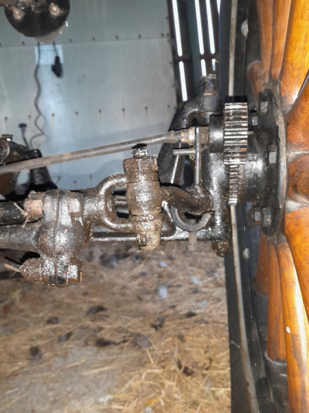

Thanks for the comments.
It doesn't look like wear to me... so it sounds like it is the incorrect tie-rod. On the plus side, the pins and bushes are nice and tight, the tracking seems pretty much OK and it drives well.
So maybe I find a suitable spacer as a short-term thing and put finding a correct tie-rod on the longer term?
Photos hopefully here:

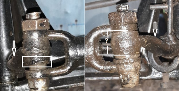

The spindle arms are worn & not sure if they are the same. The left one looks straight and the right (speedo gear) looks to have the curve but its upwards instead on downwards.

It really appears as if your spindle arm ends have been shortened in their width, either by wear or ??? Hard to tell from your photo, but it also seems that your left side spindle arm is a bit mangled. It does not appear to have the same graceful "S" curve that the right side has.

@TRDxB2 & @Jerry VanOoteghem Thank you - the left arm does have an S curve to it but it doesn't seem to be as exaggerated as the right one. And both curve up, so the tie-rod end is higher than the spindle end. It doesn't look mangled or bent in the flesh - I think what TRD has boxed in his photo is an illusion and is just where paint has flaked off. But I think I ought to look a bit further at the difference in curve.

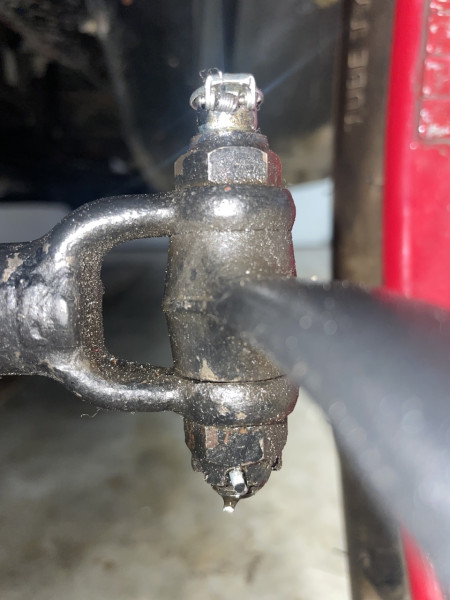

@DanTreace Thanks for that photo, that makes the wear on the arm look very clear. Thanks for advice re any washer if I go that way and for changing to the correct nut & pin.
