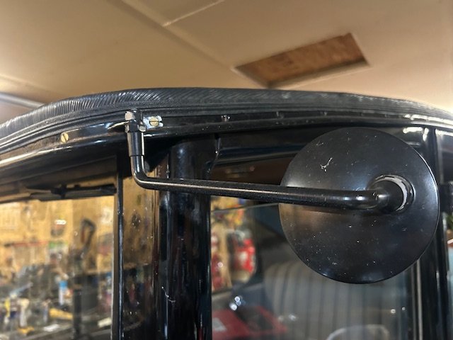

Richard - I made a bracket that attaches to two rain Moulding screws and it works very well without drilling any holes or otherwise altering the car. It took a little welding and fabrication.

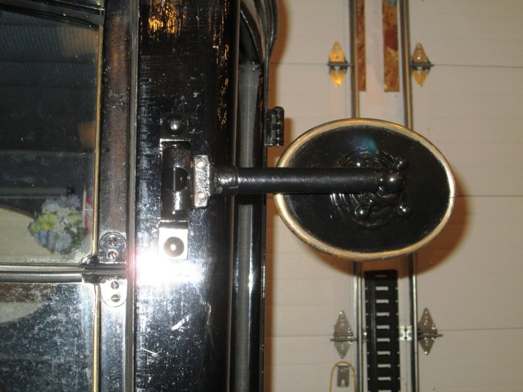

We have a '19 - I fabricated the tube mount as they're quite rare for the closed cars, then used a nice original open car mirror.
