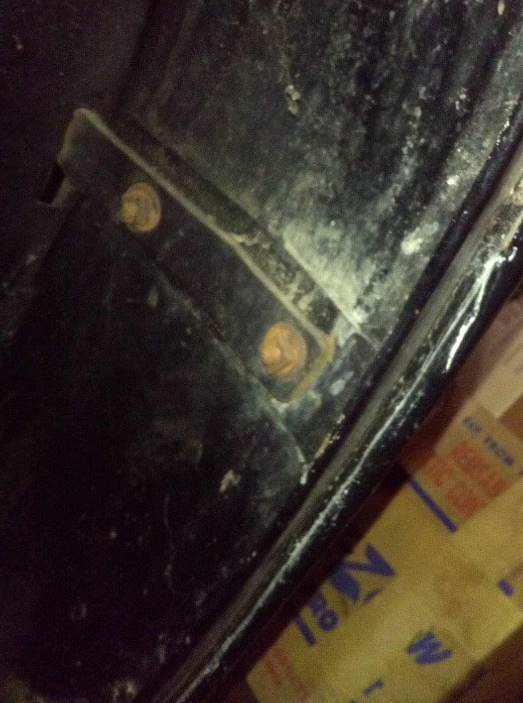

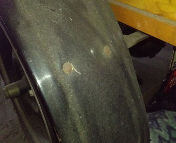

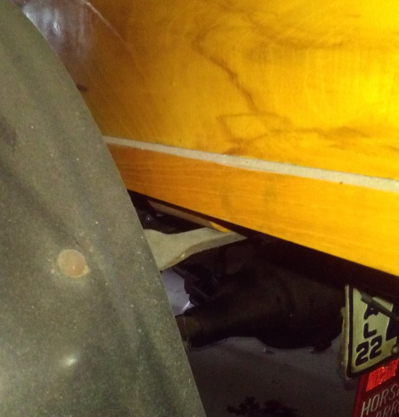

Many hack fenders never had the Ford mounting brackets mounted or included. Probably due to the fact noted above that they tend to be a bit narrower than a Ford fender. The pictures below show how a fender without the Ford style eye-bolt bracket could be mounted. The mounting bracket below is on a car that was rebuilt from an original, includng the fender and bracket. The mounting bracket is a 5/16 x 1 1/4 strip of flat iron, probably made by the same blacksmith that made the body irons. There is a rectangular hole cut in the inner fender panel to allow the bracket to pass thru to the underside of the body. The fender side of the bracket is contoured to the fender crown, and attached wit two plow head bolts thru the fender sheet metal. Where the bracket meets the underside of the body, the bracket is twisted so that it can bolt to the flat underside of the body. Pretty simple way to do it with common available material.

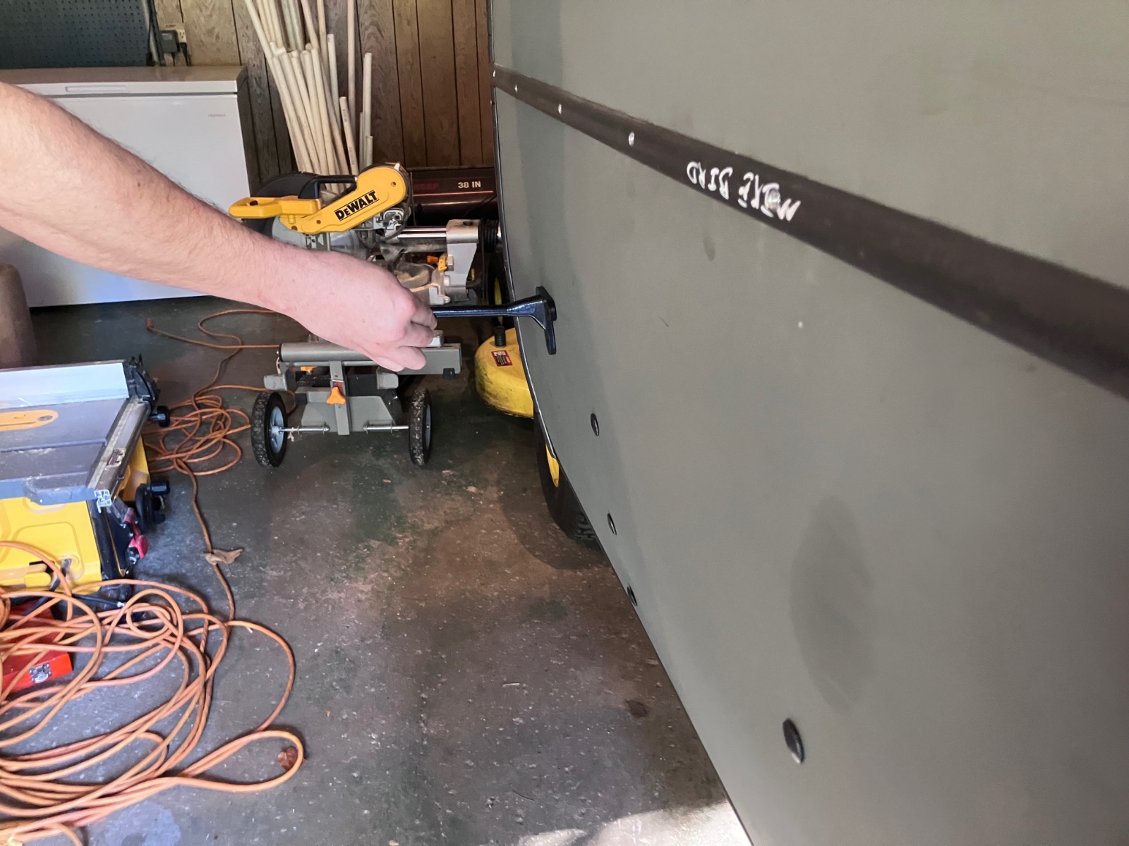

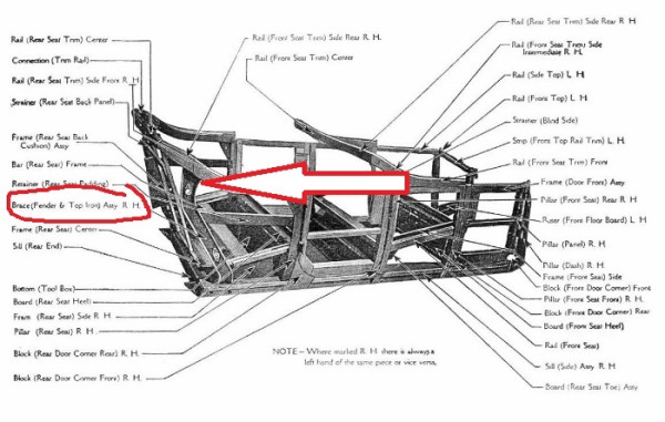

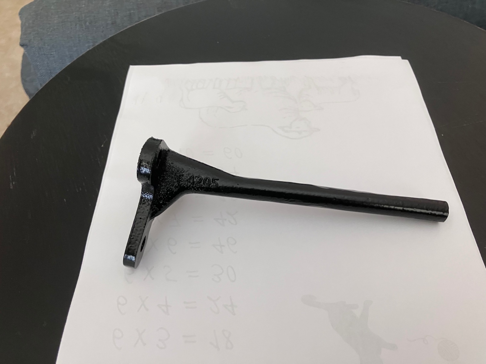

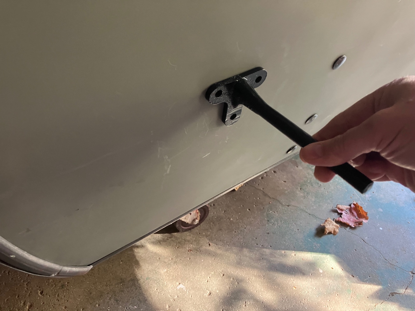

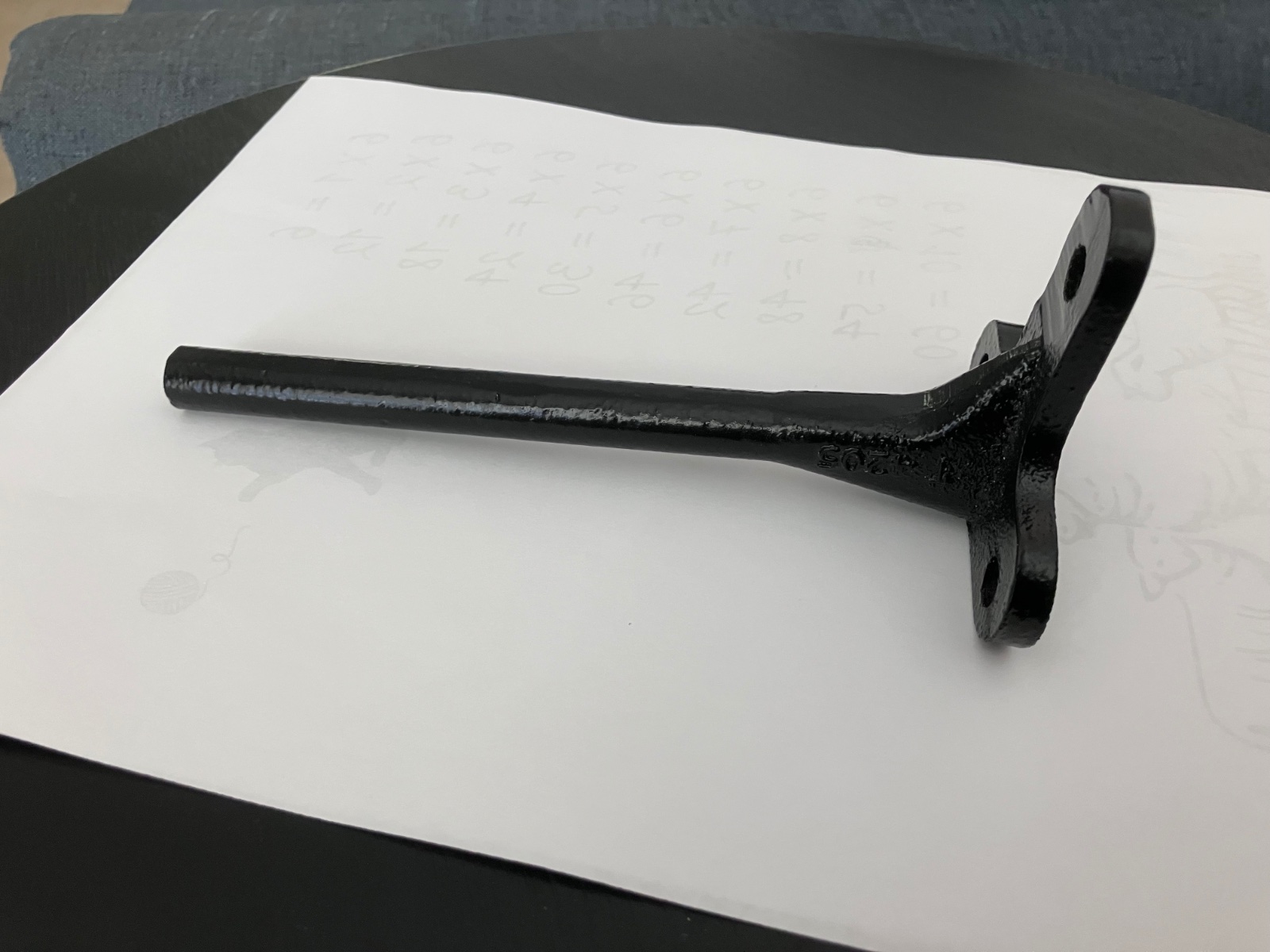

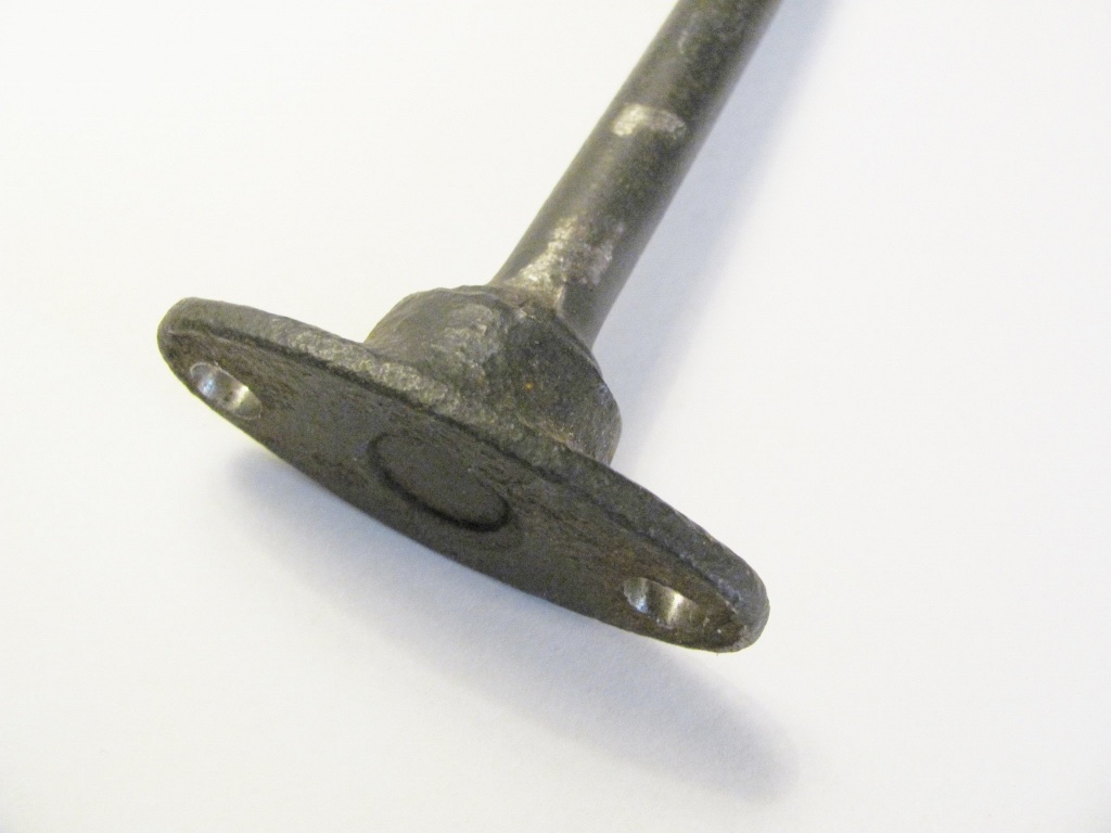

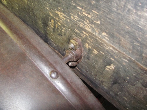

The fenders Rootlieb sells are the same as the 1910 touring fenders the difference is two mounting brackets or the single. The 1910 touring fenders used the butterfly bracket/fender iron that mounted to the chassis. When Ford made the Delivery car it used the 1910 touring fenders but with one bracket to receive the fender iron. The fender iron was unique to the delivery car into that it mounted directly to the outside of the body and into very thick wood blocks on the inside of the body framework. All of the suggested ideas are great but think Dan Treace is in the right direction in what would be helpful in mounting a depot hack fender. Below are what the fender iron looks like for the delivery car and how it’s mounted.

inside wood block for mounting fender iron.
