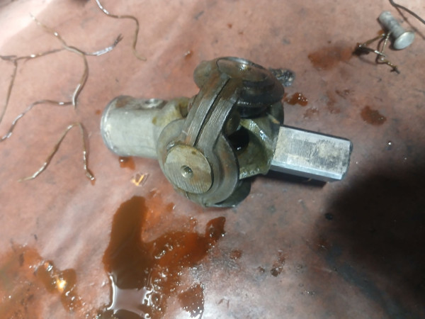

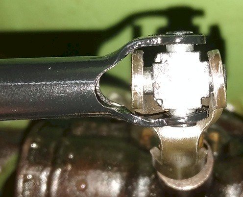

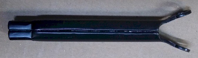

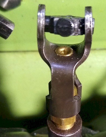

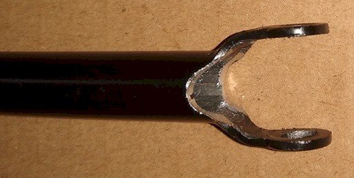

Since I had to remove the choke rod in order to address the freeze plug issue...it's time to fix the carburetor universal joint binding that happens when ever I adjust the mixture while in cab. I can see that lower part of the universal joint is in a U shape but the choke rod part is in a V shape. The holes in the choke rod portion aren't even close to being parallel to each other.

Just bend them into parallel to make them engage on the other two bosses on the U joint cross piece. They have to be spread like that to get them over the cross, before bending the back into parallel.

2) The joint is cheap and often beyond ideal angle so make sure the sides are symmetrical and even with no burrs to catch on anything.
Paying attention while bending and making it nice ill pay off. Once it is done there will be no need to re-bend anything in the future, just slip the rod up the square drive.

The reproduction top and bottom yoke parts are not made exactly right and require a bit of clearance-ing and fitting around the area of the universal joint. Look carefully at it when turning and you will see where you have to re-form and open up the top yoke to be a “u” and also grind some material away on the yoke ends and corners of the u-joint. I have fit a bunch of these over the last 25 years. The parts don’t work “right out of the box”.

When I removed the rod completely from the carburetor, I could still feel binding, but I think I fixed it the right way.
Bending the two ears with their out-of-the-box length into a U shape looked like it may catch on the center shank. So, I used the Dremel again to mill out the center section, adding length to the ears, bent them into shape and painted it. I can no longer feel binding.
