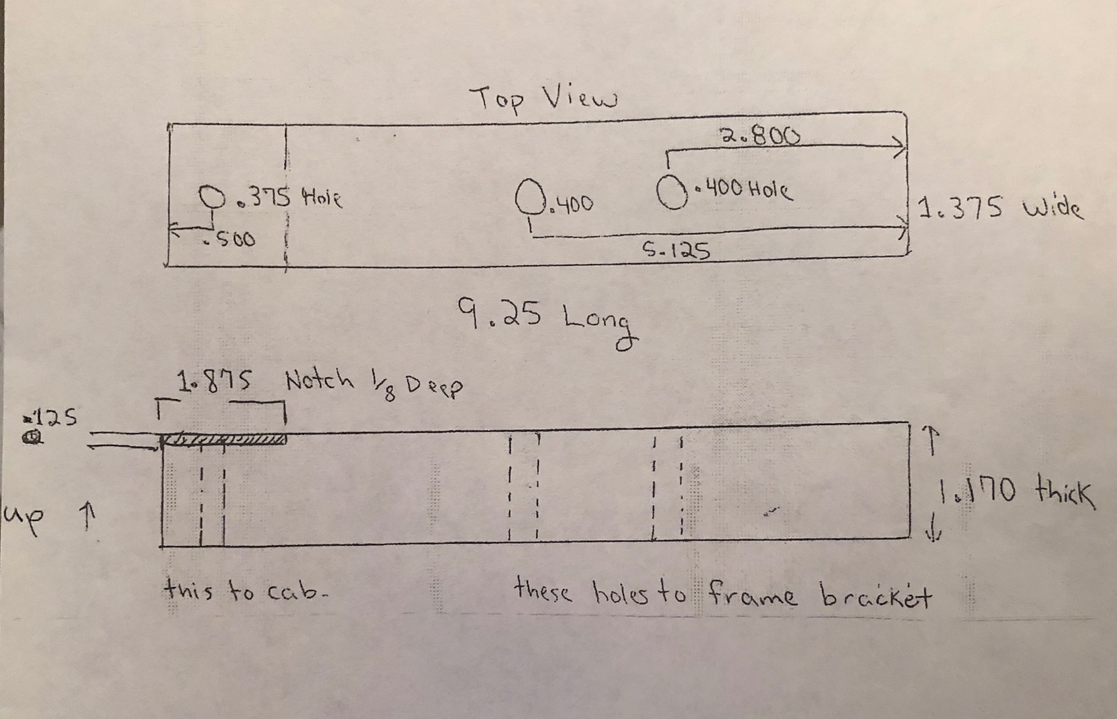

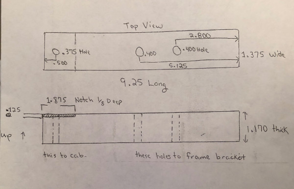

Here is a drawing of the oak blocks need for the front.

Thanks, that's exactly what I need and pretty easy to make with a table saw.desertexplorer wrote: ↑Tue Oct 28, 2025 9:49 amHere is a drawing of the oak blocks need for the front.

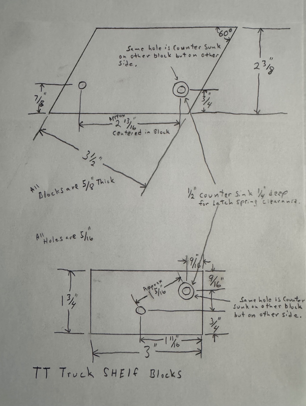

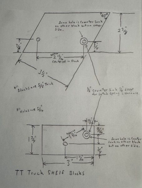

Plugging along with this project. I have the cab mounted now, and am mounting the front fenders.
Question: Does anyone have drawings for the wooden blocks under the hood shelves? If I know how thick they should be, I can make something that will work. Naturally, for a high hood but not a 26 or 27.
BTW, thanks for the drawing above.
desertexplorer
- Posts: 57
- Joined: Sat Jan 12, 2019 7:23 pm
- First Name: Wallace
- Last Name: Bellows
- * REQUIRED* Type and Year of Model Ts owned: To Many!
- Location: Las Vegas
Re: TT Square Cab mounting question - and a backstory
I hunted around and found the TT shelf blocks drawing that was given to me a few years ago. Hopefully it will work for you.
fschrope
Topic author - Posts: 121
- Joined: Sun Jan 06, 2019 9:54 pm
- First Name: Fred
- Last Name: Schrope
- * REQUIRED* Type and Year of Model Ts owned: 1923, 1926, 1927 TT's, 1918 cutoff touring, 1922 Coupe - original
- Location: Upland, IN
Thank you, that is exactly what I was looking for. I've seen these drawings somewhere in the past, but I have no idea where.
It would appear that you are the go to guy for this stuff.
Thanks again.
