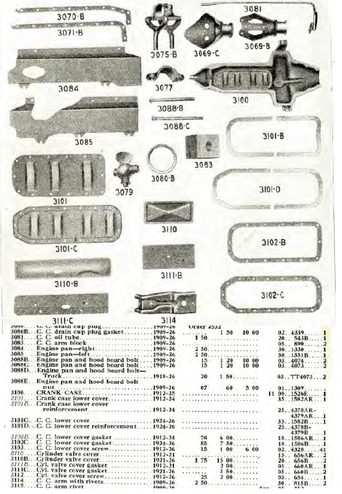

Post by TRDxB2 » Sun Nov 16, 2025 2:18 pm
From Ford Parts Manuals - no reference to "splash shields" or 3 or 4 dip pans :o
