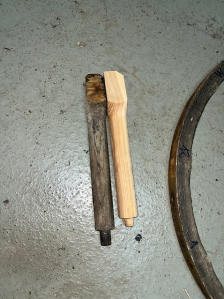

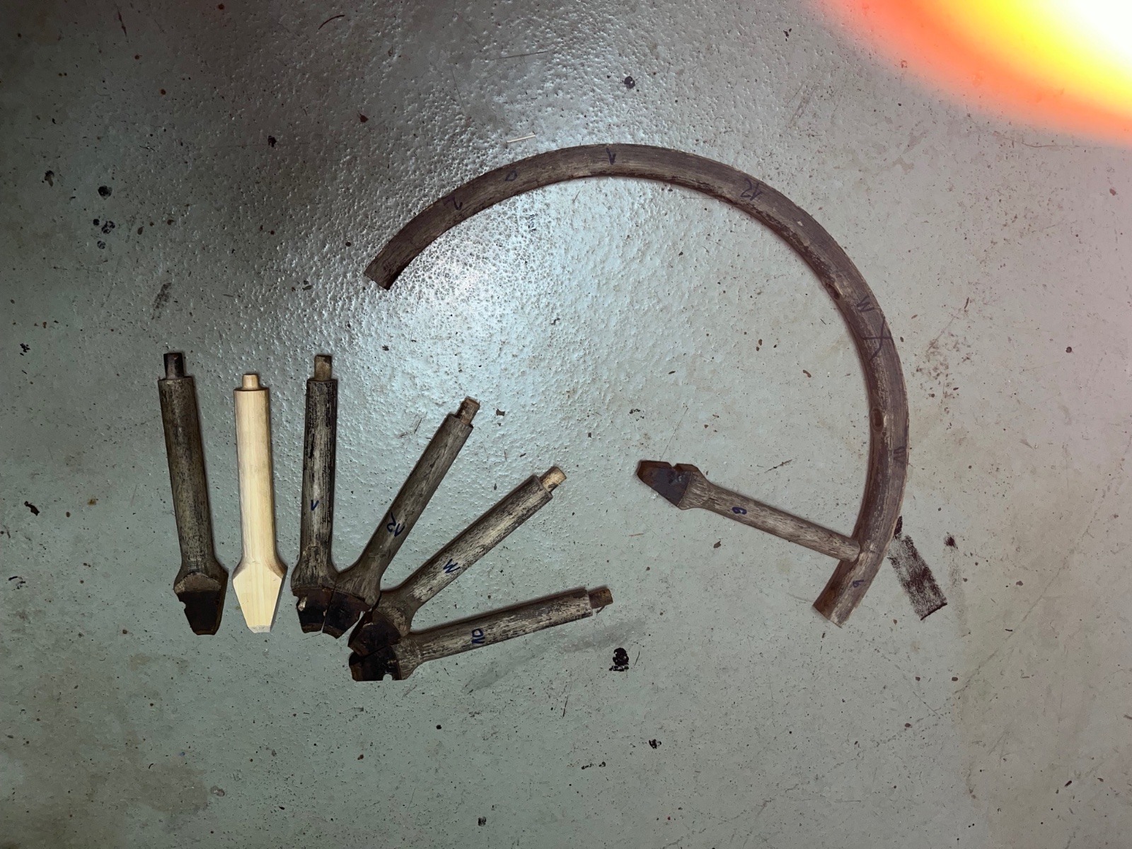

I need to exchange 4 wooden spokes for a rim with wooden spokes. The spokes are longer and a bit narrower than the regular ones. The 5/8 tenon ist longer 0,9 inch) than regular ones. Where could I get one, I could not find them at Langs or Snyders.
Thankfully for your help
Bernd
Bernd

Hi, thanks for your input.
I was very happy, to get the spokes out of the rim and wooden felloe.
But now I am a bit frustrated as I learnt that the best and safest solution is to get build a new felloe with new spokes by an experienced company like Calimer or Noah Stutzman. This would mean that I have to send the metal rim to the States and I would get back the complete and very heavy wheel with new wooden fellow and new spokes.
My preferred solution was just to exchange the 4 spokes with cracks or all 6 of a half felloe.
But Calimers FQA and the information about Stutzman show me, that both would not like to sell individually made spoke, if the size is less than the full amount of all spokes of a wheel (12).
And Calimer does not recommend a repair (exchange of some) of spokes and they do not offer this service at all.
Therefore I think I will first follow Frank’s recommendation to ask Peter to build some spokes and see if I could install them….
If this fails, I could go the better but time and money consuming way to get a new wheel build.
Thanks a lot for the many helpful advices.
Regards
Bernd

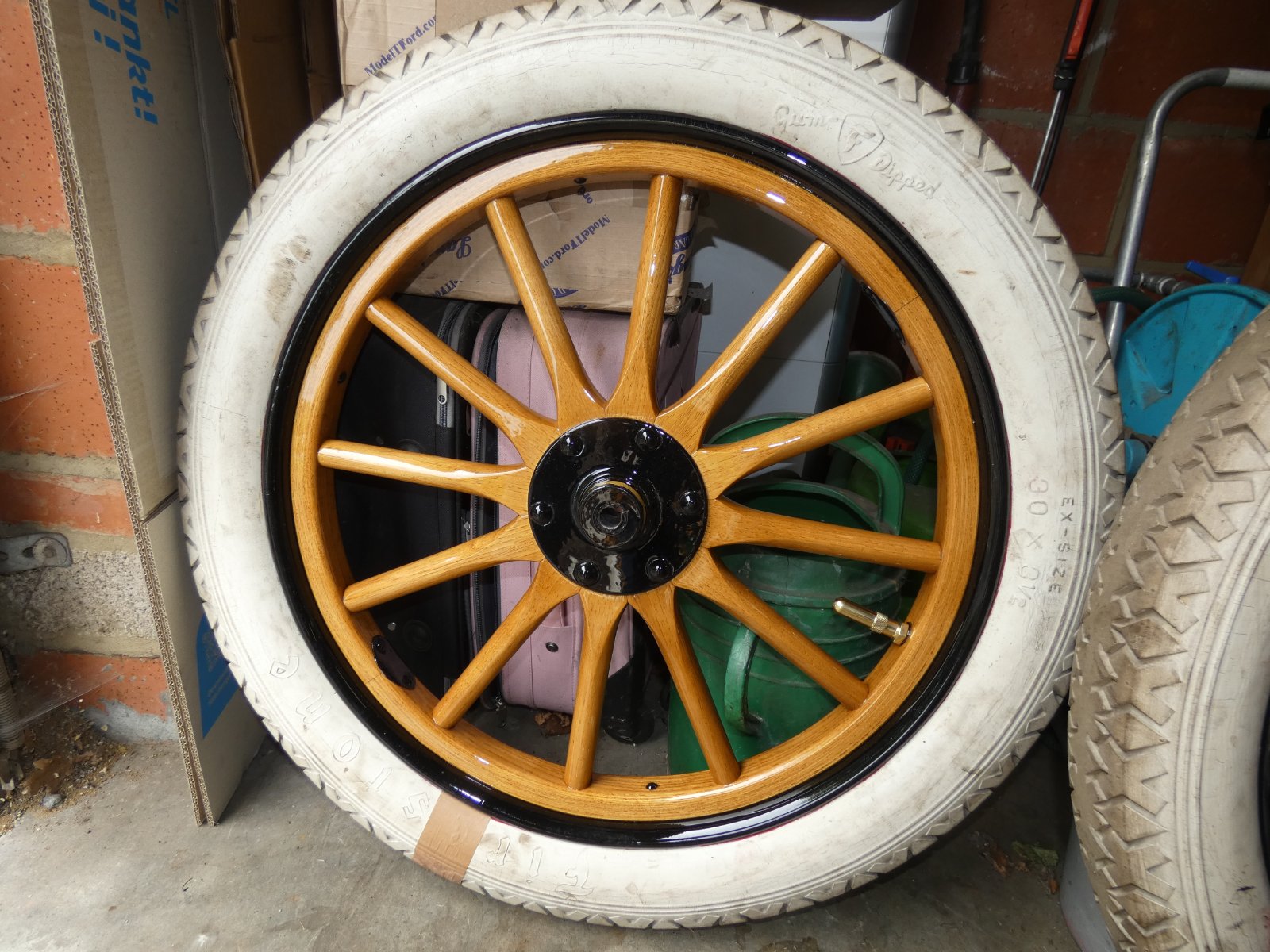

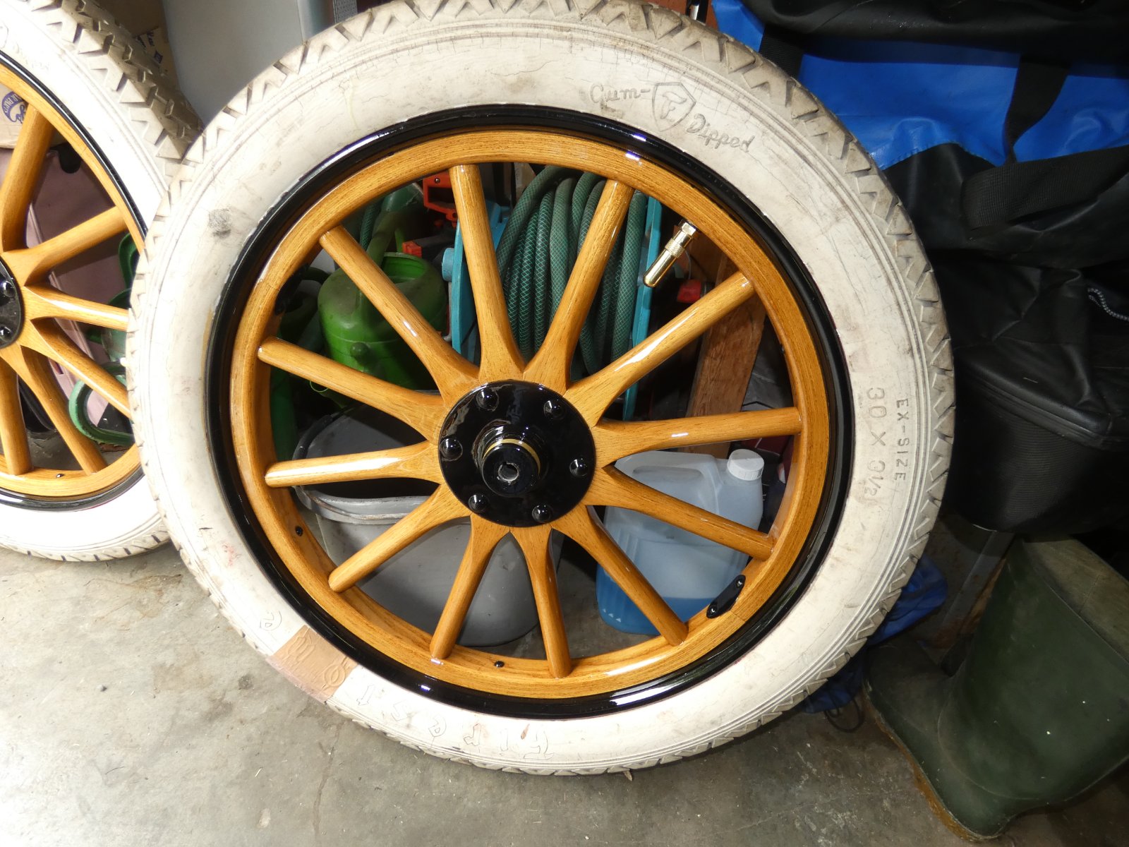

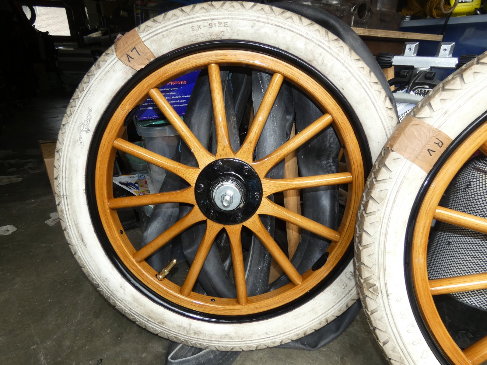

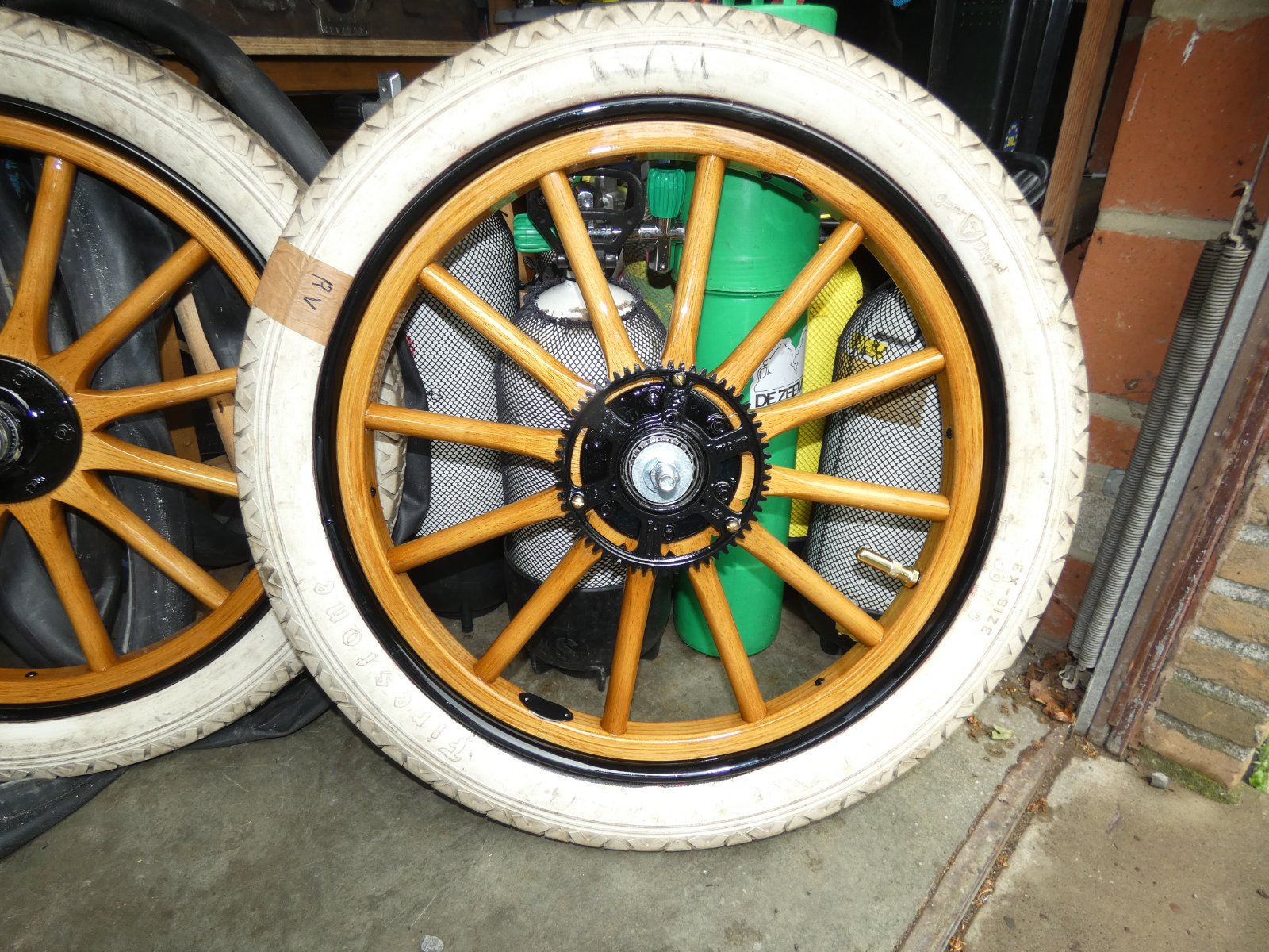

Bernhard, I just send you a mail about the wheel rebuild in Europe.
Wheels in the photos are done in Poland.
Andre
Belgium
Andre
Belgium
