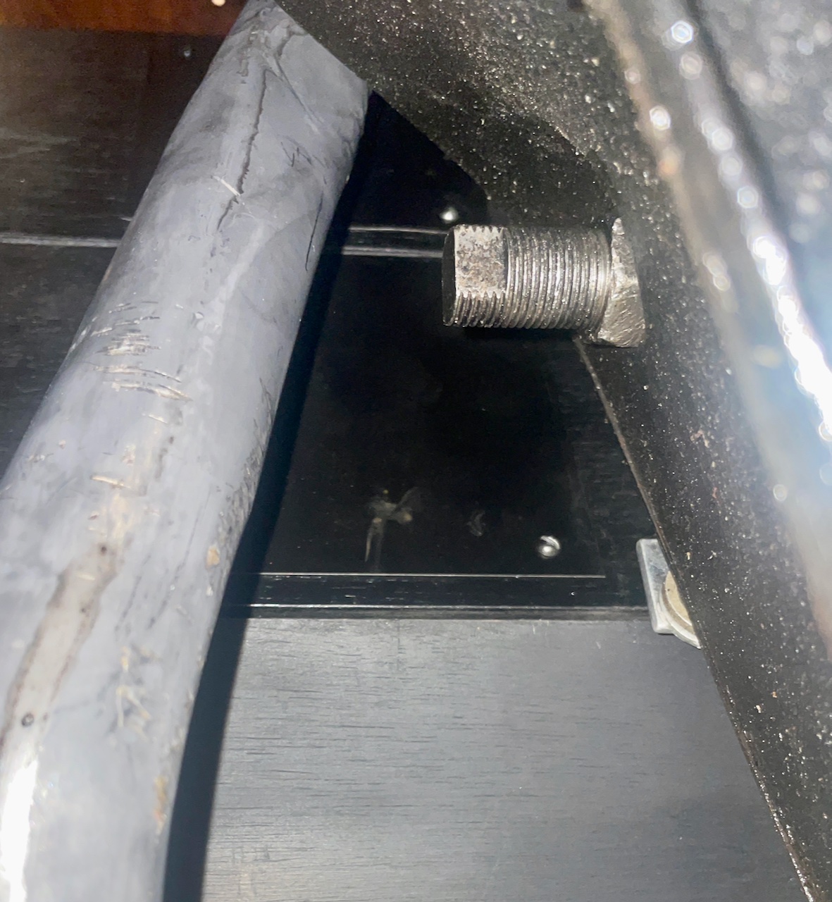

Heat shield between exhaust and floorboard?
What is anyone using?
I have plenty of scrap stainless I'm thinking about using.

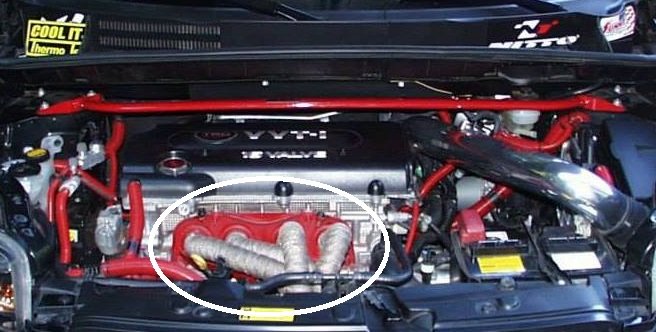

I used this on my daily driver's exhaust manifold. After an hour of driving you can touch the fabric without getting burned. The theory too is that hot gases are expelled more quickly. The company also sell's other heat shielding products https://thermotec.com/exhaust-insulatio ... 2430760877 There are many similar brands as well

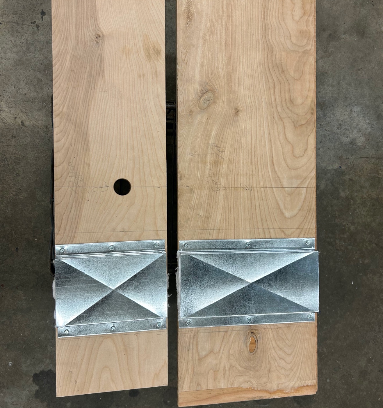

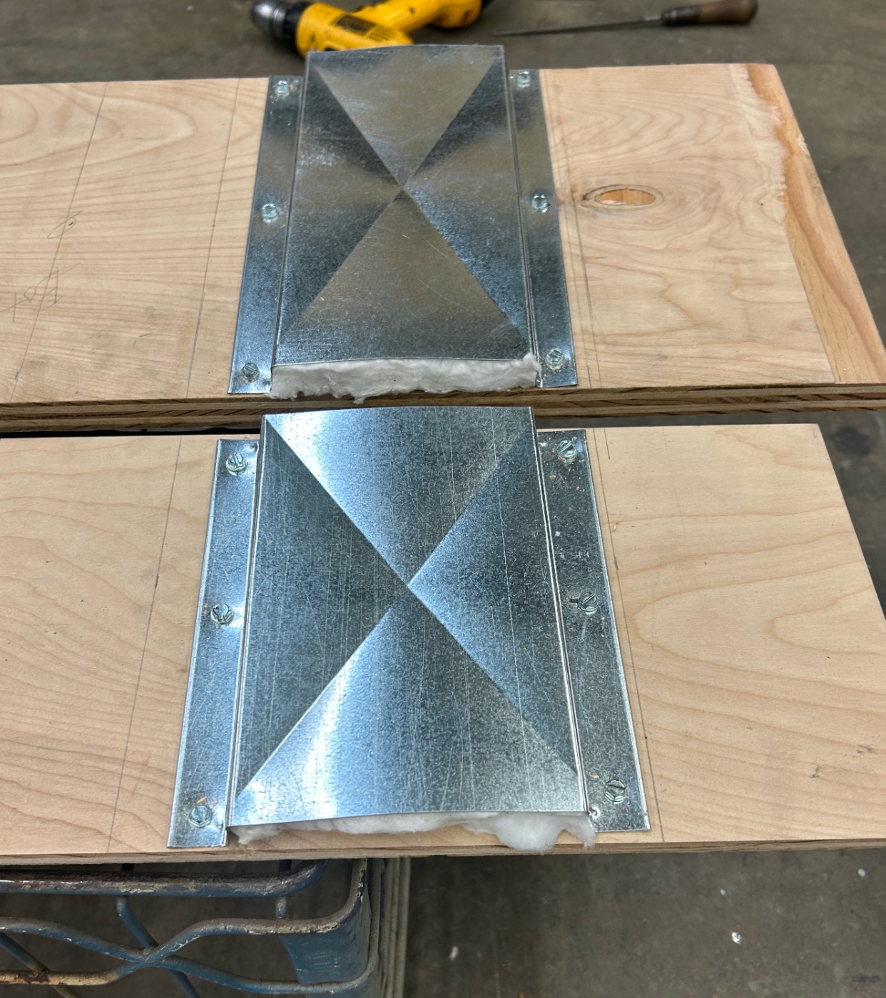

Simple heat shield, 3 magnet thimbles cut in half at the middle, flashing cut to the size you want to protect. Drill hole in each corner of the thin flashing and two holes in the middle recessed from the edge by a few inches in the middle . Line the thimbles up to the holes spacing the bottom of the floor boards by the height of the thimbles then the flashing placed over the thimbles the flashing & thimbles secured with wood screws. Air flow between the floorboard and flashing will keeps the wood from charring & keep the flashing cool enough that it doesn’t burn the wood.
It works well & is simple to do with stuff most of us have available. Best john
