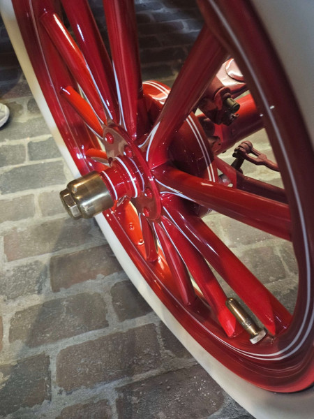

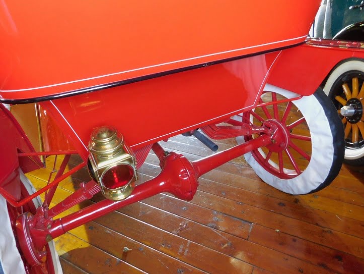

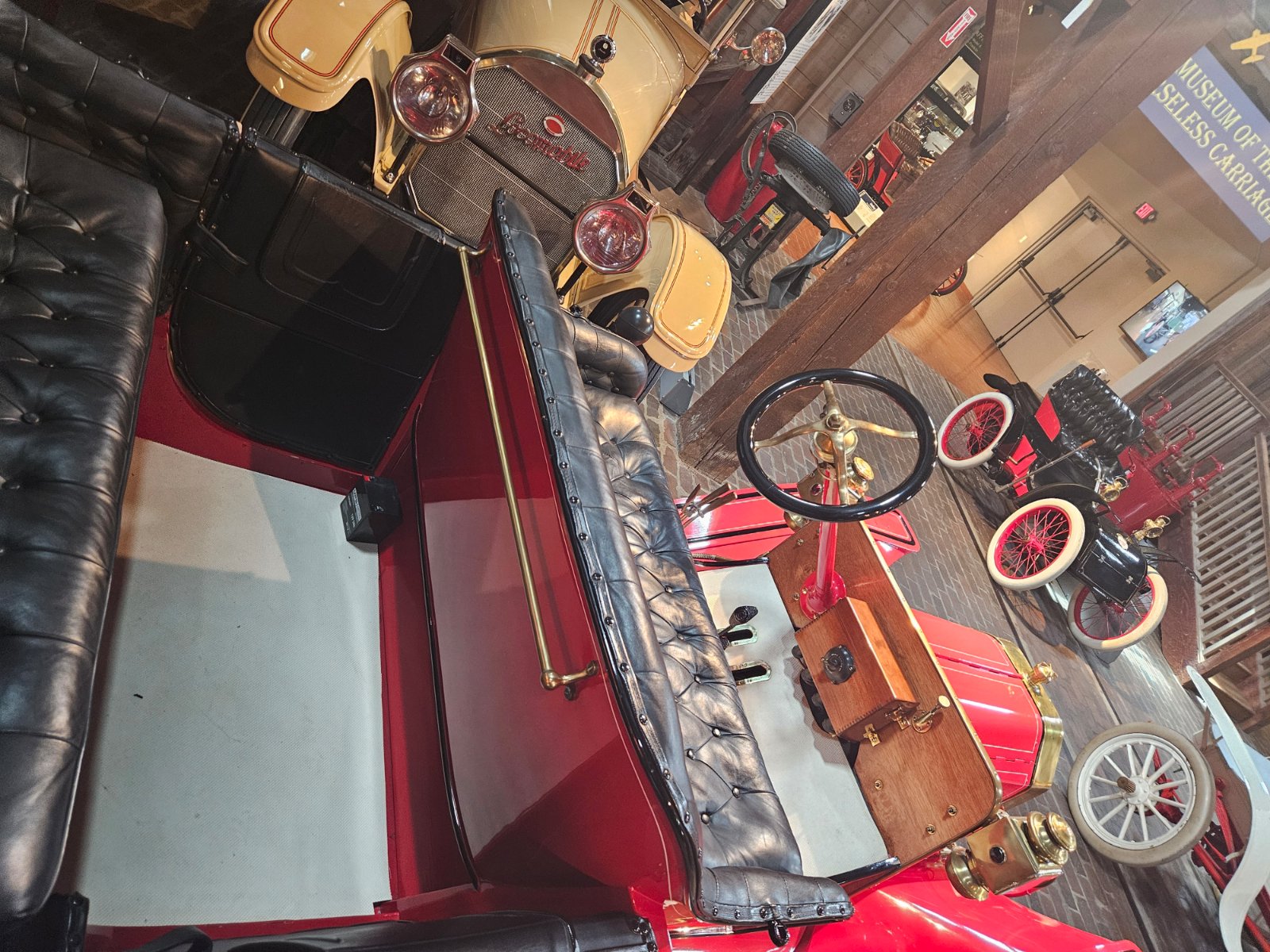

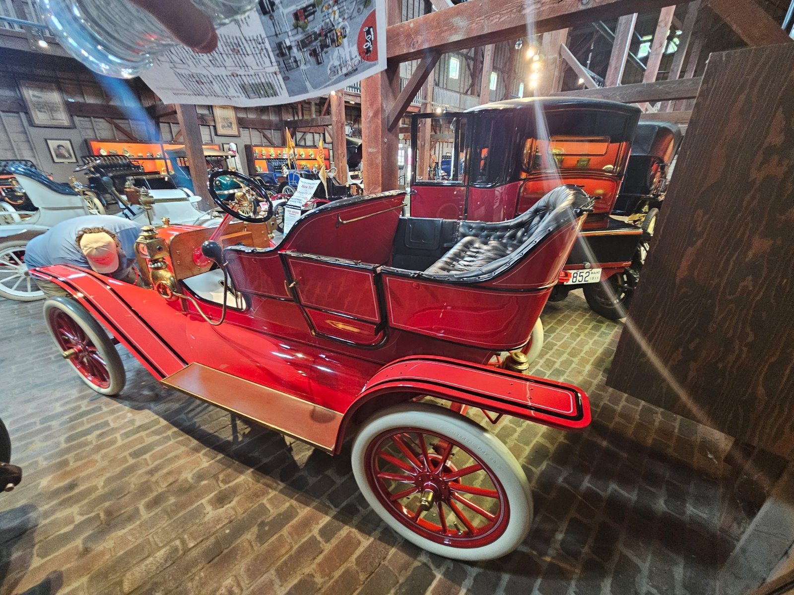

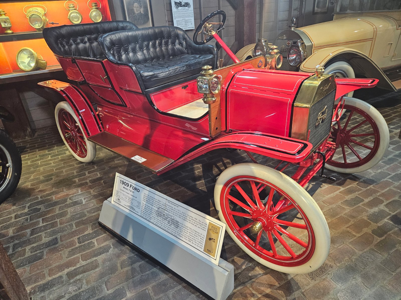

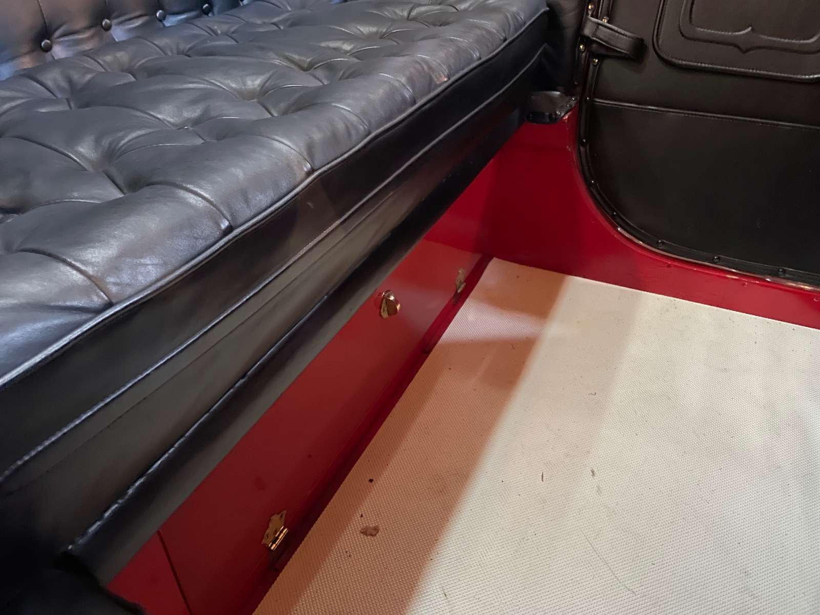

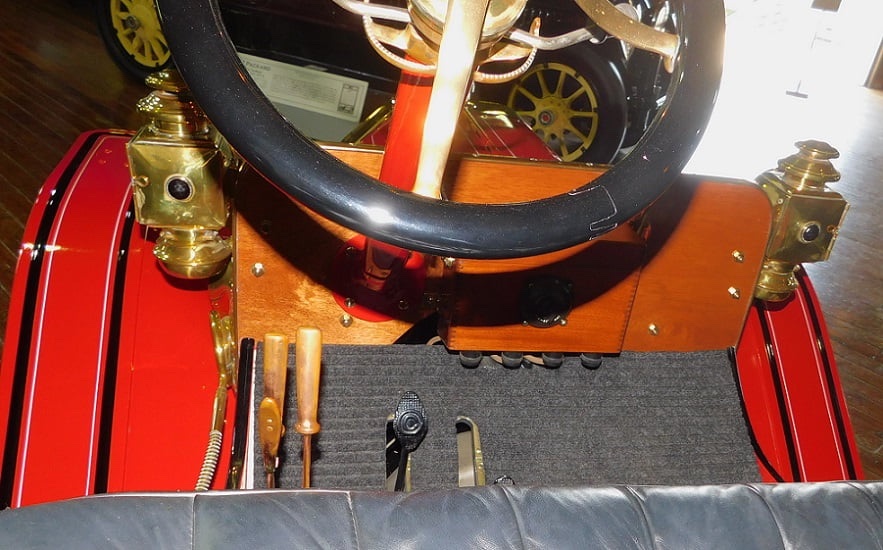

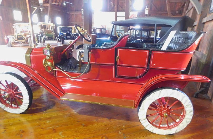

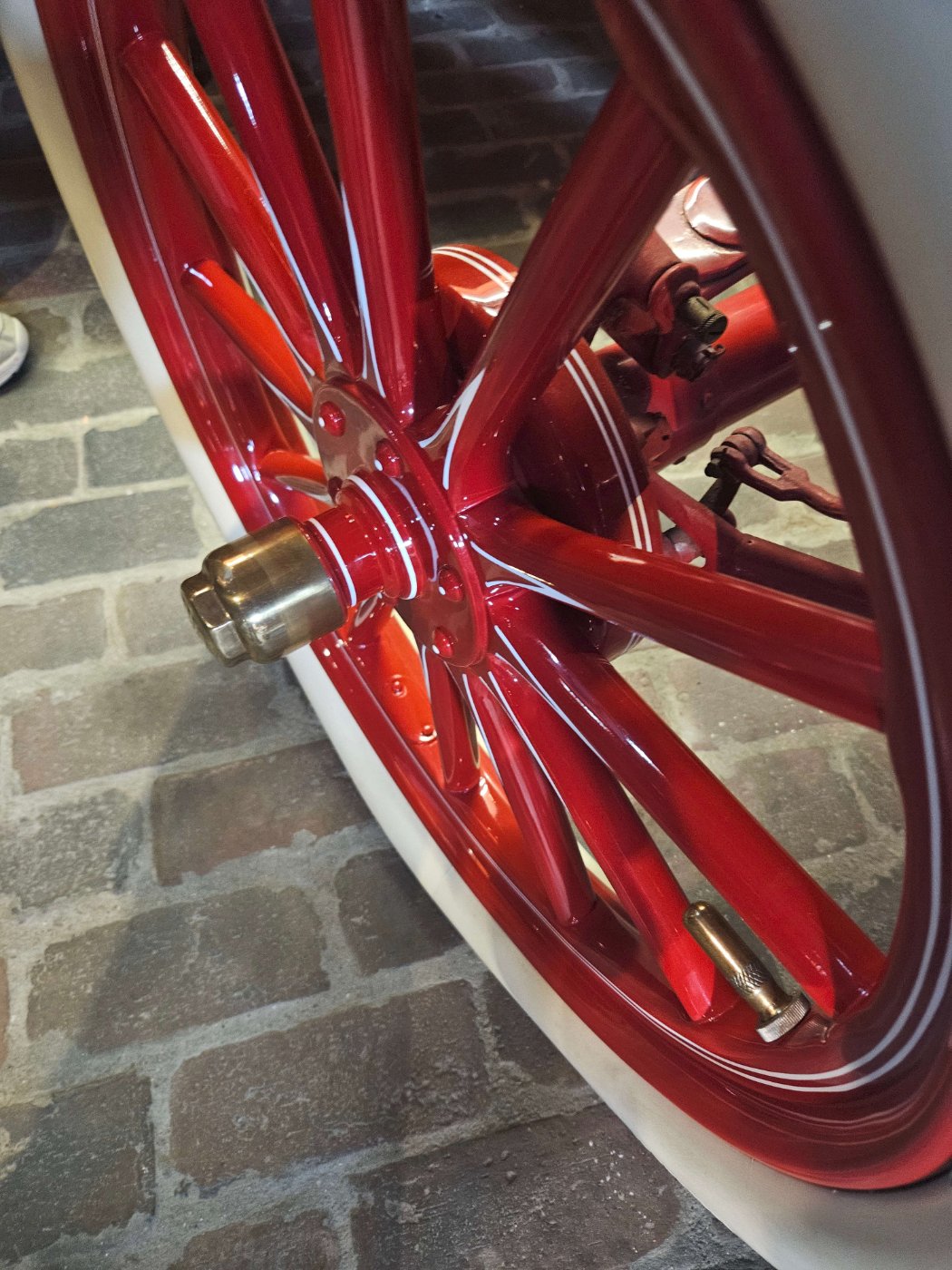

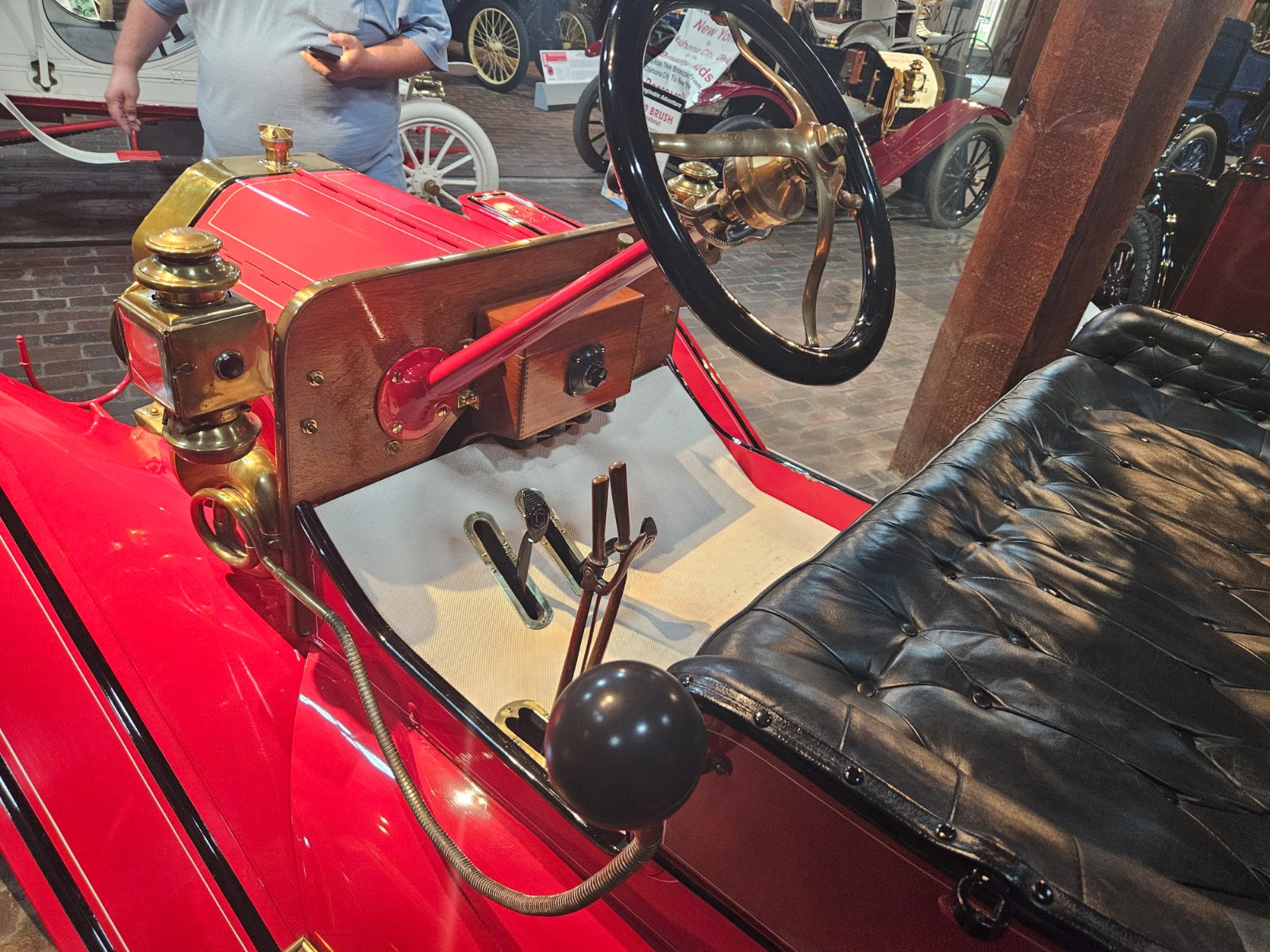

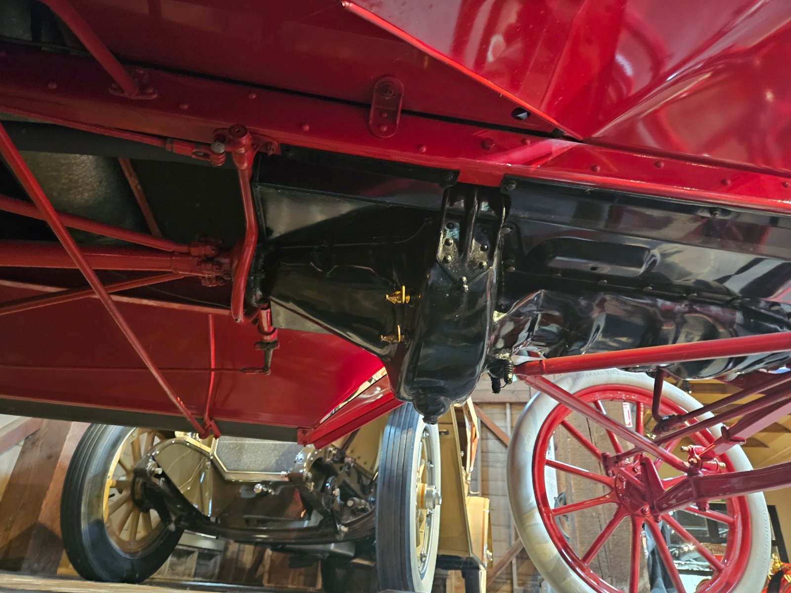

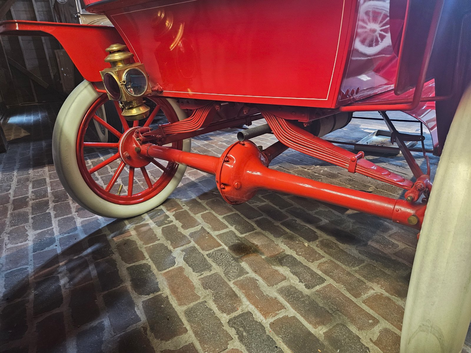

In the loft of one of the many buildings at the Gilmore is Model T Ford serial number 131. This is a two lever, water pump equipped Model T, one of the earliest known to exist today. The tires are covered by vinyl covers intended to reduce the graying effect of sunlight on the tires. Note the linoleum covered wooden running boards with brass edge trim, a feature discontinued after the first 2499 Model T’s. The rear body brackets on the first 2499 Model T’s had four bolts as seen here and the fragile “no rivet” 1909 rear axle assembly as used on the first 10,000 cars. Notice there is not a pinion bearing housing, the driveshaft was supported at each end by a babbitt bushing. The car was purchased with no options, and remains that way today. As such it does not have headlamps, a windshield, or a top. Controls in the first 700 Model T’s consisted of two pedals, two levers, the mixture control, steering wheel, spark and gas levers.
modeltfordfix.com
1909 Front.jpg (100.39 KiB) Viewed 2647 times

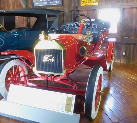

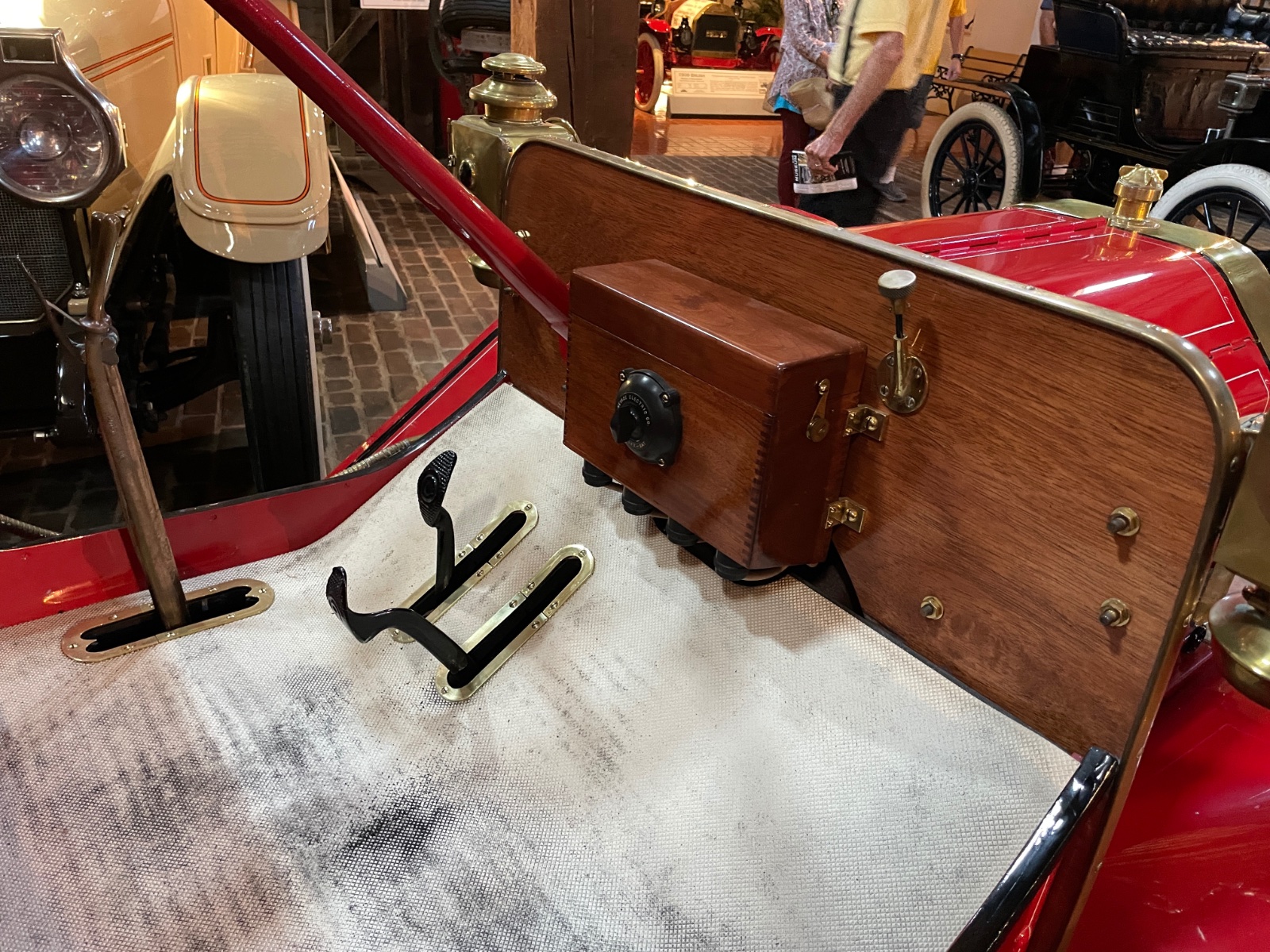

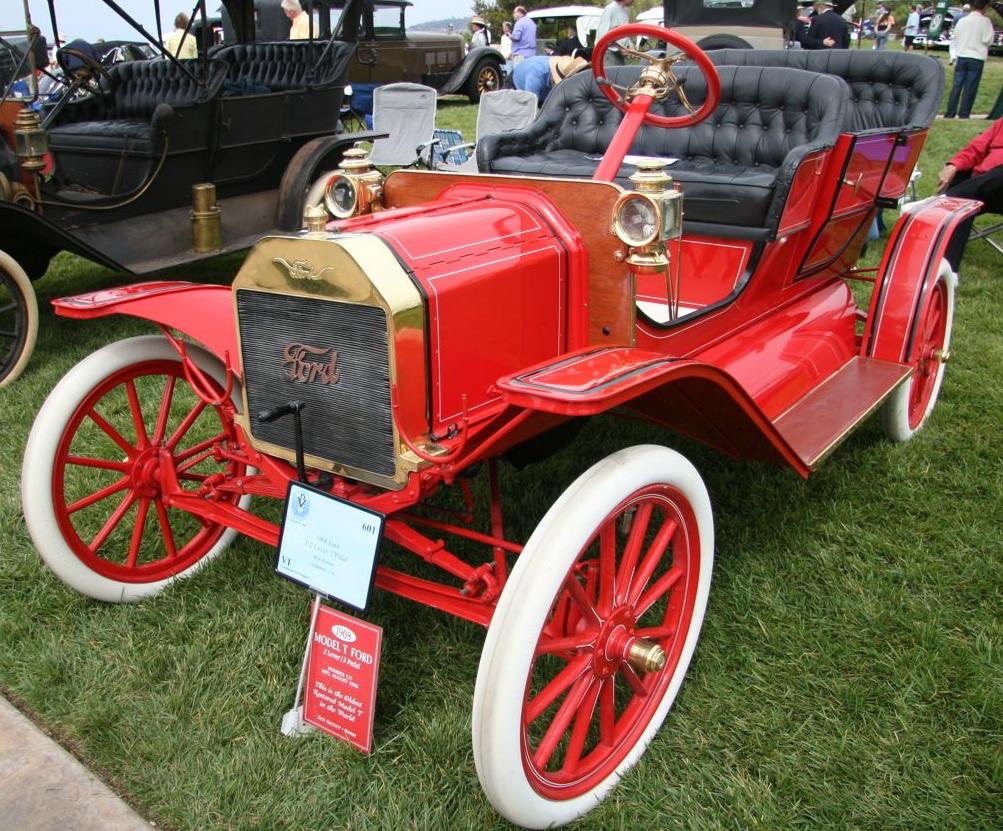

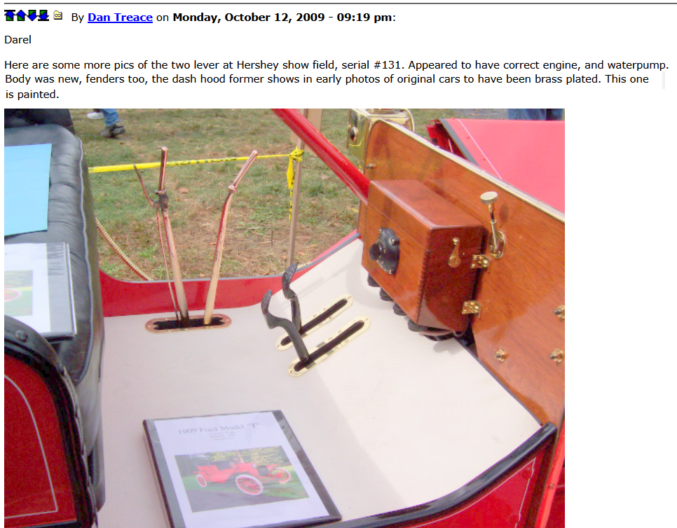

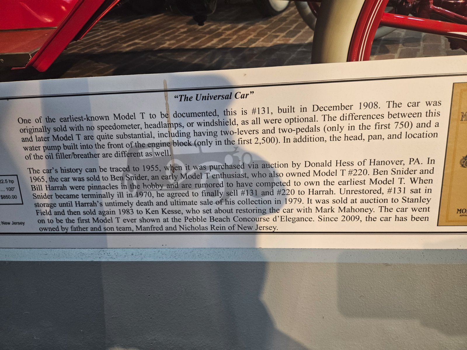

#131 was formerly in Harrahs collection, likely restored to very high standards, would believe “correct” as money could make, absent the white rubber mat, carpet protector now. ;)
#131 at Concoures DE Elegance car show in Palos Verdes, CA, 2008. Had white front floor mat then, along with a red painted steering wheel. 8-)
Aug 2022, visited the Gilmore in MI and took these updated photos of #131

I believe this car was owned by Ken Keesee (sp?) after Harrah's. When he bought the car from Harrah's, it was in very "unrestored" condition. I believe Mark Mahoney managed/restored the car for Ken. The car was part of Ken's Model T collection/museum in Orange County/Anaheim CA. Ken had a great Model T collection and museum.

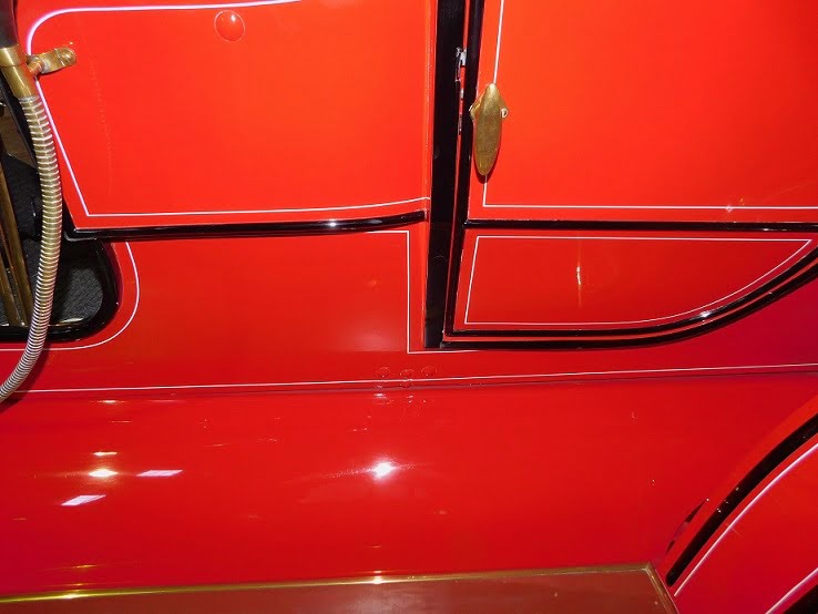

Some creative license at work here IMO. This has a post #2500 touring body, built I'm told by the late Bob Marx.
Distinct features of the 1st 2500 are lower door handle elevation as the result of earliest door latches and catch plates. Per 2500 also has a vertical black trim welt approx 2 inches parallel and rear of the doors.
Was this car not previously credited to the late Bill Hess?

Mark Mahoney is the most knowledgeable on this car. It was parted next to mine at the Palos Verdes Concourse, Mark drove it onto the field and it ran well. I have quite a few notes on this car, but I don't have any first hand knowledge. In Don Hess's little black, he is listed as the owner at one time, then Harrahs auto collection then to Ken Keesee. I believe it was then sold to the current owner in NJ.

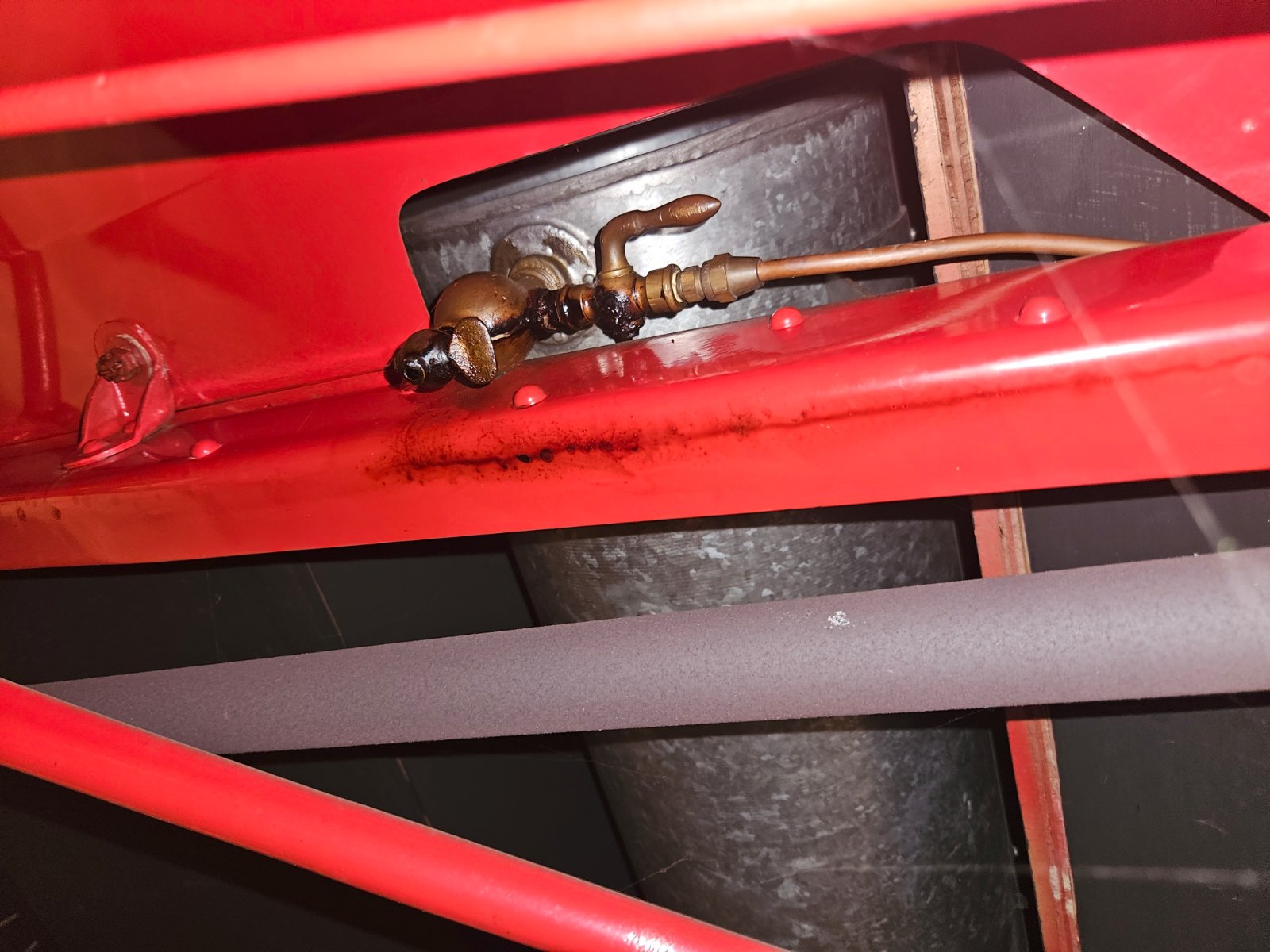

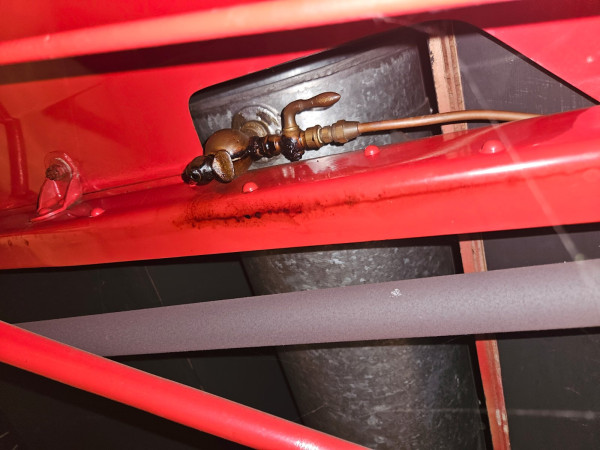

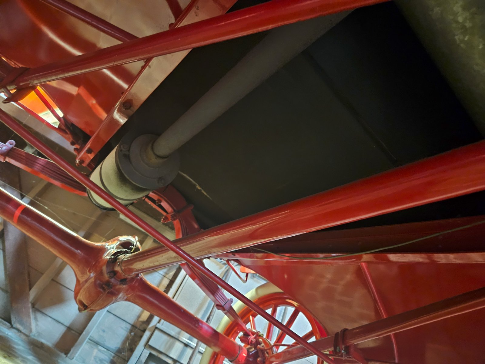

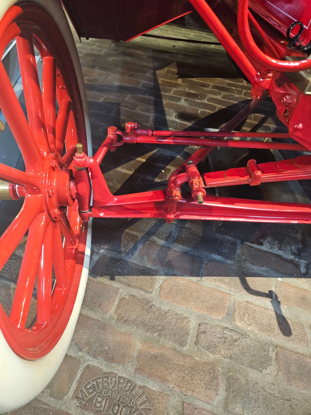

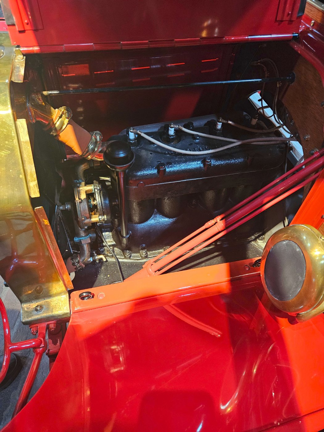

I had the chance to look at 131 a couple years back. I was bold enough to carefully open the hood and got a few pictures of the left side of the engine. I slid under the car and took some pictures there too.
I'm traditionally an Early V8 person, but T people and T tours are too much fun to miss out on.

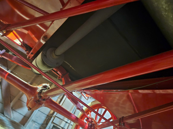

Post by 38 coupe » Fri Nov 21, 2025 10:04 pm
More pictures of 131
Back in the day as they say....me wonder's just how often that grease cup for the drive shaft bearing was properly and adequately greased.

Post by 38 coupe » Sat Nov 22, 2025 11:57 am
Trying again for more pictures

Why would anyone paint a steering wheel red?
Posts: 8626
Re: Is this 1909 Touring "Correct"?
Post by TXGOAT2 » Sun Nov 23, 2025 1:46 pm
I wouldn't, at least not on a T. Some early 1928 Fords had a red steering wheel which had a reputation for turning the driver's palms red.
