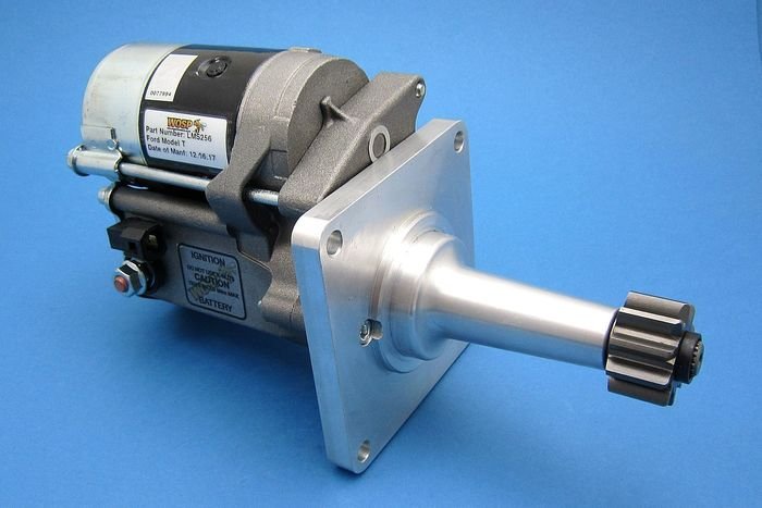

I converted to 12 volts some 35 years ago when I just couldn't find decent 6 volt batteries and issues with the T generator. . I also installed a late Ford Autolite generator modified to fit the T mount. These aren't being made any longer. When Larry Becker started selling his modified Delco 12 volt starters, I changed over to them in both cars. I have had very good luck with both. The only continuing issue That I have had with 12 volts is the bendix spring. I have broken and deformed many, even with the Becker 12 v starter. I now use Model A bendix springs. They are heavier and handle the 12 volts force much better. I do have to be careful with the two bolts that hold the spring on. I usually have to grind the heads down a bit to clear the cover. If I were to build up another starter T, I most likely would stay with 6 volts.
- Posts: 2339
- Last Name: Juhl
- Location: Thumb of Michigan
Re: 12 Volt
My 1917 Touring was not built with a starter, generator, battery or electrical system. I decided to install a 12 volt system primarily because 12 volt accessories are readily available, 6 volts not so much. I started out with a rebuilt 6 volt starter but had problems, mostly with the Bendix. Five years ago I installed a WOSP LM256, geared starter designed for the Model T by the legendary Tuckett brothers of England. It is available from Snyders, pricey, (tariffs?) but in my opinion worth the cost. It's geared and the gear engages from the front, so it can be removed without damaging the magneto. I like the fact that it first engages the ring gear and then spins, which means less wear on the ring gear teeth.
I ran a 4 AWG copper cable direct from a compact Odyssey AGM battery under the back seat to the starter, not needing a foot switch because the starter has a built-in solenoid. I've mounted a key switch below the steering column. I ran a wire from the (+) terminal on the starter to a terminal block and distribute power from there. I've installed LED's in the headlights and LEDs in the Kerosene lamps plus a couple of magnetic mounted brake and turn signals. I'm able to keep the battery charged with the output of a Regan "Hot Shot" charger, which converts some of the output of the magneto to DC to charge the battery.
Each of us gets to choose what'll work best on our Model T's. I've been very happy with my choice of 12 volts.
WOSP LM256 Geared Starter

When I built our 1922 coupe, I installed both 12 volt WOSP LM256 starter and the WOSP alternator in the car.
Both have been trouble free. I wanted 12 volts because I wanted REAL headlights you could see with at night, and a GPS to use when navigating on Model T tours.
If you are actually going to drive the car at night, you can't beat 12v halogen bulbs. I have headlights as bright as any modern car.
Likewise, I put hydraulic disk brakes on the rear wheels. Yea, it don't look stock, but after having the feces scared out of us on steep mountain roads on tours in Tennessee, all take safety first over the purest doctrine any day....
But as the saying goes, it's your car, do what you think is best. my T's are not winners of trophies for originality, but I could care less.
