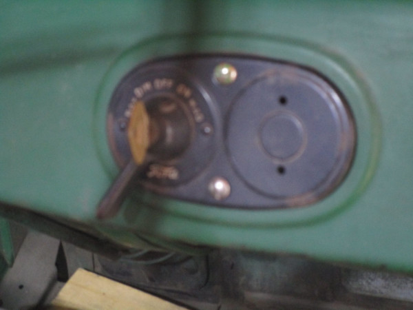

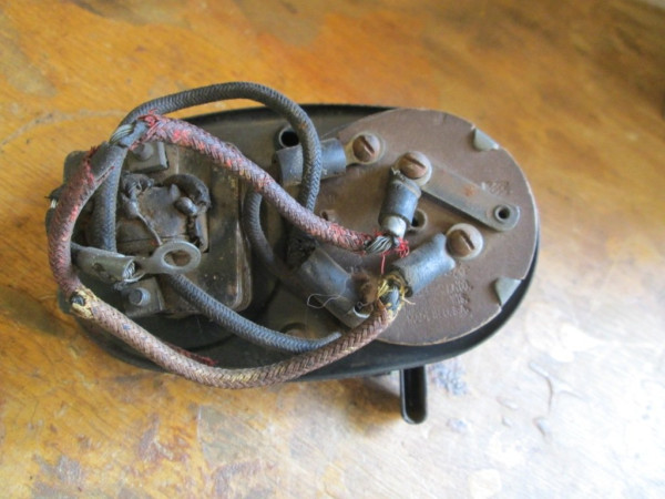

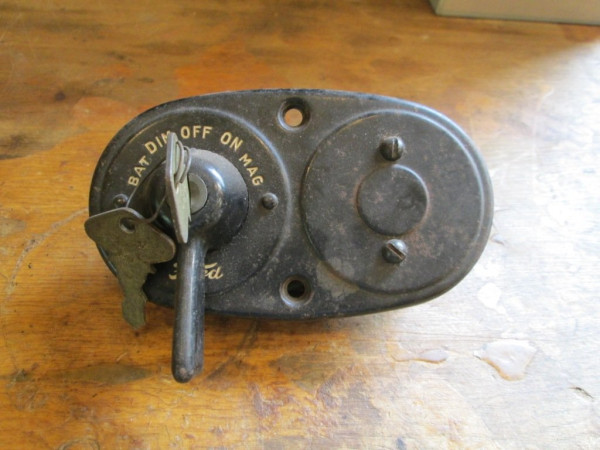

I thought I would add a picture of the 1926 non electric start switch, not often seen.

Post by micshotrodgarage » Wed Nov 26, 2025 9:03 pm
1927 non starter dash

Very nice !!

Here's a NOS non-starter switch showing the dimmer resistor - it's going over to the classifieds.
