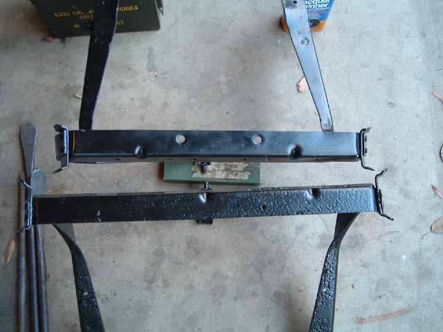

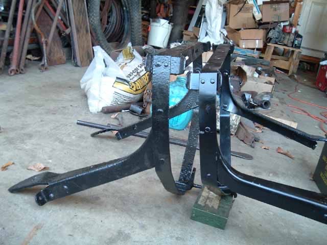

The shiny painted carrier is the ‘25 version for the split rim 21” tires. Note shorter top arms.
The pitted is ‘24-‘25 version for clincher rim 30” tires.
Posts: 5623
Re: 1917 spare tire mount
Post by RajoRacer » Fri Dec 19, 2025 9:34 pm
Note regarding the 21" carrier shown above - the top bar was double hole stamped to receive either LHD or RHD tail lamp wiring.

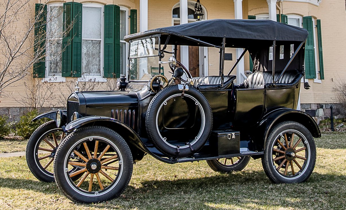

This is what I did on my '17. There's no driver's door so it doesn't block anything important. A friend welded up a cradle for me and I made a top mount from a flat steel piece. Leather straps hold it in place. I have plans to install a small rack on the back (where a spare might go) to haul chairs and such on tours. It's interesting how little storage a touring car has :-)
