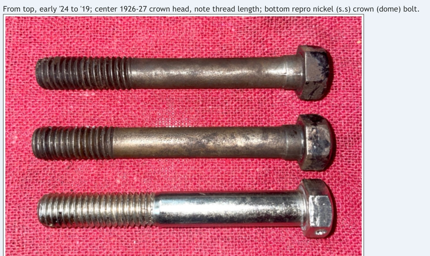

Yes on re-using head bolts that check out in great shape, inspect threads carefully. Just be aware new reproduction of the dome nickel 26-27 style are modern thread type and a tad shorter in length.
If the block threads are super good, the repro work, if block threads at the grip range are poor, those shorter can spin out. Learned that. Salvaged that one hole by using longer store bought grade 5 bolt.

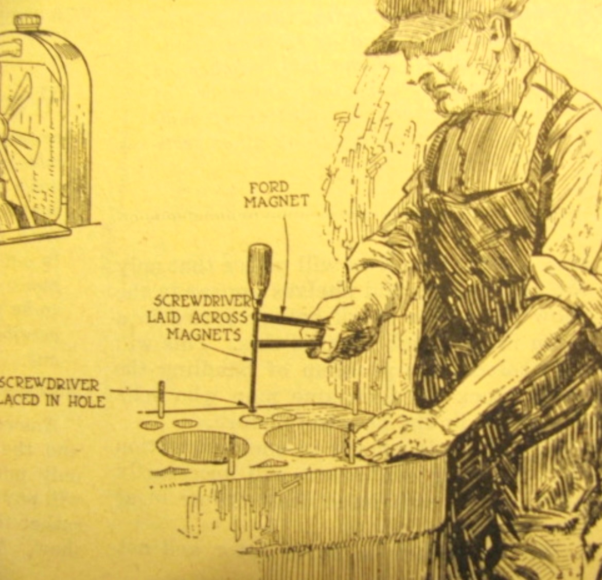

Old timer mechanics just used a screwdriver to stir debris deep in the bolt hole, and remove that metallic stuff with a Ford magnet against the shank.
