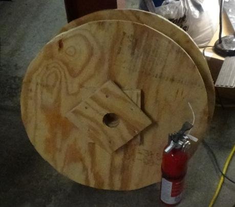

you may be able to cut circular disc from 3/4" plywood and screw these to the existing rotted spokes to make a rolling assembly ... the trees and other obstructions ...a chain saw or crosscut and good helper ... good luck and Happy New Year ...gene french

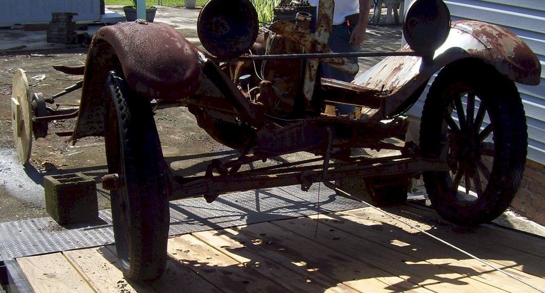

Josh, you say you would be afraid to roll wheels without rims in the yard for fear of cutting up his yard. Where you are you must have gotten plenty of rain or snow to make the ground that soft. Here in central Texas, my yard is so hard and grass is so dead, I can drive my F-150 on it and not leave a rut. If the guy wants it out of his yard bad enough, he shouldn't be upset if you leave ruts, and I think you said that you couldn't get a vehicle to it to pull or tow it out. If that's the case, wouldn't the chassis be to wide to clear obstacles when rolling it out? If the chassis will clear, put the 2 21" wheels on the front and borrow 2 more from someone for the rear. Worst case, drag the chassis out by lifting the rear and dragging it on the front wheels. Maybe a small tractor, even garden tractor size would be able to pull it out.

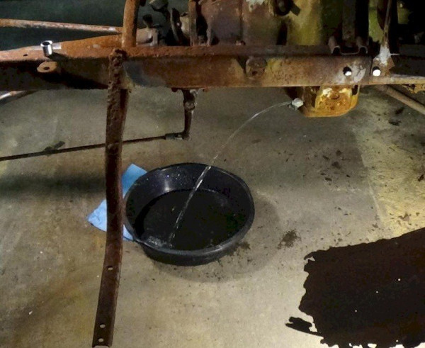

The water may be condensate. The engine may be OK, especially if there is any oil on top of the water. If the transmission isn't a mass of rust, the engine probably isn't either.

If the inside of the transmission looks "as good as new" then it is probably salvageable.
When the water gets in it starts to collect at the bottom (drain plug) then as it says in there longer it starts to rust the parts all over inside the engine.
The oil on the engine parts protects them, for a little while.
I have seen engines stuck for as little as one valve stuck stopping it from turning over.
It's always a gamble but looking good on top is a great sign.

Never give up! There is hope. We are driving this engine that had water in it from Hurricane Katrina and another flood.

Update on the old chassis
I finally got a little time to make a serious attempt at moving the old chassis. Fortunately, I had found a good set of wheels and tires so that fixed one problem. Like I said previously it had sat there long enough to completely rot away a set of wheels and it took a little to dig out and get it jacked up enough to remove the old hubs and stick on the wheels. I never found any help so I just took my time and over two attempts I succeeded in rolling it to a area that I could get a vehicle to it and brought it home.
Last night I sprayed everything with penetrating oil and removed the oil drain plug. There was no oil, just water. This morning I started out by removing the manifolds. They were full of nuts and insect nests and all manner of awful. I can't figure out what animal is small enough to get a nut up into a manifold. Next I removed the valve covers and it still looked new inside. That gave me some hope so I removed the head. Each cylinder was completely different; #1 was full of dead spiders because the valve was open. #2 looked good. #3 was full of water and #4 was okay. I cleaned them out and dried up #3 and more penetrating oil. I filled the crankcase with penetrating oil and motor oil mixed and let it set for a few hours. Then engine was still not moving at all so I found a stick of stovewood the same diameter as a piston and dropped it in a cylinder and then took the back of an axe and started pounding on the block, moving it from one cylinder to the next. Finally, I struck the block and saw the crank handle bounce. I added more penetrating oil and came back to it an hour later. When I came back, to my amazement, it turned over. After a few good turns it was turning over with nearly no effort. Mechanically, it looks like the old neglected engine is basically fine in spite of being full of water for who knows how long and being half buried in the weeds. After reinstalling the head it seems to have good compression so the next step is to try to track down some cheap used ignition parts and a radiator and try to start it.
I need to get a wire brush and double check the serial number because it may be older than 17. I know that it is 390,000 and something. I am almost certain that there wasn't a number before the 3 but the block was painted and possibly covered a first number. If it turns out to really be the early number I will let you know.
