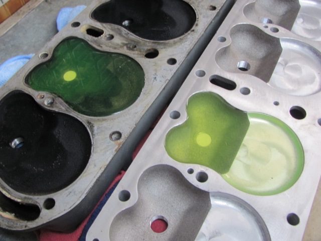

The Prus head is still the best one to use for performance, have used both, and prefer the Prus. The chambers are CNC matched machined, the Z is as cast. The Prus is also pressure sealed like modern alum heads to resist material corrosion.
Did my garage cc'd method, and the Z had 250cc chamber, and the Prus 210cc chamber, so its a bit more that makes a good difference IMO.

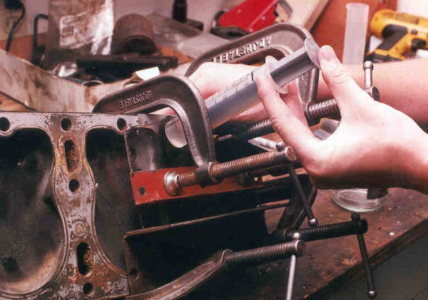

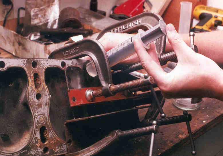

I agree the machine work on the Prus head is good but I object to the false advertising. Your measurement method is prone to errors since a small error in the fill height can easily give 10-20 cc error. You might try the method in the photo using a plexiglas plate. I measured 203cc on a Z head.

I use the plexiglass sheet method.
I found closer volume readings. Z=223 CC's Prus=220 CC's

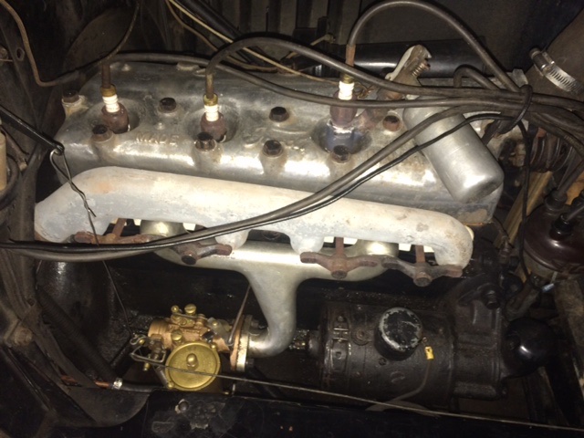

Re: Z head
As it happens, I have THE Jensen aluminum head that Kevin Prus used to make the mold he uses for his castings. I had a few thousandths milled off because it was warped but it’s been on my car for several years and it does run better than the Z head. And it has the Ford script on it !!

Re: Z head
No none of that, it just pulls better. With a Ruckstel and 3:1 gears, it’s noticeable on hills.speedytinc wrote: ↑Fri Jan 02, 2026 3:05 pmBy better do you mean smoother? that could be the result of the Z'z varying compression among the cylinders.Ruxstel24 wrote: ↑Fri Jan 02, 2026 2:59 pmAs it happens, I have THE Jensen aluminum head that Kevin Prus used to make the mold he uses for his castings. I had a few thousandths milled off because it was warped but it’s been on my car for several years and it does run better than the Z head. And it has the Ford script on it !!
Is there a noticable HP difference? Have you CC'd or done a compression test? That would provide some comparrison #'s
To be fair I did lap the valves, and properly adjusted them, honed the cylinders and new rings and added the OF Stromberg at the same time as it had been sitting for several years. But it runs better than before that.
