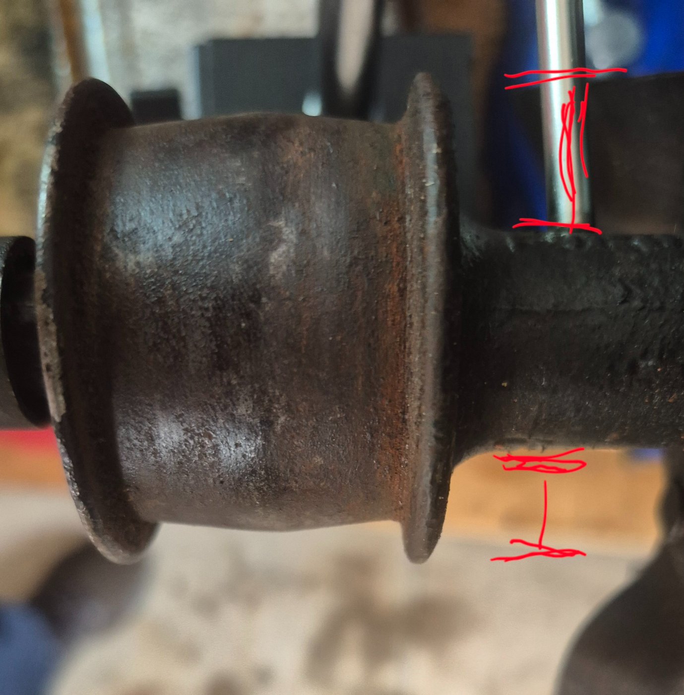

I'm trying to establish if the cam portion of my brake pedal is worn enough to warrant replacing the pedal. The pedal stroke seems to be too short, and so the band needs to be overly tightened to compensate, at least it seems that way.
The pedal supports are new reproduction parts.
Question: How much pedal free play can be considered within limits? That is to say, if you step on the pedal first, and then pull the pedal backward, how far does it move? I placed a horizontal tape measure from the firewall and measured at the center of the pedal tread (as shown in the pictures) with these results:
- Brake 15/16" (24mm)
- Reverse 9/16" (14mm)
Does anyone have similar measurements AND good, efficient action on the brake pedal?
Thanks for sharing your results.

A new bolt in pedal ramp is only half a repair. The pedal ramp itself will also be worn, and that wear is manifest in the free play you have in the pedal. You can bend the pedal back, with heat, to compensate for the travel so that it does not bottom out on the floorboard slot. The pedal ramp can be addressed when next you have the hogshead off.

Mine would bottom out (third picture) so I removed the pedal and put it in a bench vice and repeatedly struck the pedal shaft with a mallet until it gave me quite a bit more space between the floor and underside of the pedal (last picture). I documented this in a thread when I did it a couple of years ago.
