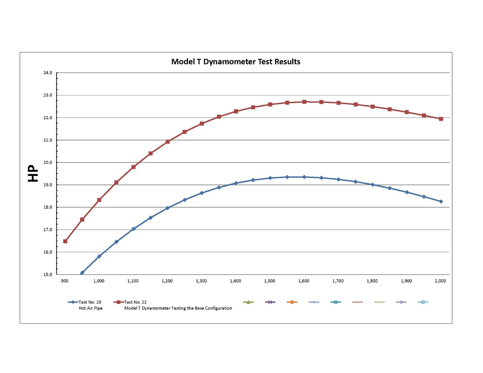

Re: Hot Air Pipe -- Necessary?
Not according to this dyno test with and without the hot air pipe!
https://www.mtfca.com/discus/messages/2 ... 1341900318
Some of the loss is due to the manifold heated air going into the engine, but the design of the hot air pipe itself, particularly on the earlier pipes, also greatly restricts the airflow. That doesn't help either.
After seeing these results, I haven't used the hot air pipe for several years. Granted, I don't drive if it is really cold, but I have not experienced running issues without the hot air pipe, and I don't want to lose that much horsepower for a device that was intended to better vaporize the poorer quality fuel of 100+ years ago.
I'm also a pilot with an airplane that has a carburetor. Depending on the temperature spread between the dew point and air temperature, you normally use "carb heat" (like you get with the T hot air pipe) when you throttle back to low power when in the pattern getting ready to land, but you don't want to leave it on all the time due to the power loss unless the dew point temperature difference is so small that ice can build up at any power setting.

Gale Banks, Smokey Yunik and other famous racers have long expounded the benefits of more air density. Superchargers and turbos are the extreme answer, but cooler air has been proven over and over to produce more power. So hood scoops and cool air snorkels to get outside (ambient) air to the carburetor rather than the preheated air in the engine compartment have been used by racers, hot-rodders, and manufacturers alike for decades.NealW wrote: ↑Thu Jan 08, 2026 3:33 pmNot according to this dyno test with and without the hot air pipe!
Some of the loss is likely due to the manifold heated air going into the engine, but the design of the hot air pipe itself, particularly on the earlier pipes, greatly restricts the airflow. That doesn't help either...
With all else staying equal, 100 deg air is 10% less dense than 50 deg air, which in turn, makes less power. We see the same thing from increases in altitude, less dense air = less power. The hot air pipe focuses even more heat into the incoming air, so the decrease in power is noticeable, even by just the seat of your pants. Mike Bender, Ralph Ricks and plenty of other heroes in this forum did the work and provided the objective proof that this is true, specifically for Ts.
All of that said, a hot air pipe can be useful today in the rare conditions that cause internal icing in the carb or manifold. And leaving one on continuously might not matter, if your typical driving doesn't exploit the full 20hp that your T engine should be able to produce. But for most of us, having one to install if the conditions warrant, could be justified. It's the T version of aviation carb heat, which every pilot knows should be used sparingly. For me, I'll take any small power improvement for my Ts, especially one that is as cheap and easy as not running a hot air pipe. If I ever experience carb icing in my T personally, I will revisit the issue then.

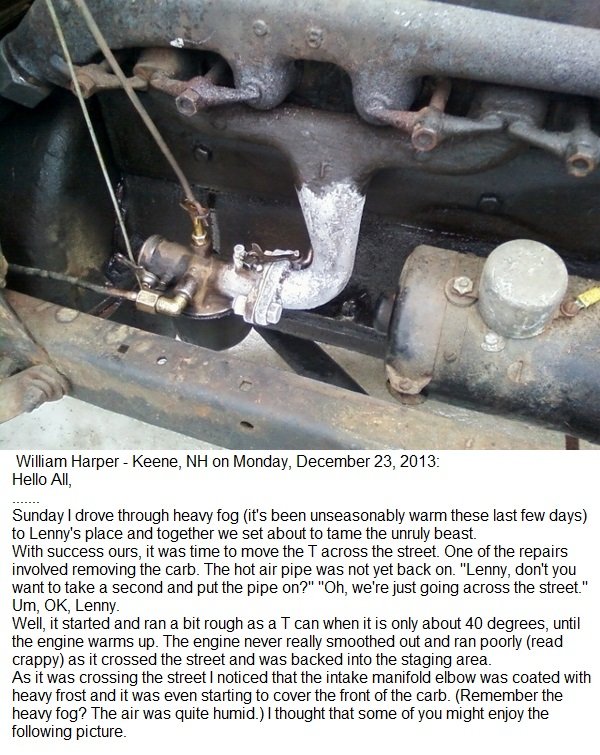

My experience - Left coast.
I had a fresh motor. Took it out for test/tuning runs & I observed the following:
No heat pipe running a warm motor, The manifold iced up externally @ the bend, same as pictured above. From about 1/2 to full throttle, the motor ran rougher with intermittent missing. Back to the barn. Put the heat pipe on & retested. No more miss, but I did lose, maybe 8% of my top speed.
On my 14, I drilled 4 1/2" holes on the back side of the heat pipe. Was a good compromise. Some heat helped her run quite well. No visible frost.
I left the pipe on year round.
