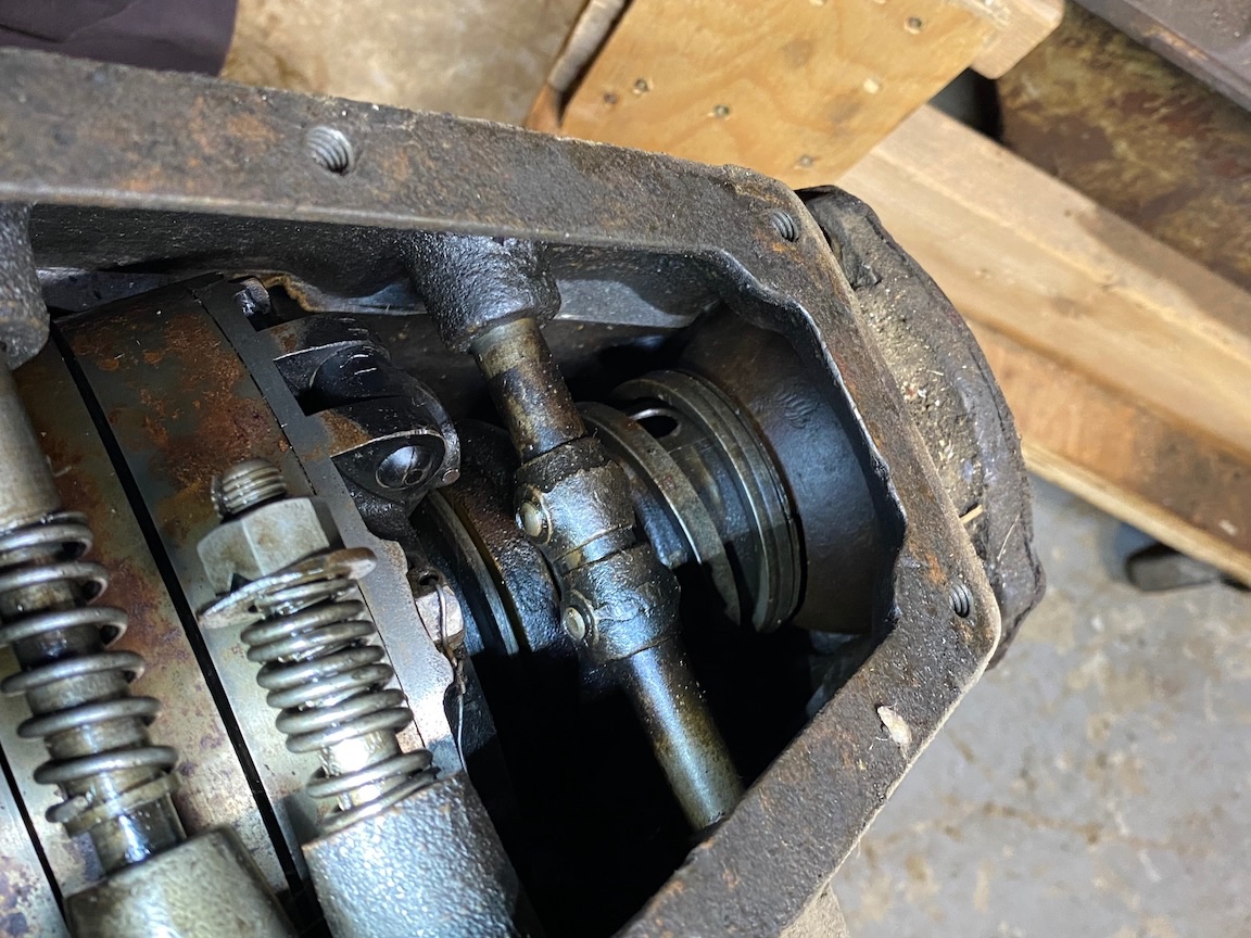

Steve, here is another photo with the hand lever back and spring compressed .
Near as I can tell, the two spring ends (yellow) are where one would expect and the spring coils evenly spaced. And, while it's hard for me to see, it appears the forward end of the spring is riding tight to the back face of the clutch collar, also as one would expect (blue arrow).
John, my assumption of roughly 1/2" clearance between spring cup and fourth main is from my '24 Speedster, photo below. Pink arrows indicate that gap. Agree the above photo looks like a gap, but in the photo below, I see a lip of sorts at the small diameter of the fourth main (green arrow) that could give the illusion of a gap. One can also clearly see the end of the pin in the cup hole, something not showing in the problem transmission.
I can't adjust the fingers to 11/16 clearance without reducing their engagement pressure to almost zero (hand lever forward).
The clutch spring height compressed (hand lever back) is 2"+/-.
All steel clutch in this car. Hand lever and bands set correctly. You and Mike are right to make sure I understand the basics before going much further, and thank you for that, but I have maintained and driven Ts for 30+ years and rebuilt a several engines as well. I'm pretty sure the other adjustments are at least close enough.
And speaking of adjustments, we should remember this was a "sudden-onset" problem — a gradual drift of adjustments is likely not at play here.

- Posts: 5096
Re: Unusual Transmission problem '26 Touring
Your 24's retainer cap has a problem.When properly installed the cup gets rotated from the pin to lock down into home. You should NOT see the end of the pin in the cup. That would decrease the gap you see by aboul 3/8". We found another problem on a different car.
There appears to be excessive spring shrink in your pix. Check all the clutch linkages.
The dimension with the fingers engaged should be 13/16, not 11/16.
The gap between the retainer cup & the 4th main on your 26 looks normal.

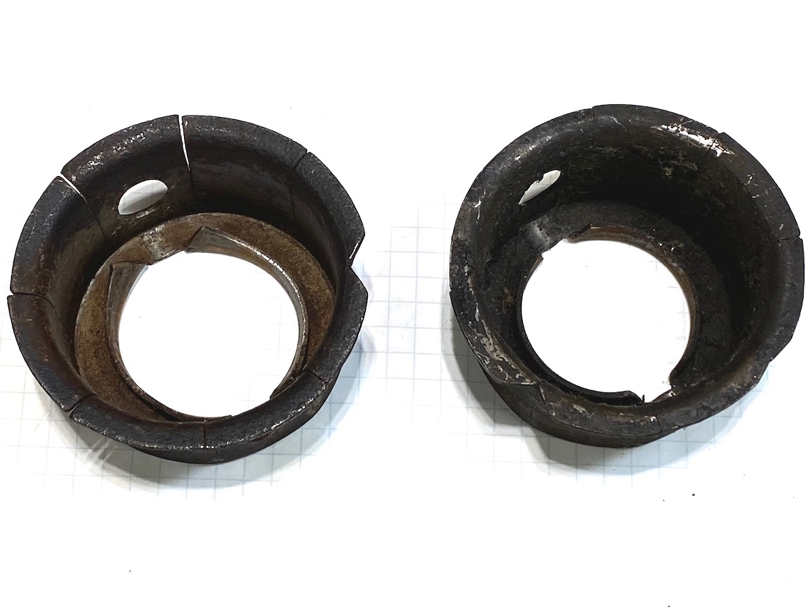

Regarding the 24. The pin goes in in the position you see then the cup gets rotated about 45 degrees to drop the pin into a slot in the cup bottom, thusly locking/capturing the pin in the cup. you should be able to rotate the cup to the proper position in place without removing the transmission. you will need to minimize spring tension.Chris Bamford wrote: ↑Sat Jan 10, 2026 4:43 pmJohn, I’m out of the garage for a while and will look into the spring cup question. Thank you.
Also I meant to say 13/16”. Good catch. I use a 13/16” flats nut with a steel rod handle as my gauge.
(added) Grab the spring & cup & rotate CCW 45 degrees. (Looking toward the rear end) The cup will pop back into locked position.
I mentioned I mocked up some loose parts. There is very little gap (1/8') between the cup & the 4th main with the cup pin in the correct place.
That extra gap is definitely from the cup pin riding out of position on the inner cup flange.

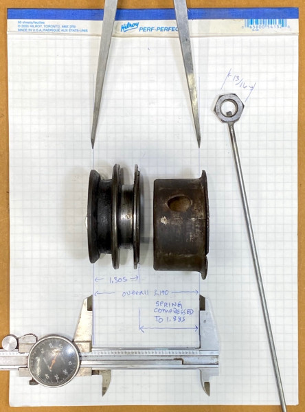

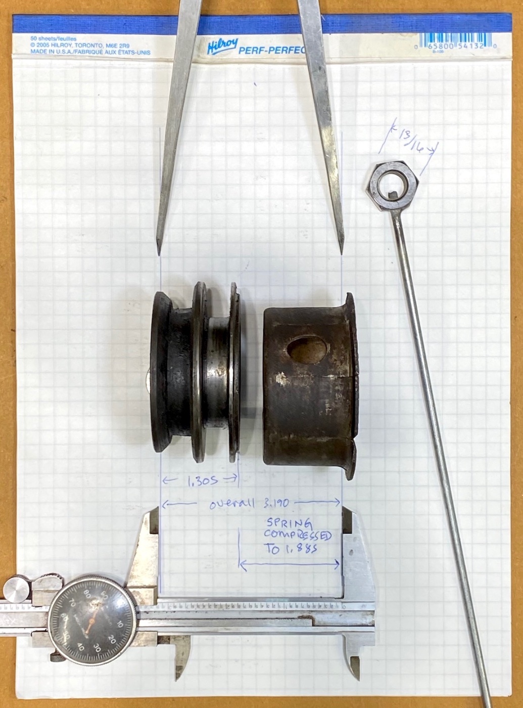

OK so: a good sleep, early out to the workshop, fresh coffee and time to mull things over in light of these discussions...
I somehow got open the wrong track with spring measurements and some general understanding of the mechanisms. This was reinforced by the sudden-onset nature of the problem and the way my '24 Speedster looks ahead of the fourth main.
In reality, the extended spring length (lever forward) calculates to 1.885", and my finger clearance is well above 13/16". So I have more adjusting to do here before pressing the panic button again.
Not sure I'll get back to the car today, but the next step is to start over, reset the fingers and double/triple check the finger clearance spring length.
Obviously.
I'm surprised nobody thought to suggest that yesterday...
_ _ _ _ _ _

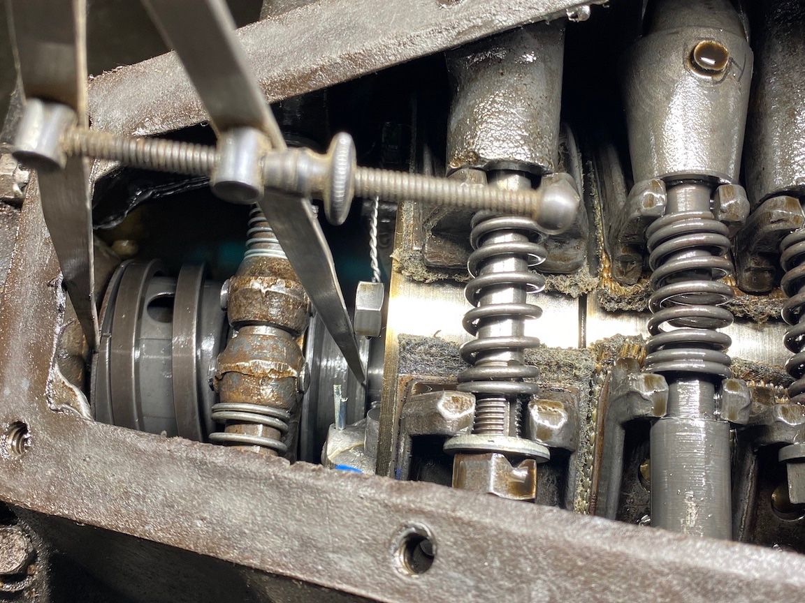

BTW, I don't know how people measure spring length directly, it is awfully tight in there. Photos 1 and 2 below show my method of indirect measuring for the spring cup to the finger flange, less the length of the collar to the spring seat.
Photo 3 is my spare engine with the same next-to-zero clearance from spring cup to fourth main. Just like y'all said.
The big cup-to-fourth main clearance in my speedster remains an outstanding question. It could well be the spring cup is out of position. What threw me off was assuming the pin, when seated, is in line with the cup holes (no 45° twist required). Photo 4 shows the two spring cups I have in my used parts — both of these the holes and the pin seat are aligned. Are there other configurations for this part?
Thanks to John and Mike who took such an interest and helped me get back on the right trap. Very much appreciated. I'll post an update soon.
