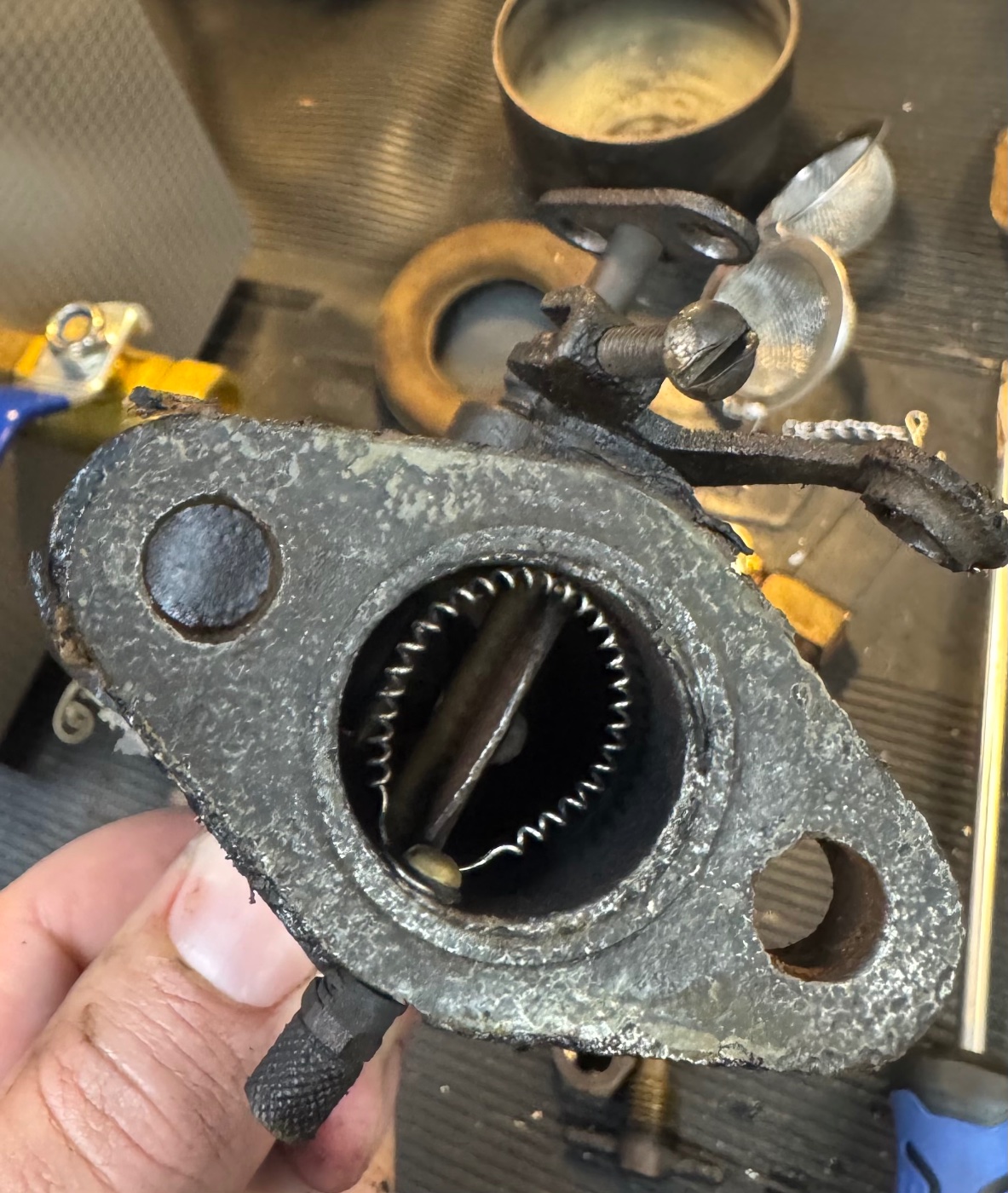

Post by George Mills » Sun Jan 11, 2026 5:15 pm
This is the first time the carb has been off in 30+ years.
It’s an NH
What ‘magic’ was it supposed to do ? ( the coil spring)
Thanks in advance….

Re: I’m stumped
Post by John.Zibell » Sun Jan 11, 2026 5:22 pm
Increase turbulence for supposedly better air/fuel mixing. My help, probably doesn't.

Re: I’m stumped
Post by Dan Hatch » Sun Jan 11, 2026 5:39 pm
Not an NH . Simmons or Wizard. That is a heater.

Re: I’m stumped
Post by Daisy Mae » Sun Jan 11, 2026 5:50 pm
+1 on Dan,
Sure looks like a rudimentary pre-heat unit to me

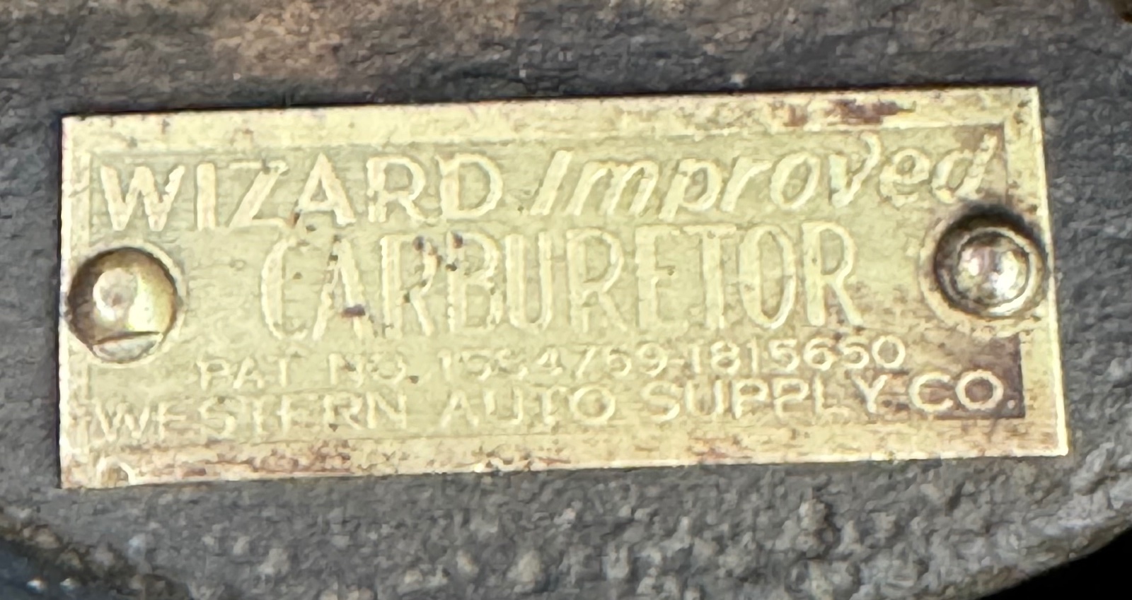

George Mills
Posts: 646
Last Name: Mills
Re: I’m stumped
Post by George Mills » Sun Jan 11, 2026 6:20 pm
Thanks,
Son checked closer, found nameplate—-is a Wizard —-lol
Must have been a good carby…never an issue in my 29 years of stewardship! He just thought to rebuild it ‘just ‘cause’ as part of his stewardship.

Re: I’m stumped
Post by speedytinc » Sun Jan 11, 2026 6:52 pm
That is a heating coil to vaporize fuel. Battery power gets connected below that long knurled nut. Close to the carb bottom. There are insulators to route power thru the long screw, grounding the other end of the spring to the carb.
I have not seen any direction as to weather the power is on constantly while running or not. I suppose the power connection would be taken
from the ignition for starting on BAT then be off when the ignition switch diverted to run on MAG. Then the spring acts a turbulence device.
Posts: 8636
Re: I’m stumped
Post by TXGOAT2 » Sun Jan 11, 2026 6:55 pm
The springy thing is most likely an electric "fuelizer" or pre heater for cold weather starting. It appears to have a terminal on the bottom of the air horn. The driver would push a button or flip a switch to apply battery power to the resistive heating element. I don't think it is original to the carburetor. It may be in the 1927 Western Auto catalogue on the Cimorelli site.
Posts: 8636
Re: I’m stumped
Post by TXGOAT2 » Sun Jan 11, 2026 6:57 pm
I'd think you'd want it off once the engine started, and having it on for more than a second or two without cranking the engine might allow it to get hot enough to ignite any gasoline in the carb throat. Neat item, and useful if handled properly.

Re: I’m stumped
Post by speedytinc » Sun Jan 11, 2026 7:06 pm
That heater is original on all the variations of that carb I have & have seen. Many have had the heating element removed & the hole plugged, but the hole remains. Wizzard, Simons super power, Duplex, Western auto?, maybe one or 2 other names for the same carb.
I am curious as to the carb's performance.
How do you or any other users feel it performs compared to a NH swayback or NH straight thru?
Posts: 6790
Re: I’m stumped
Post by Scott_Conger » Sun Jan 11, 2026 7:29 pm
Definitely better than swayback NH and better than straight-through in that it takes very little choke or cranking to start. Like an L-4 (but without the L-4 poor fuel mileage) it uses a flapper to divert air through an idle bypass circuit until some speed/air volume overwhelms the flapper and negates the richness of the idle circuit at higher speeds.
Definitely worth the effort to locate one and use it if it's complete.
The NH float valve fits it, the NH float fits it, and a couple NH gaskets fit it, and that's it...all other parts are unique and though they look similar to NH parts they are not the same so you have to be very careful to be sure you're not buying something that is cobbled together with mis-matched parts.
Finally: DON'T LOSE THE THROTTLE AND CHOKE FLAP SCREWS. They are 4-36 (uncommon thread) round head machine screws and not an easy item to find or replicate

Re: I’m stumped
Post by John kuehn » Sun Jan 11, 2026 8:21 pm
Can’t the Carb be taken apart if necessary to repair? From the picture it looks like the heater spring could be removed and be put back together. Is there an insulator gasket of some sort where the flapper shaft goes through the bottom? Others more knowledgable than me would know. If nothing was broken on it or leaking replace the gaskets and that’s it. Consider it a learning experience. Maybe clean out the small passages if any?

Re: I’m stumped
Post by speedytinc » Sun Jan 11, 2026 8:54 pm
The flapper shaft is horizontal & parallel in front of the choke shaft. No gasket or insulator involved.
