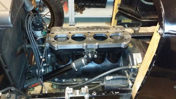

Would agree likely a magnet keeper made of steel with thin sharp edge slipped away and tore that narrow gash. Esp. since bent edge of pan was forced outward.
More simple and direct way, can't really do short cuts is to remove the Ford powerplant as the engine was named in the day. The pan is the foundation, and all of the short block and trans cover have to be removed to fix the pan.
One man job with the tools, a cherry picker, lift eyes, and follow instructions in Ford Service Manual. Remove all wires and attachments (exhaust, fuel line, or manifolds, plugs, wiring ) to the engine, unbolt steering column bracket at frame and dash, push up out of the way. Detach universal , remove engine to frame bolts (pair each side), detach wishbone at base of pan, remove front spring / pan cap which releases front of motor.

IMHO, I would not bother taking the HH off first.
Something flung. Surprising you didnt hear the BANG. Even if its a lone magnet keeper, the transmission has to be removed for access around the field coil. Not to mention the carnage to the field coil & a careful check of ALL the other magnet keepers & magnets.
Yes, the motor is lighter, but, you would certainly reassemble the motor completely on your engine stand & re-install with the HH properly fitted with the 4th main & sealed in place. The power plant goes back in as a COMPLETE unit.
See the picture Dan T provided.

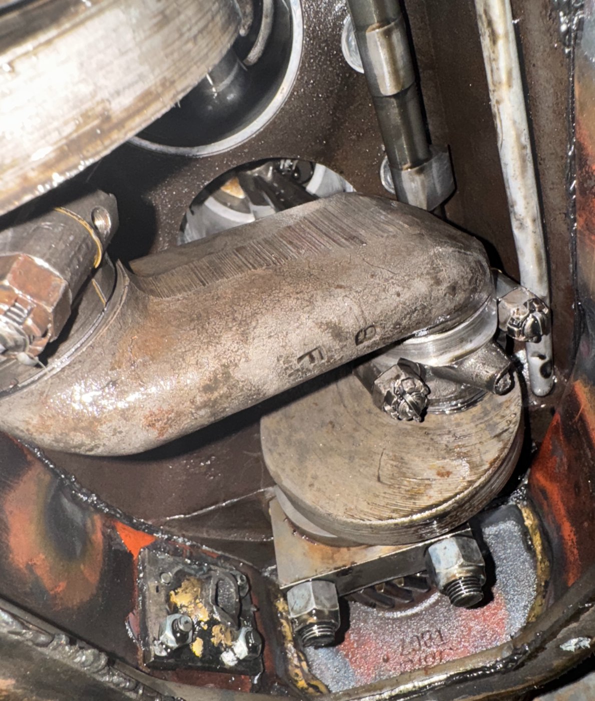

Yes, you must remove the engine/transmission as a unit. Don't waste your time on mental gymnastics trying to figure some other way. If you're able to see what that takes simply by observation, go ahead. If you need directions, follow the shop manual. With the engine attached to a stand and the nose aimed down, you'll be able to examine the works and find the trouble. You won't do all this in an hour or two. There are a lot of steps. Don't be intimidated. Many thousands of people have done this job. It ain't rocket surgery.
