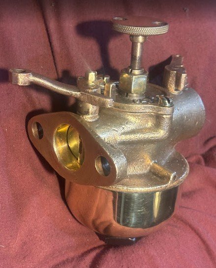

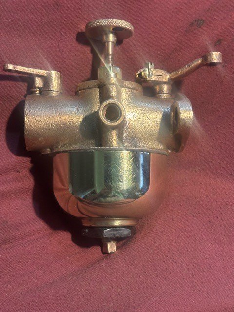

A follow up to my original post about the Holley S carburetor that came on the early 1914 that I picked up last summer. I decided to have Corey Walker refurbish it instead of my original plan of replacing it with a spare Holley G that I'd put on it when the carb gave me fits last summer. He found that the original float had been coated with some kind of sealant and was also misadjusted on the float height, both likely contributing to my starting issues due to flooding.
He made a new float for it and refurbished it as necessary. Here are some pictures of the results. See the first post for how it looked initially. Pretty, pretty!
