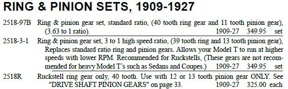

Alright y'all got a real good one for you. let's say someone wanted to drop the rpms in their T at 40 mph
without installing the steep 3:1 gears and wanted to have say a 3.33 ratio. the 12 tooth pinion is meant to be used with a Ruckstell ring gear.
i'm wondering if it is possible to use a Ruckstell 40 tooth ring gear on a standard Ford diff. yes it has a recess in it but the 12-tooth pinion is also larger in diameter. theoretically it might bolt in with the proper shims. so that's my question for today. it seems logical but i want to know if it can be done

I was just reading through the Lang's catalog yesterday and wondering the same thing. So chimed in to follow along.

There is to much recess in a 3-1 gear to use a 12T pinion. A shim of about .090" is needed to get the mesh.
With that there is a higher risk of shearing the bolts.
Back to the original problem that is not a problem. 40 is a mild & comfortable cruising speed for a model T with stock gears.

See these
https://www.mtfca.com/discus/messages/7 ... 1500352727
https://www.mtfca.com/discus/messages/2 ... 1344380034
and this old catalog snapshot Yes, you can play around with the gear ratio, it has been done since T's were new.

As an aside, it is not good practice to add shim/s between the ring gear and carrier. Any shim fitted introduces another interface to allow movement between components. Adding shims behind the steel washers either side of the bronze thrust washers is a different proposition, as those components are not driven under load.
The same applies to rear axle hub shims. If you have to fit a shim, It is far better to fit one .010" shim then two .005" shims.

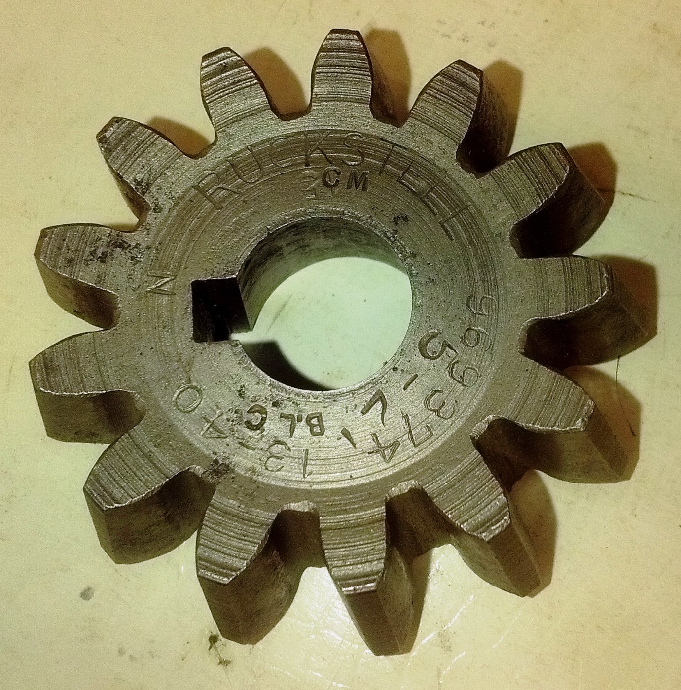

I would guess Ruckstell made ring gears for their rear ends, but have never seen one. What would have been the advantage?
- Posts: 5592
Re: Ruckstell ring gear in a standard ford diff
They did, Larry - I'm running two w/Ruckstell gear sets.
- Posts: 8642
Ruckstells were installed in a variety of cars & trucks for a variety of reasons. The range of ring & pinion ratios offered were aimed at allowing customers to get the best advantage from their particular installation, be it a roadster owner looking for speed, or a fordor owner looking for better hill climbing and braking, or a trucker looking to better adapt his TT to his situation. An owner in Kansas would probably benefit from a different suite of ratios than an owner in Colorado would.

As compromise, a standard rear axle can be fitted with a 39 tooth ring gear and a 12 tooth pinion, giving a 3.25 to 1 ratio. This is a fair compromise for a lighter car, without the serious compromise to the braking efficiency of the original Ford transmission brake.

Going thru my Ruckstell parts and found a 13 tooth pinion gear marked Ruckstell. Didn't want to post before because couldn't remember if I had a ring or pinion gear.

Ruckstell 13 Tooth Pinion:
