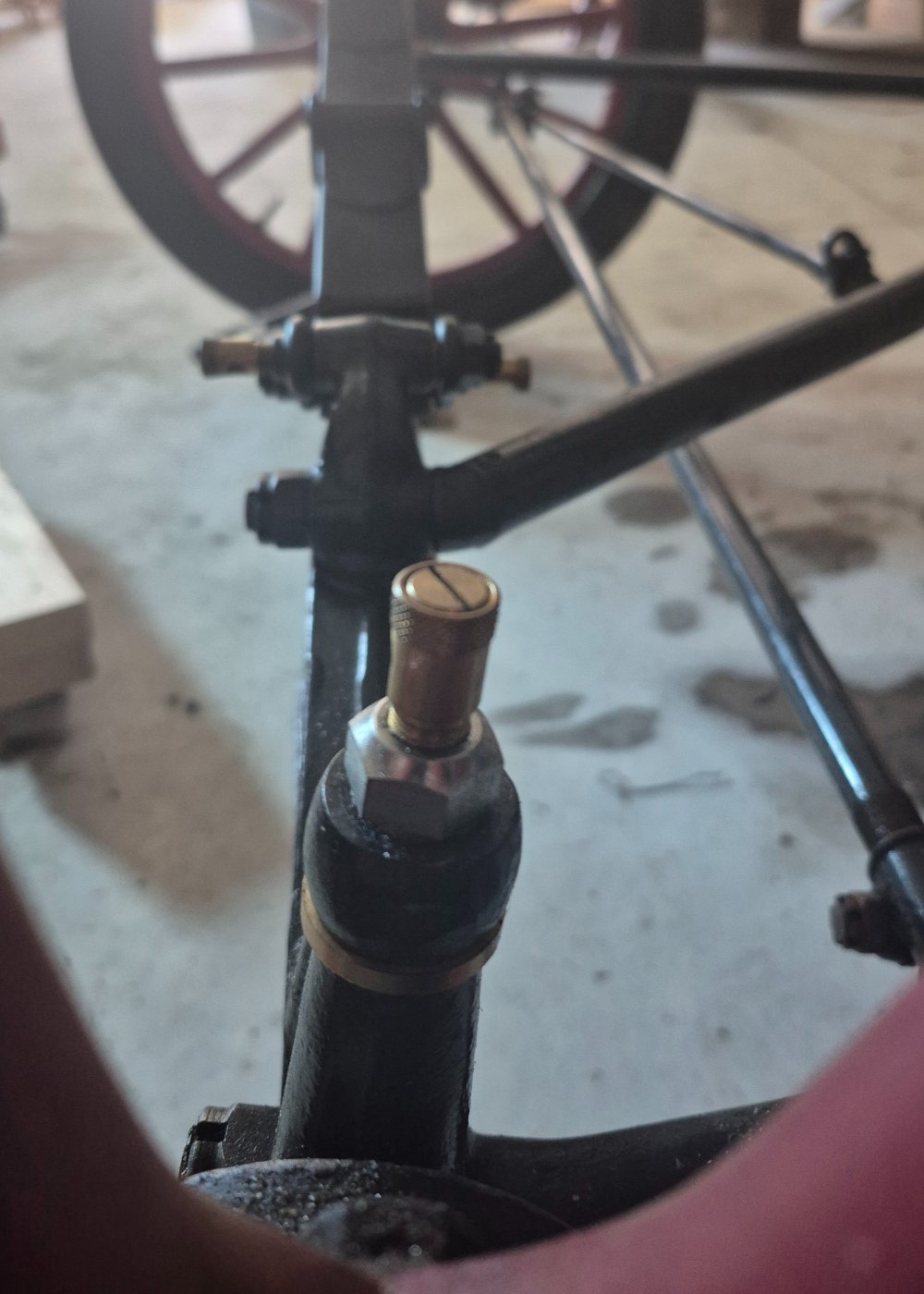

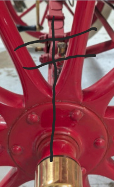

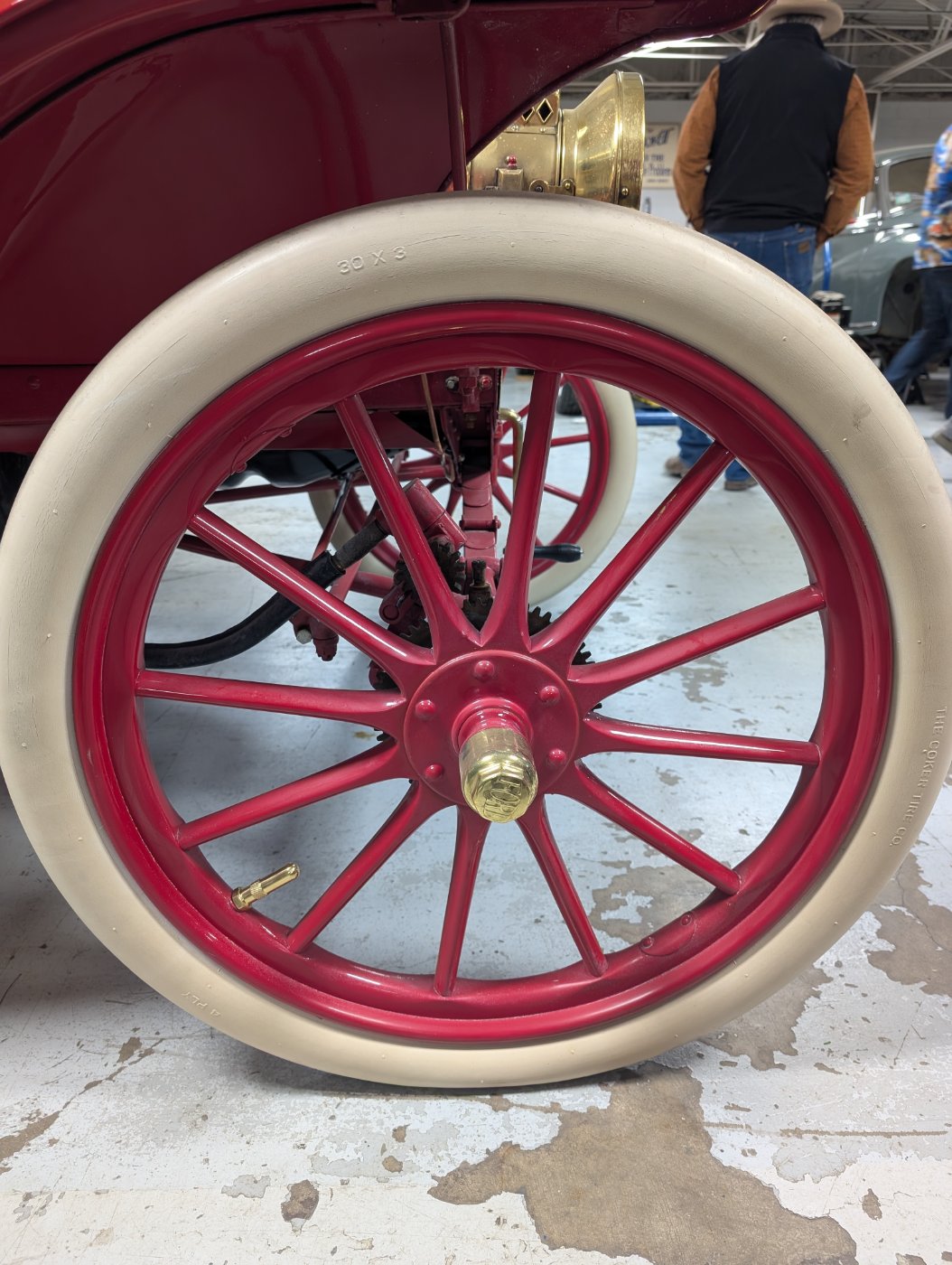

I have here pictures from left and right of a 1909 front axle. As you can see there is no caster to the
front axle. I have a friend who also has this problem on his 1912 Model T.
Is this common on the earlier cars? Is it due to the wishbone being bent or on the upper side?
Should I just find a way to bend it and add a second wishbone?
Do I need new perches?
Thank you.
Thank you.

Dave , turn your axel around .\
Toon

Dave,
I think Toon is right.
The Spring ax and the wishbone ax are even.
The angle to the front is on the lower side of perch.
I think you perch on the left side should be on the right and your right perch should be on the left.
Andre
Belgium

Dave, the first picture looks like there is some positive caster, just not very much. This would require twisting the axle (top of axle rearward) to bend the wishbone to the Ford spec of 5.5 degrees.

It may be that the wishbone is upside down? I have seen this a few times on brass era Ts, There may be a bit of angle built in, a slight tweak up where the front pin fits into the perch. Other than that, the early wishbone has no obvious up or down. I have seen several cases where flipping the wishbone over fixed the problem.

Definitely the perches are 180 degrees out. Just Sayin as Toon stated.

There is some sort of issue with the geometry of the front end of that car.
It is supposed to be a straight line from the frame, through the spring, through the perches, and through the axle.
That car has a very jagged line and this will produce a binding suspension and a bad handling car, possibly the death wobble.
I suspect the spring perches are backwards but can not tell for sure.
That needs to be fixed first and the geometry needs to be rechecked again.
Other things of note:
As the wishbone ball and seat wears it moves up and reduces caster.
If it is too worn it will not help this.
Looking @ the pictures there might be caster in the car, or maybe my eyes are fooling me.
Check the caster @ the kingpin, that is the only place that really matters.
Most axles are bent in some way unless they have been straightened somewhere in the recent past.
If the wishbone to perch nuts were left loose it will wear the back of the perch and wishbone ends.
If there is some wear here a small spacer can be installed to replace the metal.
Only do this last if all other things are correct and not first as a quick band-aid
A good quality in depth inspection (and look for cracks or other damage) is needed to find out exactly where the issue it.

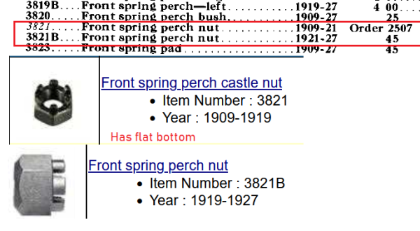

My eyes are telling me that as sitting, the spring perches are both aimed "down" toward the front and if the wishbone was removed from the pan, the springs would unwind and the perches would allow the axle to cant backwards giving more or less correct caster. From the pictures I do not suspect they are in backwards.
A quick check would be to pull 1 nut off of the wishbone - if the machined face on the perch (under the nut) is flat, it's in correctly, if there is a big radius on the hole, it's in backwards as that radius is meant to snug up against a machined radius on the wishbone, at the root of the part that sticks through the perch. If perchance the wishbone and perch were in pristine shape, and the perches were in fact put in backwards, it would be impossible to draw the wishbone up tight to the perch and a small gap would exist where the wishbone radius crashed into the square perch ID.
I don't own a print on the early wishbones but folks who I respect all state that the wishbone is made straight and then bent after assembly to get the correct caster. I do know that every "used" early wishbone I've seen is in fact bent, and if that "as bent" wishbone is installed upside down, it would result in exactly what we're seeing on these pictures.

I had the same problem on mine, flipping the wishbone over cured it.
Definitely worth a try.

If you haven't already done so, the first thing to do is place a carpenter's square against the lower spindle bushings as described and shown in the service manual to verify if there is positive, zero or negative caster.
If there is zero or negative caster, then flip the wishbone over as others have described and that alone may cure the problem.

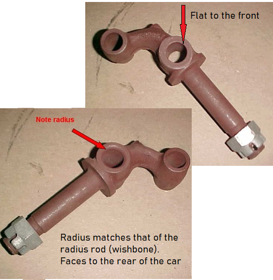

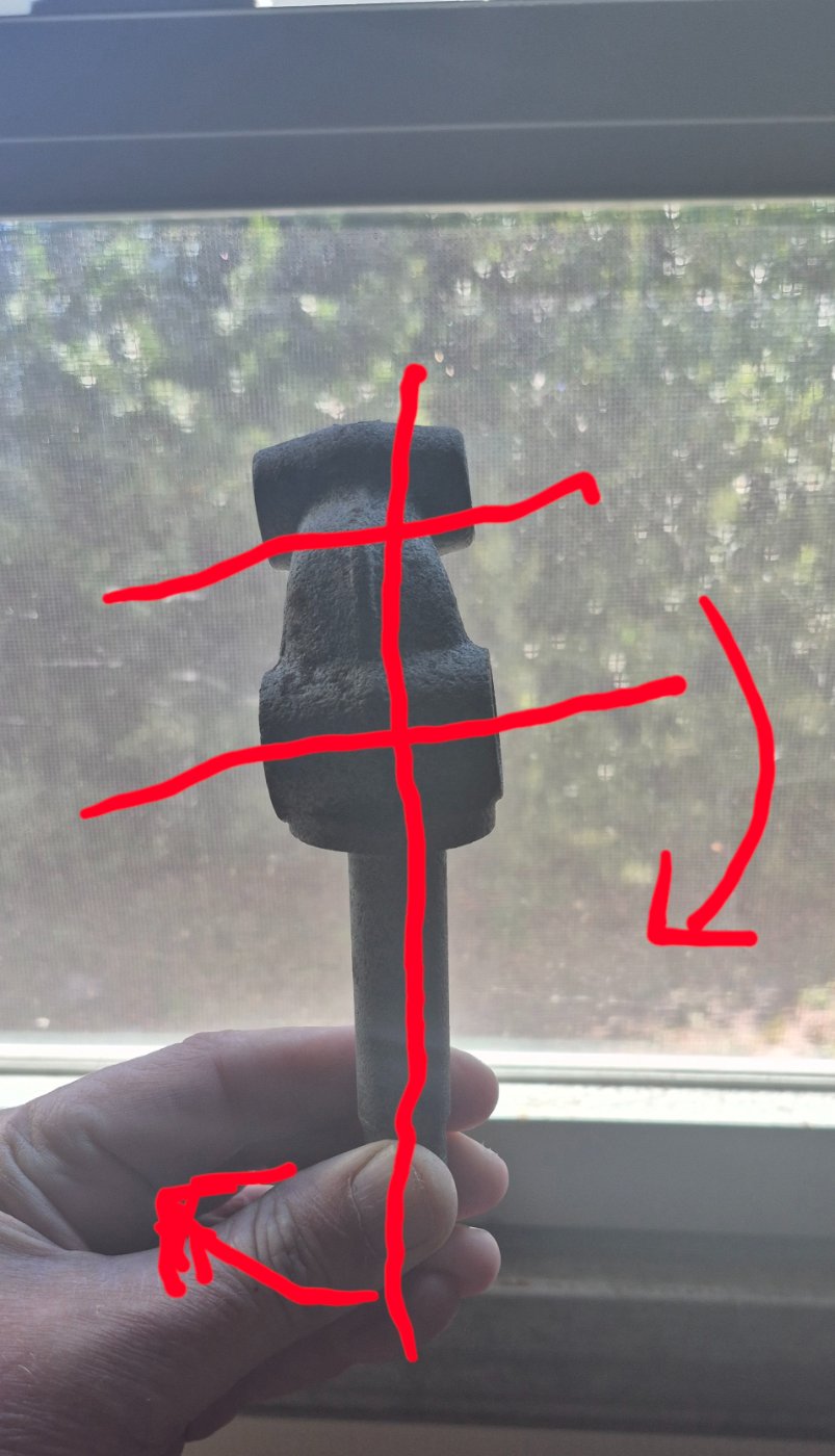

The perches are in correct position per my eye.
With the axle positioned vertically (and therefore the perch pins thru the axle being vertical), then the spring and wishbone mounts would be canted forward as is seen in the pic. With the spring & wishbone mounts horizontal, the perch axle pin and top axle mating face would be canted back to provide caster.
The perches, and axle, are oriented fine from what it appears.
I have never been able to find any early wishbone specs detailing whether the rods were straight, or if they had a bend, and if so, how much. Regardless, in my search for an early wishbone with a good ball, of the 4 I have in my hands, ALL have a very slight curve in the last 6 inches (age/wear?), some greater, some less, but all there, in addition to the pin being angled from the rod. I would therefore agree with others suggestions to try reversing your wishbone first before you do anything with the axle. Other things to check would be the condition of the ball (worn undersize), as well as if the ball socket is seriously/deeply worn and may require repair or shimmed, both of which would also force the axle out of alignment canting forward neutralizing caster.

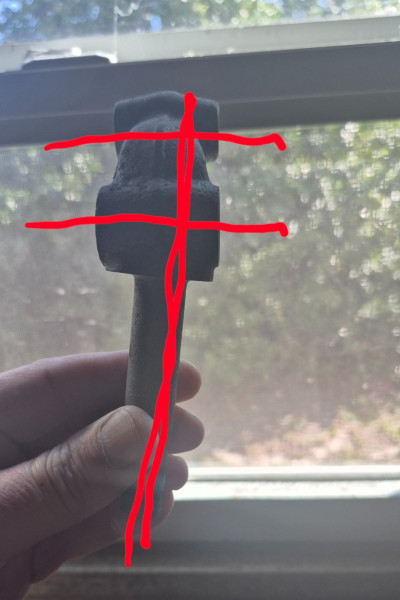

His axle: Reflecting the perch in current position:
Perches mounted as is, but properly canted back: My axle for comparison (both his & my perches in correct position):

It looks to me from the comparison pictures that the 09 axle perch has a slight back twist to it. It’s not much but it is turned to right just a bit to much. Look close and compare the last pics that were posted. It’s canted backward but it’s turned back.

Caster is set by the spring perches, which are angled so that the top of the axle beam is canted to the rear. The caster is maintained by the radius rod. The threaded ends of the forgings at the spring end are set at an angle to the Y of the yoke. If you set those threaded ends on the level, the arms on the yoke will rise considerably.
The geometry can be stuffed up by fitting the perches at the wrong ends of the beam. On later axles without the relief in the end yoke, you simply have to turn the axle around. if the radius rod is fitted upside down, that too will upset the geometry, as will "straightening" the threaded ends of the radius rod.

I don't know, maybe it is just me? Maybe I am wrong? But when I look at the photo looking through the wheel spokes and look at the spring perch? It looks to me like it is the correct perch on the correct end/side of the axle.
The photos aren't giving us a really good view of things. It also appears to me that the axle may be twisted slightly. The photos do not line the ends up well enough to be sure about that, either way.
We really need more and better information to be sure of anything. Is it a real 1909/'10 axle? Does it have the notches for the spindle arms? Are the perches in the proper places or not?
From the little I can see of it here, it appears to be a very nice early T. I would hope it could be driven and seen out and about at least a fair amount.

This axle is from car #22 that was at the Winter Clinic.... The axle angle is exactly the same as a 1912 we are working on. Unfortunately we have not other early car to compare it to. We have removed the axle and are going to remove the perches and try a different set of perches. We do not know if that will make a lot of difference, but it is the only way we will know. The '12 does drive a bit squirrelly and the axle is almost vertical when holding a square up to it. Next work day in a week.

Re: Vertical front axle 1909
It's quite common for T's to hit stuff, pushing the wishbone mount back.
Is it possible & have you checked the Crank case wishbone mount location?
Check EVERY possible thing before acting.
Adding a second wishbone??
The suggestion blows my mind for a '09.
You are caretakers of the holy grail of model T's

Experts on the first 2500 will be able to tell is how early in 1908 they began to be built. The model introduction was in October of 1908, Ford presented them as the new 1909 model cars.
Get a horse !
- Posts: 5297
I am no expert. What I see from very limited pictures is a wishbone pulling the axle out of spec.
I think disconnecting from the pan & a little moving may show the axle re-aligns itself.
Could a 09 wishbone be different from later? Could this one be a replacement, improperly installed or incorrectly restored?
I would be consulting an expert. Kim Dobbins, Pete Eastwood or another well regarded early T man.
It's a measure twice & cut once situation for such a precious model T.

Can't one just ID if the two hole perches are on the correct side by removing the wishbone nuts and looking to see if the hole has a radius or is flat.
Simple check.
Also to check if the correct nut is used - may have been mistakenly used when perches on wrong side because of the radius.
Simple check.

Just wanted to share my research on the early axle beam. The first drawing for T-202 states clearly: “same as N-202”. This refers to the later nrs axle beams with removable spring perches. The “clearance notch” was added a couple months into calendar year 1909 and was removed later the same year. (Per factory release records) However i have observed both an original 1910 car and a period photo that have the clearance notch facing forward. I presume these were examples of old stock being used up so turning the notch forward disabled it. The original car i saw had the original pinstriping still showing so it was not a case of the axle being removed and turned around after manufacture. The caster angle of 5.5 degrees is set by the spring perch as stated above. The factory clearance notch was ground in a wide sweeping arch. I have seen other clearance notches which appear to be a sharp and narrow groove. The second type might be non-factory modifications or supplier variants. I have driven cars with zero and negative caster and they are very unpredictable in steering. To do this job right the perches have to come out so guide pins can be placed in the perch holes and kingpin holes to check the beam for straightness. They often became bent in service.

Remember the pictures above are from the '09.
We are working on a 12 that appears to have the same problem. I have now been told
that the axle on the 12 is a 26 axle. Experts more knowledgeable than me have determined this.
We found some perches at the swap meet in McPherson and will determine what we need to do
to correct the issue. The wishbone is not the same on both sides so we may replace that.
We will wait until the cold comes and goes. -16 degrees tomorrow night.
