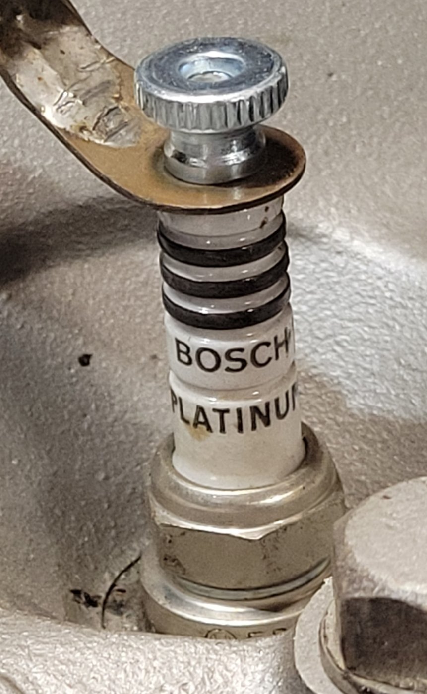

I run Bosch Platinum 4003. FR9HP
Whatever you use, make sure the top unscrews.
I replaced the original nuts with some period-ish looking thumb nuts.
Keith
