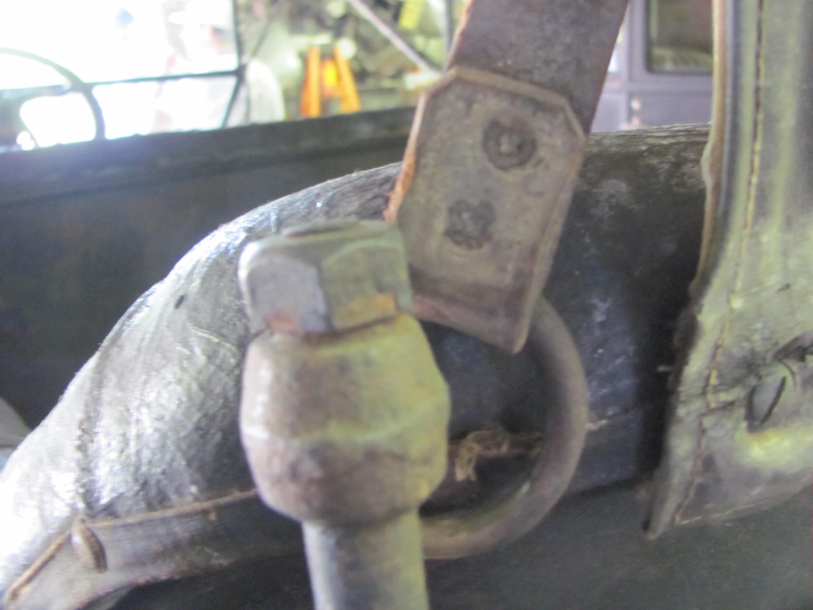

On the Top Support Irons that bolt to the Seat and support the Top Irons where the top pivots, how does the interior Upholstery wrap around this Support? Was it hand-stitched underneath, or ?? We are specifically working on a 1914 Touring, but any of the early open cars will likely be the same. Any pix??
TIA!!
Posts: 4059
Re: Top Support Iron Question regarding Seat Upholstery wrapping.
Post by DanTreace » Tue Feb 03, 2026 2:38 pm

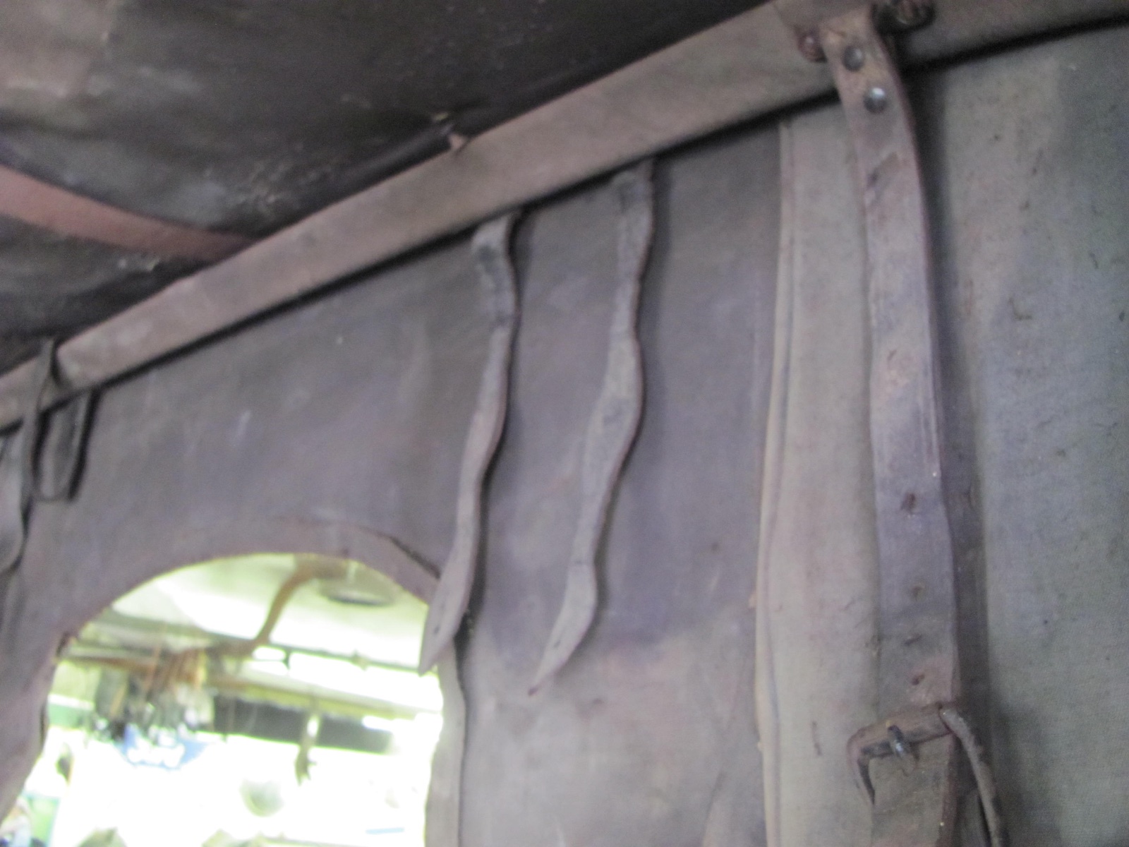

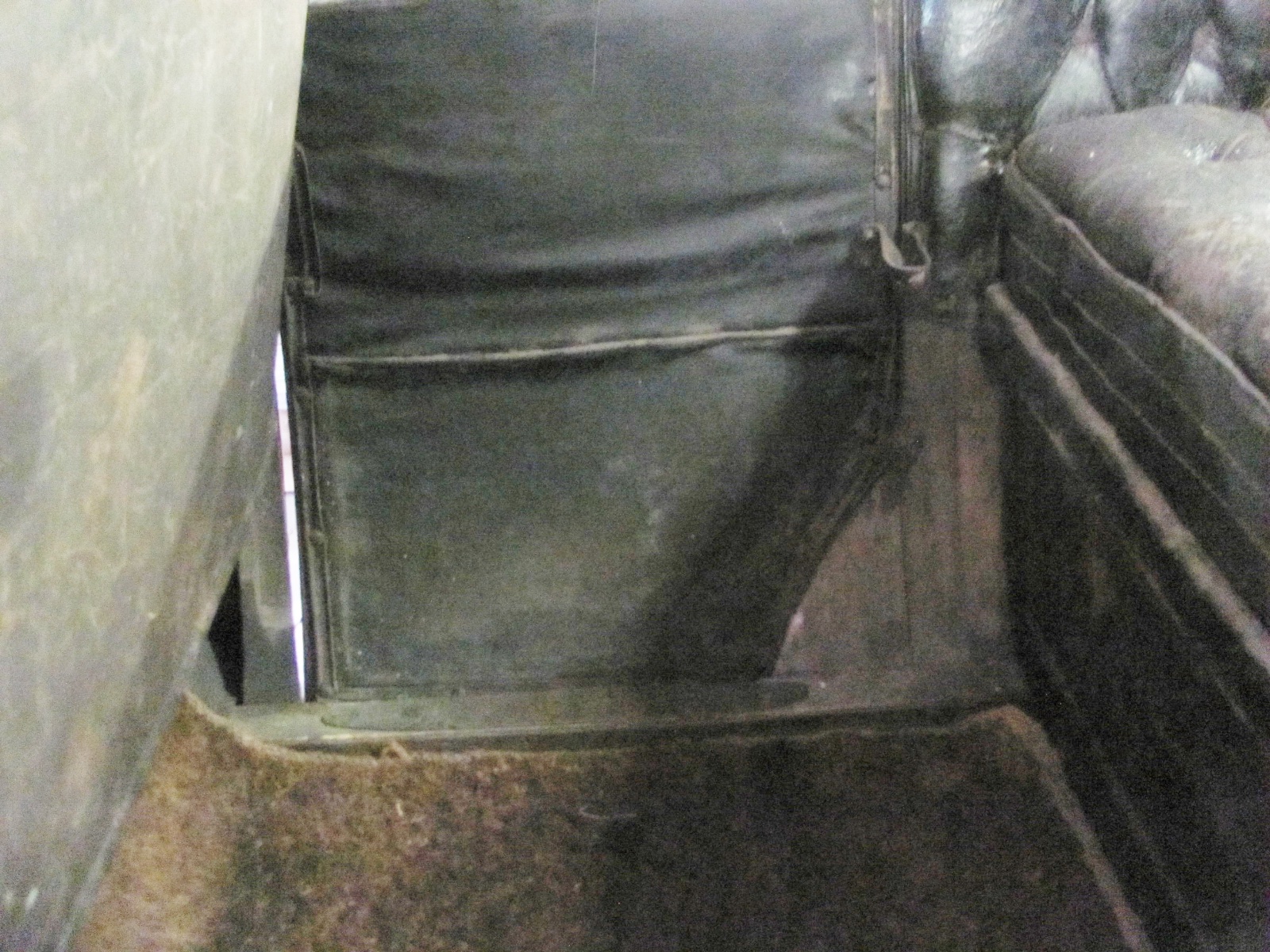

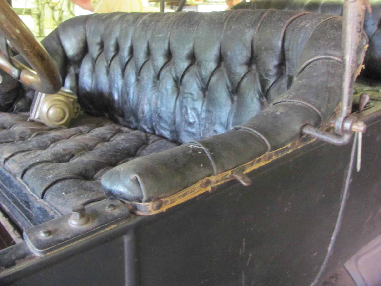

An original 1914 showing off factory ways of top and upholstery.
