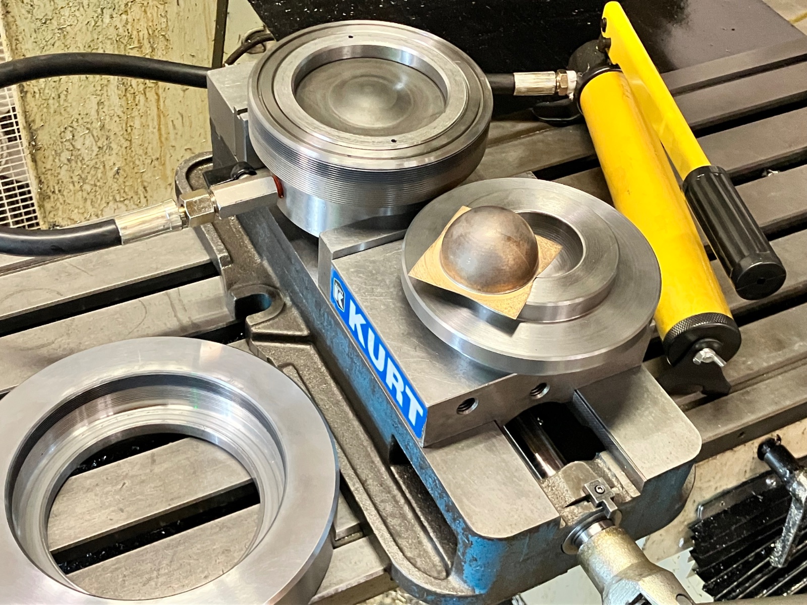

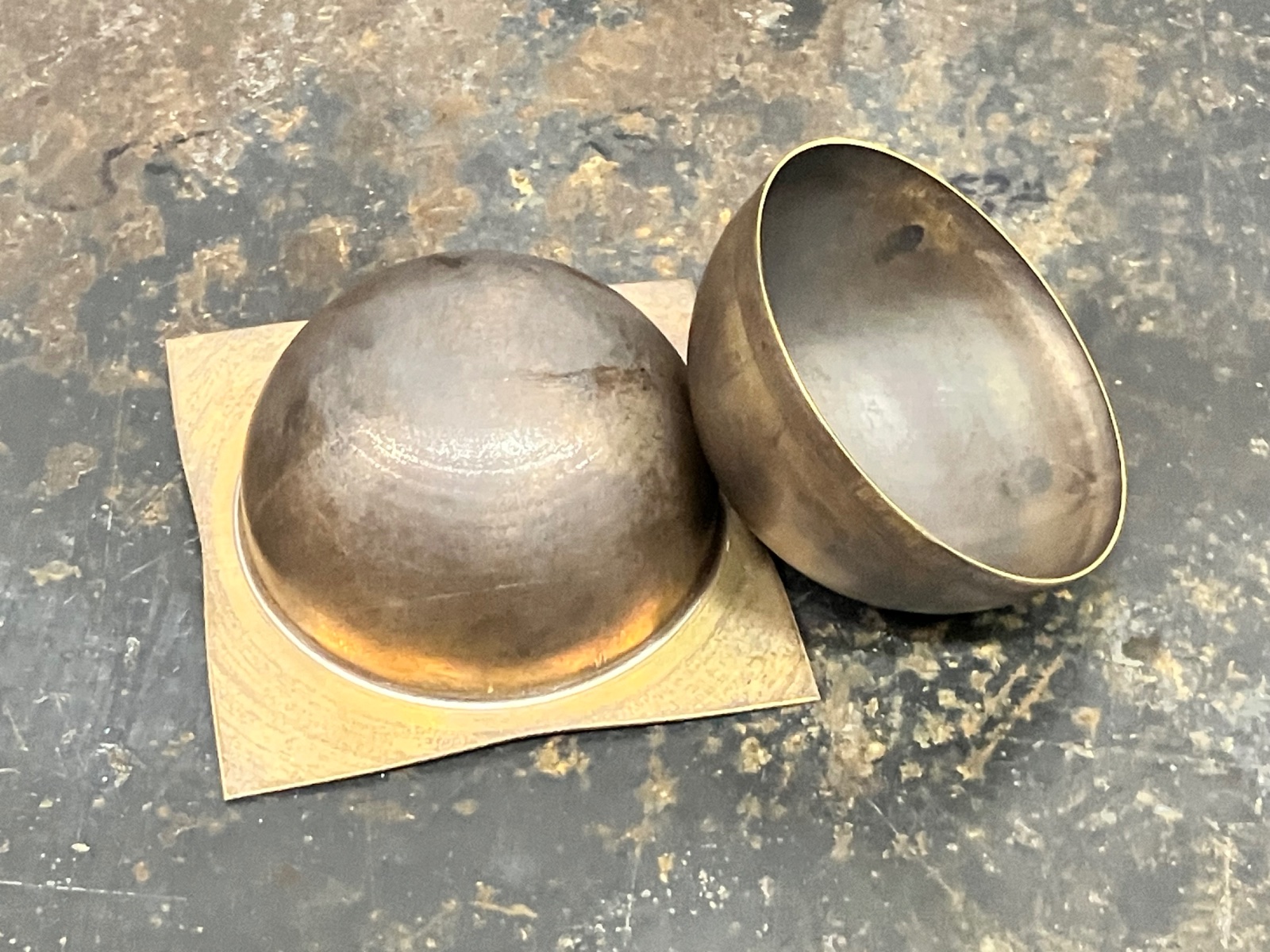

In this hobby, production quality tooling is almost always cost prohibitive. Even if you did invest in the tooling, minimum production quantities often produce more parts than you can hope to distribute. However, there are a number of modern prototyping technologies that can produce small production runs without permanent tooling investments. Sure, price per part is high, but no different than distributing high value tooling costs over a single production run.
Might consider hydro-forming. Here is a pic of my setup designed around carb floats. It’s home made and takes a little elbow grease to operate, but delivers top quality parts. The single die can have all shapes and features of the part, even undercuts. It’s not quick, but it’s paid for, and delivers small quantities with no hassles.
