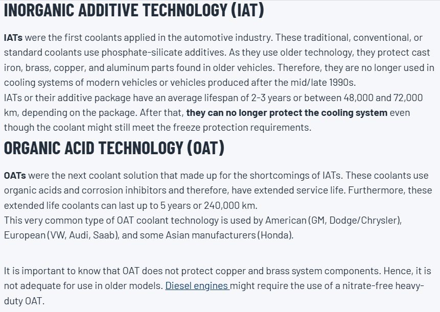

No, I would not, do not, do not recommend using it.
Use only coolants that are labeled for older vehicles and these are IAT coolants.
The old school green stuff.
Don't trust me, trust what the manufacturers say:

Noel
if you read what Mike posted, the green coolant protects cast iron, brass, copper and aluminum from corrosion. Not mentioned, but importantly, it protects the lead solder from being attacked as well.
the newer OAT specifically does NOT protect brass or copper from corrosion and the lead solder will definitely be attacked.
I think that in itself should answer your question.
Folks can play games with other coolants like OAT and Universal Coolants (Hybrid OAT) but at $1600 a pop, my radiator is going to get (green) coolant that was designed to protect it. I also know that corrosion protection ceases after 2-3 years, so it gets replaced periodically.

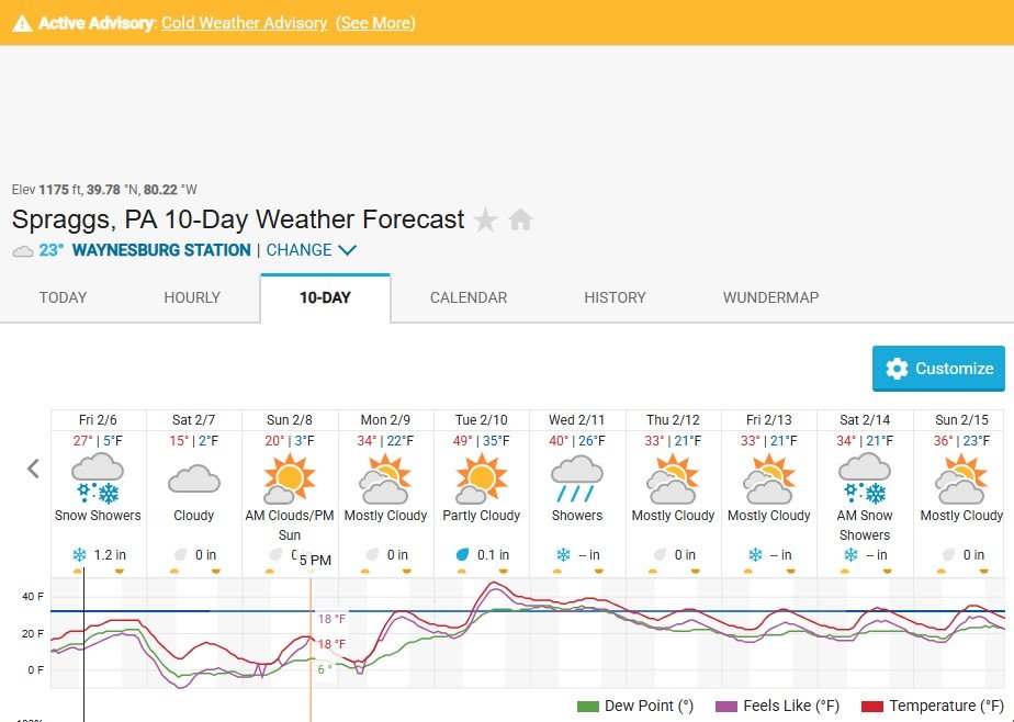

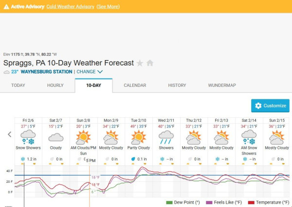

Given his location listed I sure hope he uses something of antifreeze or protects the car.
You can use a water / AntiRust and keep it in a heated garage or drain it, I have in the past.
But then I started parking them in different places. Some temperature protected and some not so I swapped them all to antifreeze.
