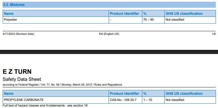

Mfg. stated 2 year shelf life in recommended storage conditions, esp for aviation uses. The oils can separate, but can be mixed back. Material is PROPYLENE CARBONATE

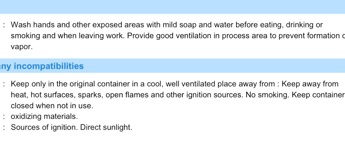

Mfg. Safety Data sheet on storage.

It might separate over long storage times and just need mixing.
The Polyester might break down but really slowly

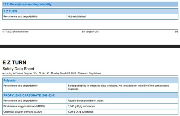

The solvent - Propylene Carbonate is biodegradable so the carrier will eventually "rot"
