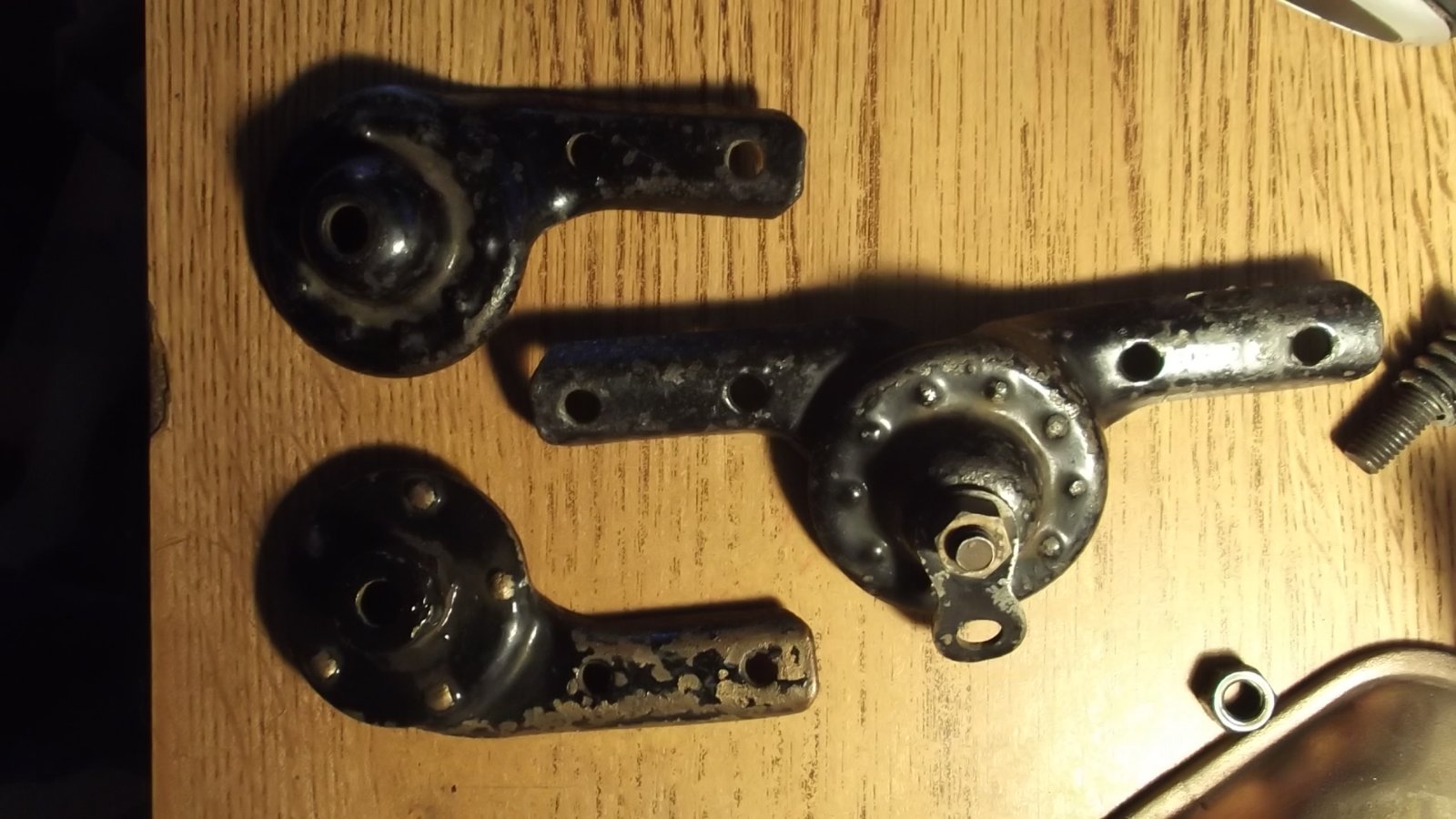

Topic author - Posts: 5510
Re: 15-17 even length hinges
Thank you Wayne. Looks like I have two drivers side hinges. (or passenger side, I will have to look again) One of the 4 hinge pieces is a bronze casting.
Wayne;
Thanks again. I went out and looked at my 21. Looks like I have two pairs of uppers. No offset.
The bronze one is an inner, passenger side. The 18> style had the offset on the lower hinge.

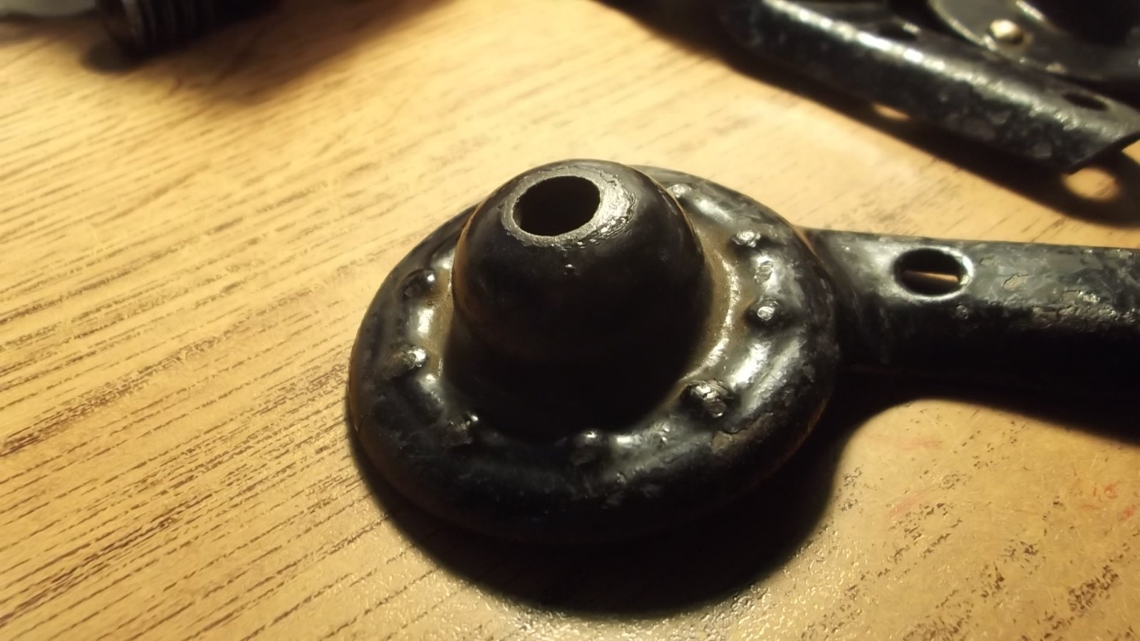

Like this?
Hap_Tucker
- Posts: 403
- First Name: Hap
- Last Name: Tucker
- Location: Sumter, SC

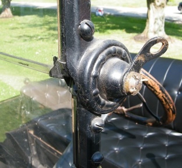

Mark,
Yes, like you are showing -- it has a ridge/raised area. That was shown at the posting: http://www.mtfca.com/discus/messages/506218/525076.html where Royce posted the photo of a 1915 windshield hinge shown below:
Sometimes that is very easy to see in a photo and other times it is in the shadow and not easy to see.
