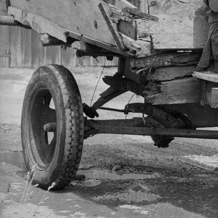

A period solution here was to have disks cut from plate steel, drilled for hub and bolts and installing these in the 20" felloes. Not wood, but 'period correct aftermarket' and never need worry again.
- Posts: 1211
- First Name: Adrian
- Last Name: Whiteman
Re: TT Wheels-Need Re-Spoking
Here is a 'back in the day' picture of steel wheels from another truck that have been fitted:
It may not be 'factory' but is 'period'
That should cut through the muddy roads

Haha, I guess I could do that. Just kidding! I want to keep the original wooden wheel look. Spokes are too far gone to be soaked. Reached out to Dave and I am awaiting a response.
Thanks for your help, Jacob Mangold
