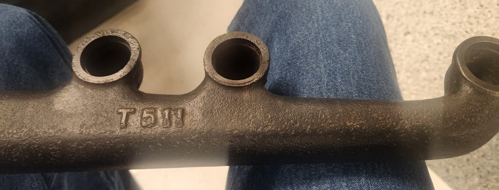

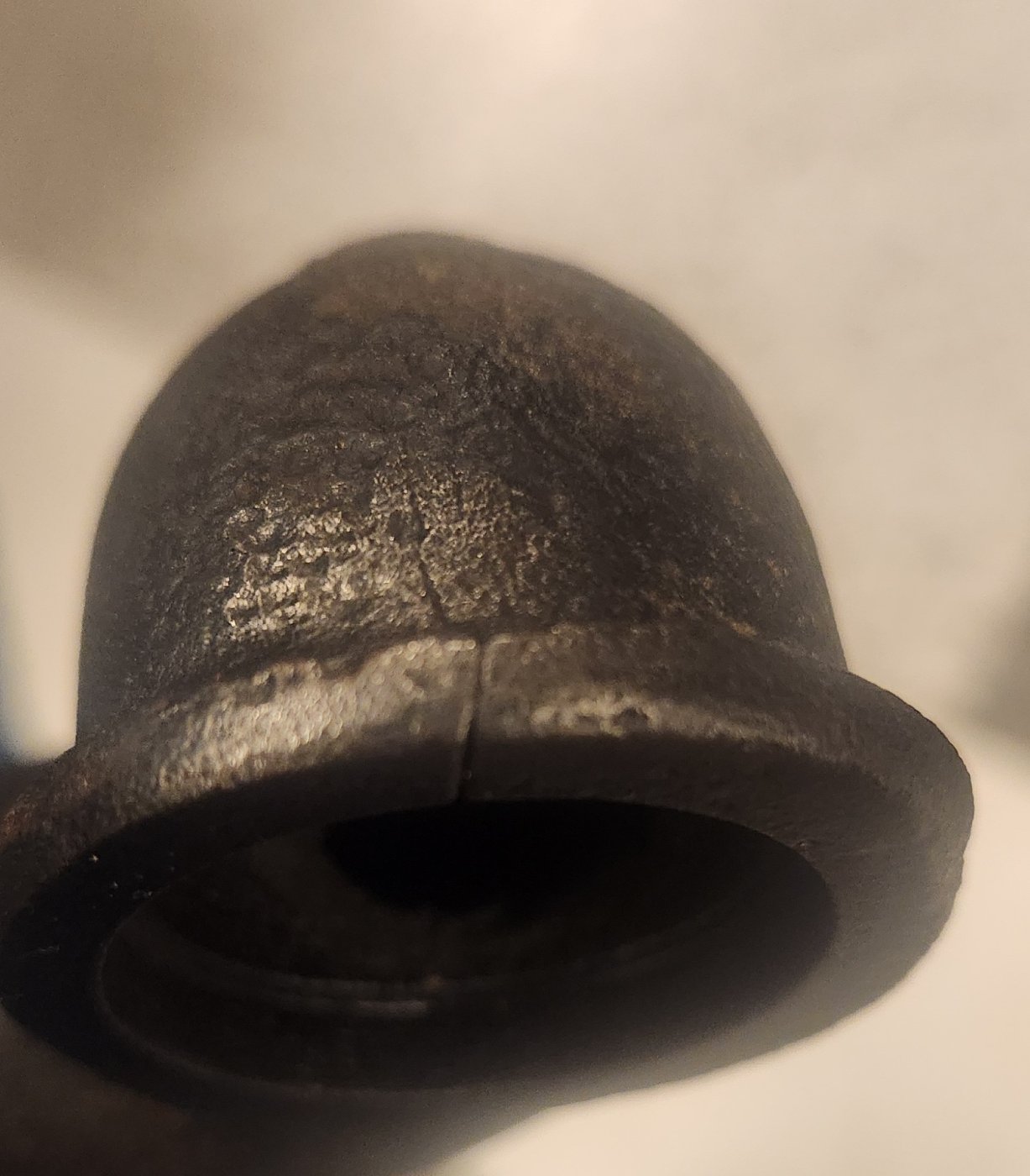

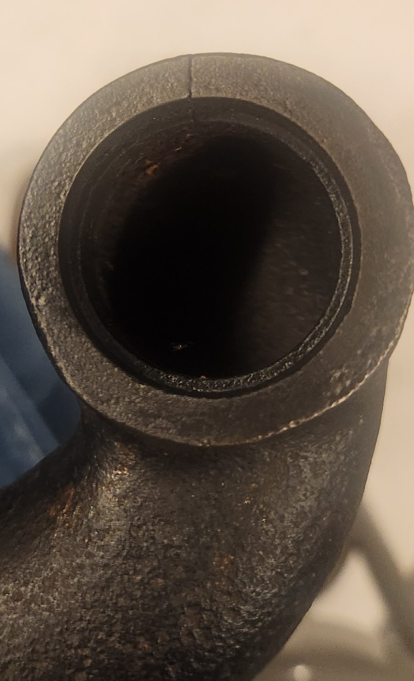

Exhaust Manifold Repair
Can someone give me a recommendation for a person who can repair a small crack in an exhaust manifold port?
This is a 1909 Part T511. Thanks
See pics.[/size][/b]

Hi Danial,
Old castings are hard to weld & it will be noticeable when done. If you have a lathe or a friend with one you might consider making a
long gland ring that will fit in past the end of the crack( trim it down on the bottom so to not restrict the flow of exhaust) Pack the
circumference of the inside of the manifold with refractory puttie ( sometimes sold as a exhaust repair in a tube ) Remove any excess
& install the manifold. Make sure the gland doesn't fit tight so it will not expand & further crack the manifold. That manifold has made
it 116 years it probably won't crack much more in the next 10-20 years.
Craig.
Craig.

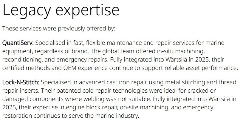

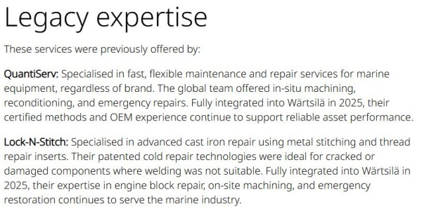

The Lock-N-Stitch closed comment got my attention so I had to look it up.
I used a few for one project and know of several other instances where they have been used.
I really liked the design and engineering behind it.
They are plugs that pull the metal together rather than spread it like a normal tapered plug.
The only thing I did not like was price and availability.
Cast iron gets weird with lots of heat cycles and carbon atmosphere like an exhaust manifold.
It takes a lot of experience to deal with it.
My first thought was a sleeve on the outside to squeeze it rather than inside to spread it.
Back to Loc-N-Stitch
Their web site https://www.wartsila.com/marine/service ... ex-repairs
says they fully merged into Wartsila
They have an office in Houston maybe talk to them about who can do it for you.
I am saddened by the possibility that another resource may be drying up.
Mike

So can I still buy Lock n Stitch products? It keeps sending me to that new company and I don’t see how to get the product like I did before. ?????

Y’all think a piece that old or a manifold like it can be brazed or is it too “fluffy” a metal? Meaning brittle and porous, partially oxidized and really old…. Maybe silicon bronze or brass or stainless rod? Definitely seen parts made of cast steel and cast iron with worse damage than that restored to function. Personally, I would try the tig torch and silicon bronze rod after soaking the manifold in an oven for a while along with a fixture to minimize any warpage. Vintage machinery shops or old tractor restoration experts near you would be a good place to find a guy with this type of experience. Good luck! -Chris, in Boulder.
- Posts: 8603
Re: Exhaust Manifold Repair
It might be best to run the manifold as-is. Repairing iron castings is fast becoming a lost art, and old exhaust manifolds are among the most challenging of cast iron repair jobs. There is, or used to be, a casting repair shop in Kansas that had furnace welding capability. I don't know the name of it or if it's still operating. The antique gas engine and antique tractor people may know of a resource. I've seen some beautiful repairs that were done long ago to broken cast iron machine tool parts using brass or nickel alloy. But exhaust manifolds are a different proposition due to extreme heat cycling in service and deterioration of the metal itself due to the high heat. T-era gasoline often contained sulfur, which probably contributed to damaging the exhaust valves and exhaust manifolds.

You can use a piece of pipe turned down enough, made into a sleeve and tapered just enough to go in far enough to go past the crack. That should seal it enough and save the manifold for a few more years. This wouldn’t be hard to do for a good machinist. Hope this can help you.

The part in question has a good chance of being repaired and for a purist this is important for a very early T. The good thing the T manifolds are being reproduced but a little different in appearance than the very early ones and the reproduced exhaust pipe will need to be used with it according to Lang’s. That being said that may not be a good thing for a purist that has a very early T.
The ceramic sealers that are mentioned may be a solution for the repair instead of using heat to repair it.
The old trick of stopping the crack ahead of the crack has been around many years to stop a crack will work.
Years ago my brother-in -law bought a 38 Case Tractor really cheap that had a 3” crack in it leading up one of the exhaust clamp studs. He repaired the crack using a brass rod and flux using Oxy-Acet. It was still holding when he sold it. That’s the old time method of repairing cracked cast iron. But he didn’t have a 09 T either.

Cast iron can be spray-welded. The part is cleaned, prepared, heated, then powdered iron is sprayed on it within a flame. This builds up new iron that is fused to the original.

The manifold in question is not warped. Thanks, hoping to find a good repair man for this as they are hard to find.

Let us know what repair method you choose. I still like Terry Woods' suggestion.
Mark Anderson
- Posts: 34
- Joined: Fri Jan 18, 2019 3:30 pm
- Last Name: Anderson
- Location: Stratford Iowa
Since 2022 Midwest Cylinder Head no longer welds cast iron. They are only a machine shop for rebuilding engines.
- Posts: 5510
- Last Name: Hatch
- Location: Alabama
Does this take the straight pipe with no flange? If so I may know where one is. Dan
- Posts: 5615
- First Name: Henry
- Last Name: Lee
I personally would not use either a lock stitch (as it is a wedge shape lock and differences in expansion rate of metals), the other is welding old thin cast iron. A better method is to use #6 or #8 X 32TPI brass machine screws very close over lap like a lock stitch and sand off smooth, You can paint with 2000 degree paint and no one will ever know.. The expansion of soft brass against cast iron is a perfect choice. I have done this many times to old engine valve seats with zero failures.
All Good!
All Good!
- Posts: 8603
If it will work on Ford V8 valve seats, it ought to work on anything!
