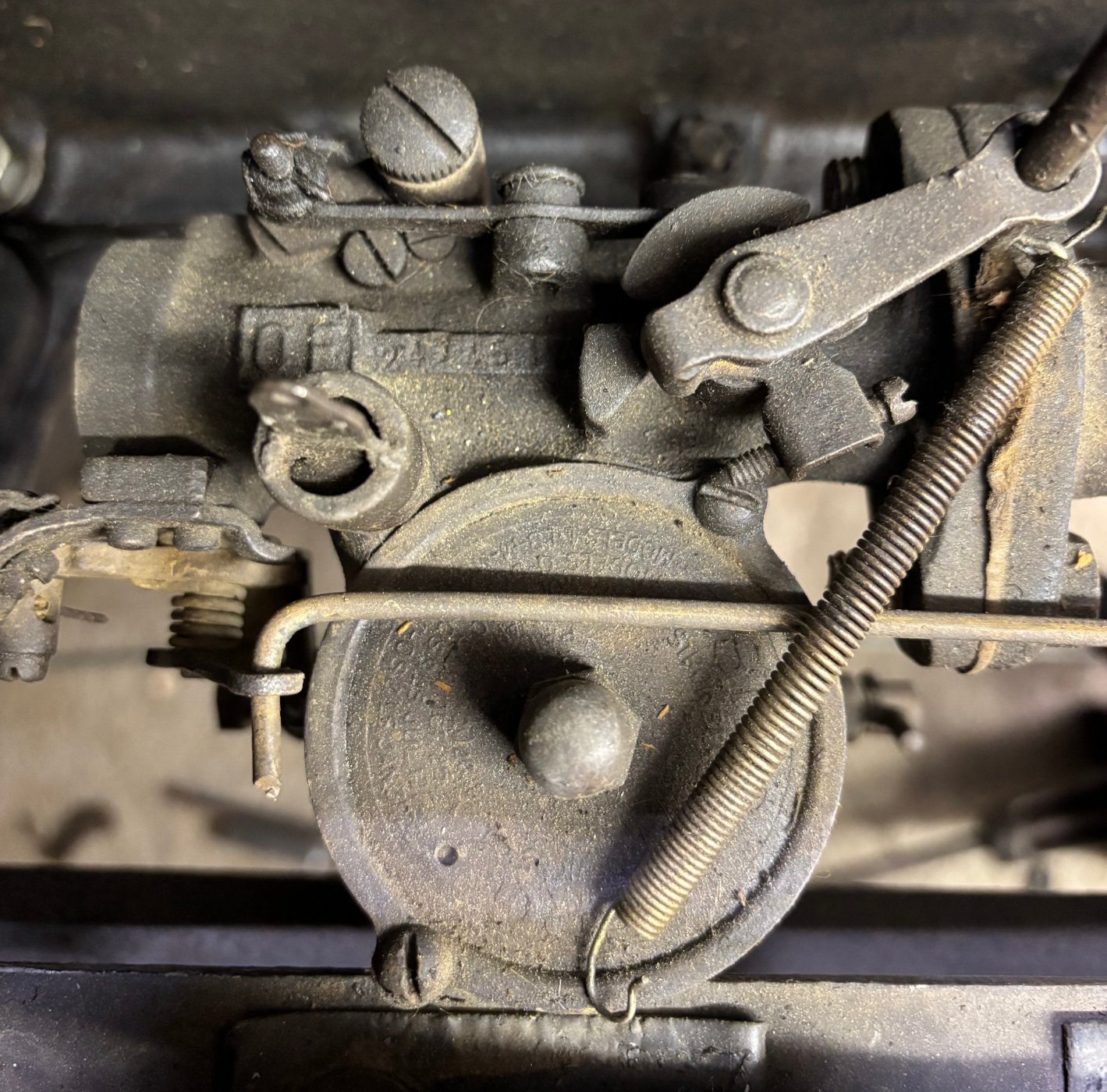

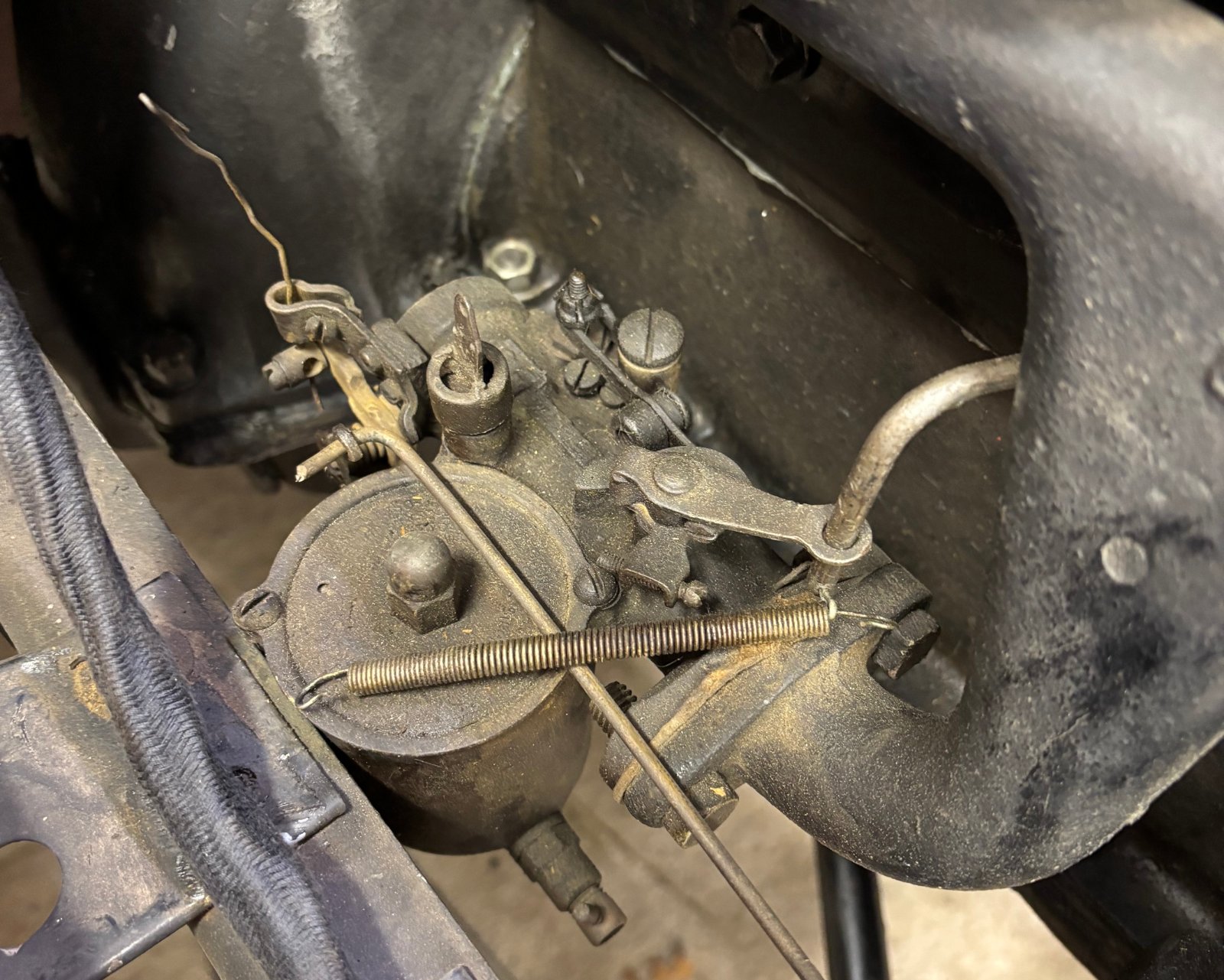

#2) The carburetor doesn't look like any of the model T carburetors in the books or on the websites. I asked ChatGPT what it was and it told me it was a Carter downdraft :lol: . So much for that AI stuff. Does anyone know what this carburetor is?
Thanks in advance for any help, pointers, or tips.

OF is a Stromberg Carburetor. A common replacement for a Holley.

And that Stromberg OF carburetor is a good running (very popular) carburetor if it is in good condition.
